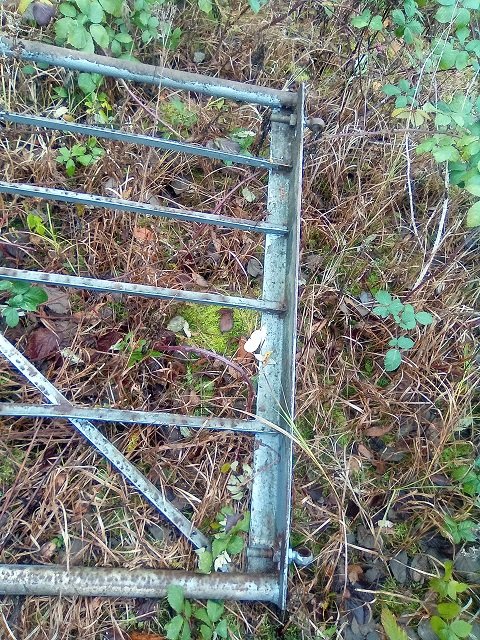

Have a 12' gate with ring ends bolted onto it. (please see photo)
What do I need to attached on to that to make the gate swing and to be able to attach to a concreet wall please

Hinges.
Variety of styles.
A good tip is to put three greased large stainless washers over the pin before lifting the gate on. They prevent wear and squeaking, and prevent the galvanising or paint being rubbed off.
Is your concrete wall strong enough to cope with the weight of a 12foot gate and the leverage of some kid riding on it as it opens?
If it is for fixing above plate to your wall, I would suggest some long threaded bar, resin fixed, deep into your concrete wall.

Will there be foundations and will the drum of concrete be connected to these foundations (ie rebar?)
Asking as the levereage of a 12' gate can move a lot of weight.
It is likely that your gate will easily move a free standing 45gallon drum of concrete.
No foundations as there is no digging allowed
I hope the concrete mold from a 45 gallon drum will be enough to take the weight without it topping over
