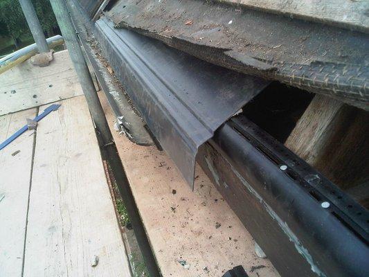

I am missing the tilting fillet on my garage roof, I'm thinking of re-roofing, would I still have to install a tilting fillet if I installed felt support trays :?:
Wouldn't the felt support tray bridge the gap where the tilting fillet should be :?:
Cheers,
Can you nail these on to the roof truss ?
What would be sufficient overlap when installing ?
I nail them to the rafters, they sometimes split if its cold so you may need to make a hole, I overlap them about a foot if its a steep roof then you can go down to 6".
