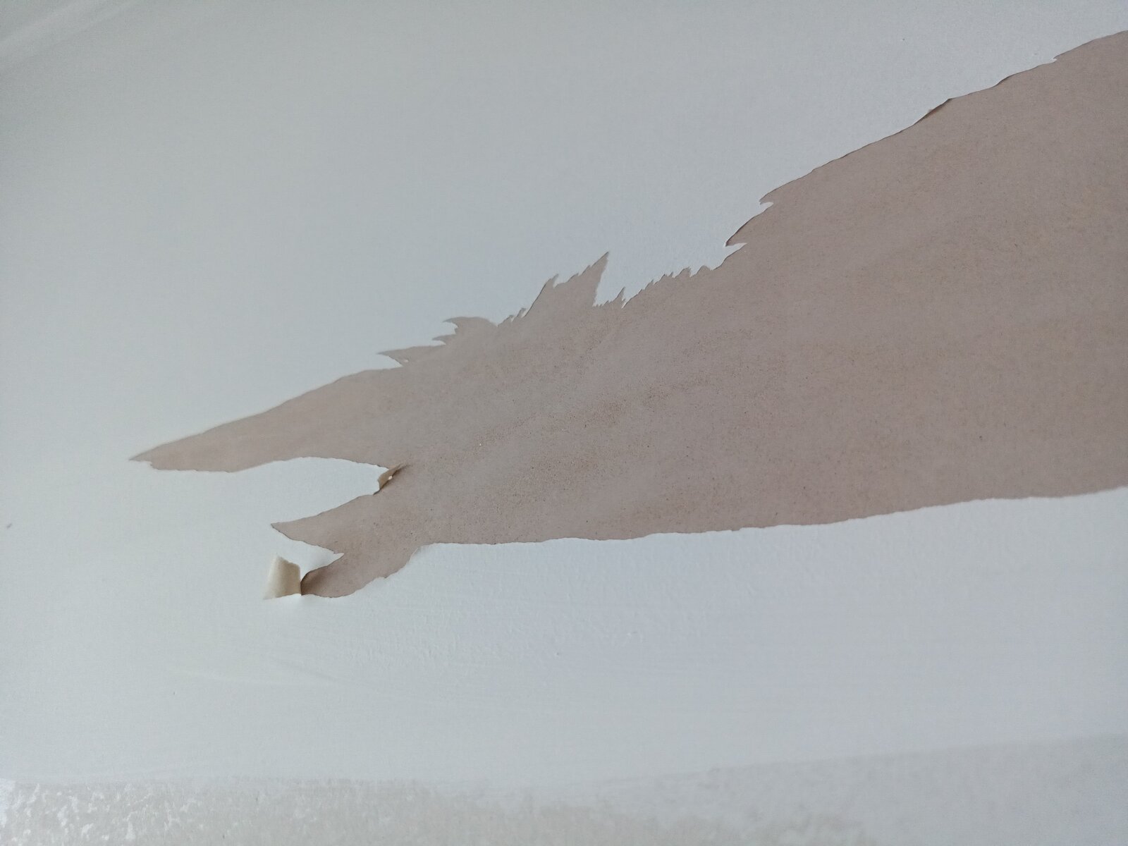

What's my best strategy for going forward? Newly plastered walls, left 4 weeks to dry. Applied a mist cost, but probably far too thick, around 25% water dilution of a white emulsion.
I was trying to tape the top of the walls on my second coat for a sharp border where the picture rail would be, but the making tape ripped entire sections of cost +mist clean off the plaster.
If I rub the edges with my fingers, the paint just rolls up and keeps coming off.
Where do I go from here? How do I fix this?
Sanding, new mist coat and bending it in, hoping the paint in the rest of the room has enough adhesion not to come off on its own?

Did you sand the plaster before painting?
I wrote a thread a few years ago with different tests done on new plaster.
The best results were obtained by rubbing plaster with sanding pad (medium grit, grey if i'm not mistaken) and mist coat with dulux diluted at manufacturer recommendation (i think 25%)
No, I didn't. The plasterer just said to treat with a mist coat.
I'm thinking to sand down and feather/blend it in. I won't be able to use take to create top white band above the main wall colour, but that's a problem for another day.
Would that work? What grits would you recommend? Sand by hand with a foam pad or every so lightly with my Mirca RO?

Dilution was 25% not 10%
