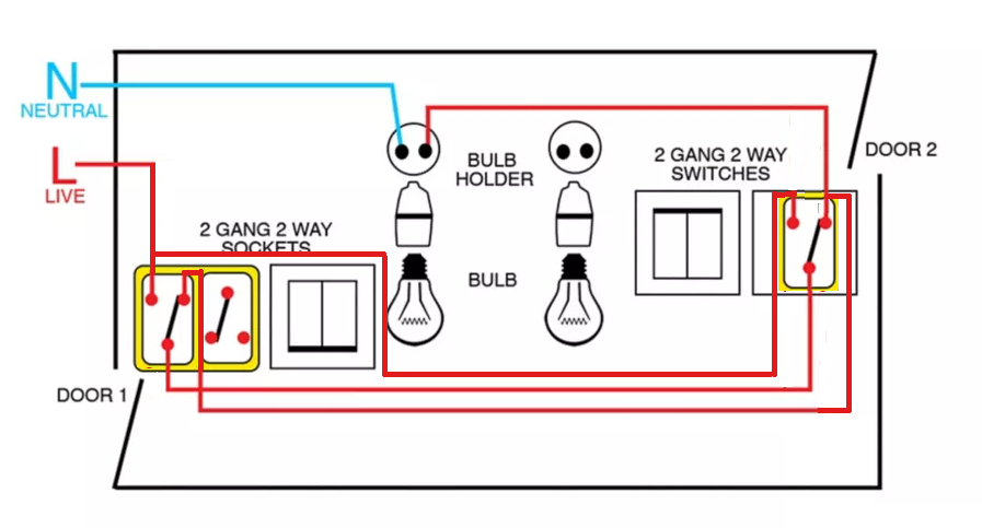

Miswired light switch
It is a bit odd that it seems to ne wired in FP200 cable....thats usually used for fire alarms or emergency lighting maybe.
The switch is for two sets of bulbs in the kitchen. There is fire alarm in the hallway outside the kitchen.
