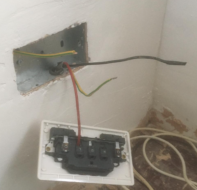

My house seems to have a mix of 4mm cable for the ring mains. It is a 1930's house but I am thinking the electrics are maybe 1970's/80's?
Now last week I switch a single to double socket downstairs and the T&E looked like (4mm?) Copper Clad (I am no expert but it was stranded and silver looking.) Only one photo showing the socket and the copper clad earth (note ignore the copper used to ground the backbox that was new).

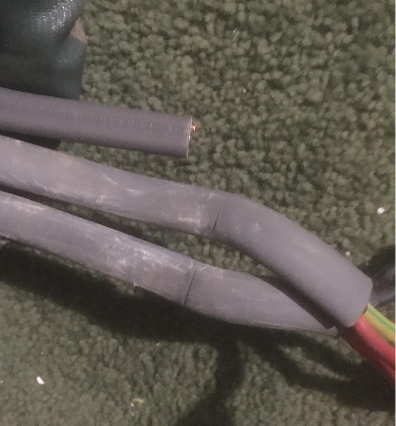

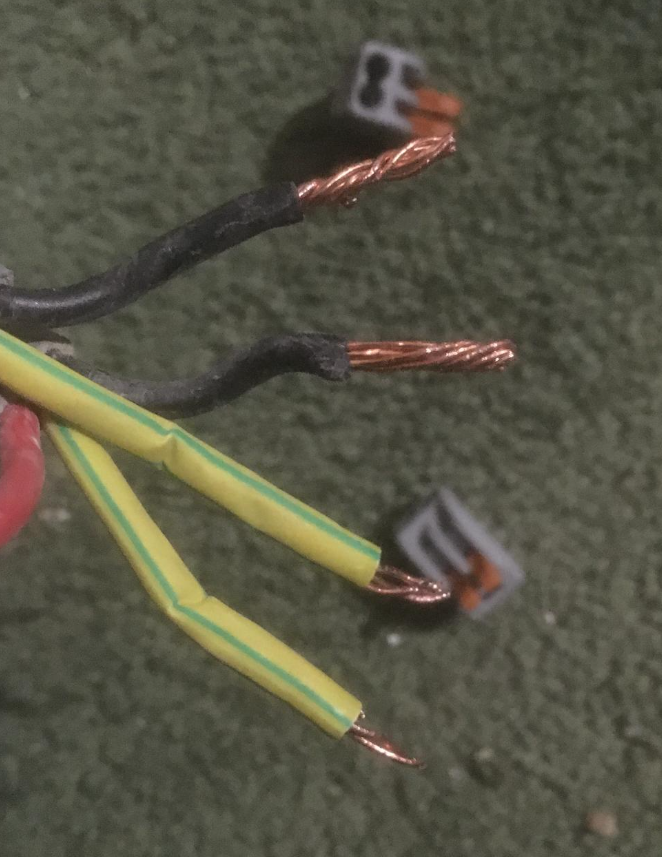

Now I am upstairs and again have (4mm?) T&E BUT it is (4mm?) stranded copper. Two photos of this showing the copper and the cable size compared to 2.5mm T&E.
So I am looking to extend the ring main in the bedroom and have 2.5mm T&E solid core, Wago 222's and Wago 41A Junction Box. Now my question is am I ok with the 2.5mm T&E?

I haven't heard of "copper clad aluminium" or "copper clad steel" being used for mains wiring in the UK (you often see it for cheap and nasty data cabling). Aluminium was briefly used but afaict it was normally solid cores and unclad.
Your stranded silver coloured cables are probablly tinned copper. Historically tinned copper was used to make cables, and I suspect that is what the "silvery" stranded cable you are dealing with is. My understanding is that the tinned copper helped prevent the cores from corroding with certain insulating materials and that after better insulating materials it took a while to fall out of favour.
It looks to be 2.5mm imperial old twin and earth.
There is no such thing as "2.5mm imperial old twin and earth". Imperial cable came in imperial sizes which were given as the number of strands, and the diameter of each strand in inches. Given that the OP's cable looks slightly bigger than 2.5mm² I suspect it's 7/.029 which has a CSA of 2.983²mm
No reason not to keep using it, but you need to be aware of the larger size and plan accordingly.
Not the best choice, I haven't personally tried putting "7/.029" in a wago 222, but it's larger than the advertised capacity and I remember even regular 2.5mm² being a pretty close fit with little room left over. It would not surprise me if it simply doesn't fit.
221-4xx series terminals on the other hand can accommodate up to 4mm² so they should handle "7/.029" fine. Unfortunately if you want to preserve the "maintinance free" status of the box while switching to 221-4 series terminals, you will need to either buy the adapter plates or buy the "wagobox 221-4" which is specifically designed for those terminals.

During the copper shortage, they used next size up, aluminium cables. Some of which was copper coated aluminium. If you mean silver on the outside, then that will be tinned copper, probably 7/.029 - 7 stands of 0.029 thousands of an inch diameter, which was the standard used for a 30amp ring main circuit, at the time.
Thanks for the feedback everyone, interesting stuff. So it sounds like my plan still stands to extend the ring using 2.5mm T&E in the bedroom. The Wago box and connector do fit the old cable as I have used them to make safe the ring in the bedroom while I plaster the wall.
