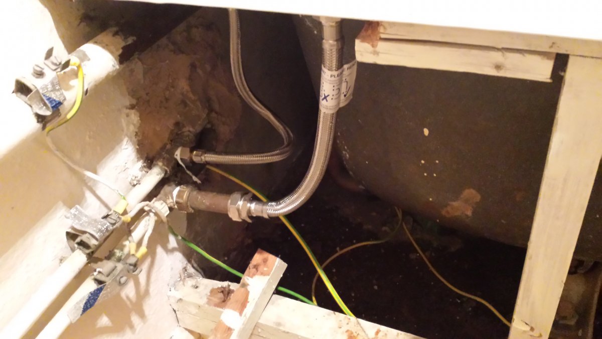

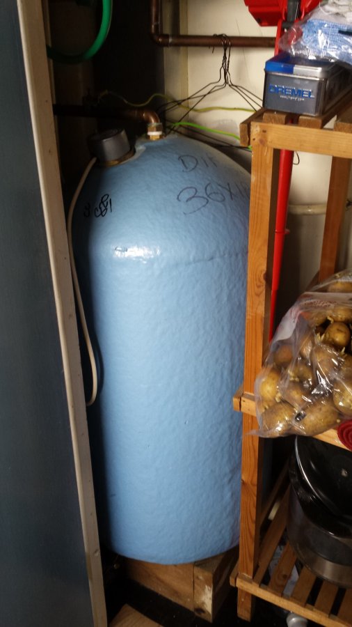

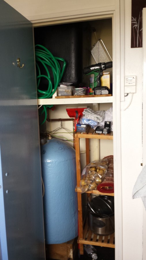

The tenant currently has a bath mixer tap in a flat 11 floors up.

You need to find where the cold is coming from - if its mains ( same as kitchen sink) or if its a roof tank on floor x?
