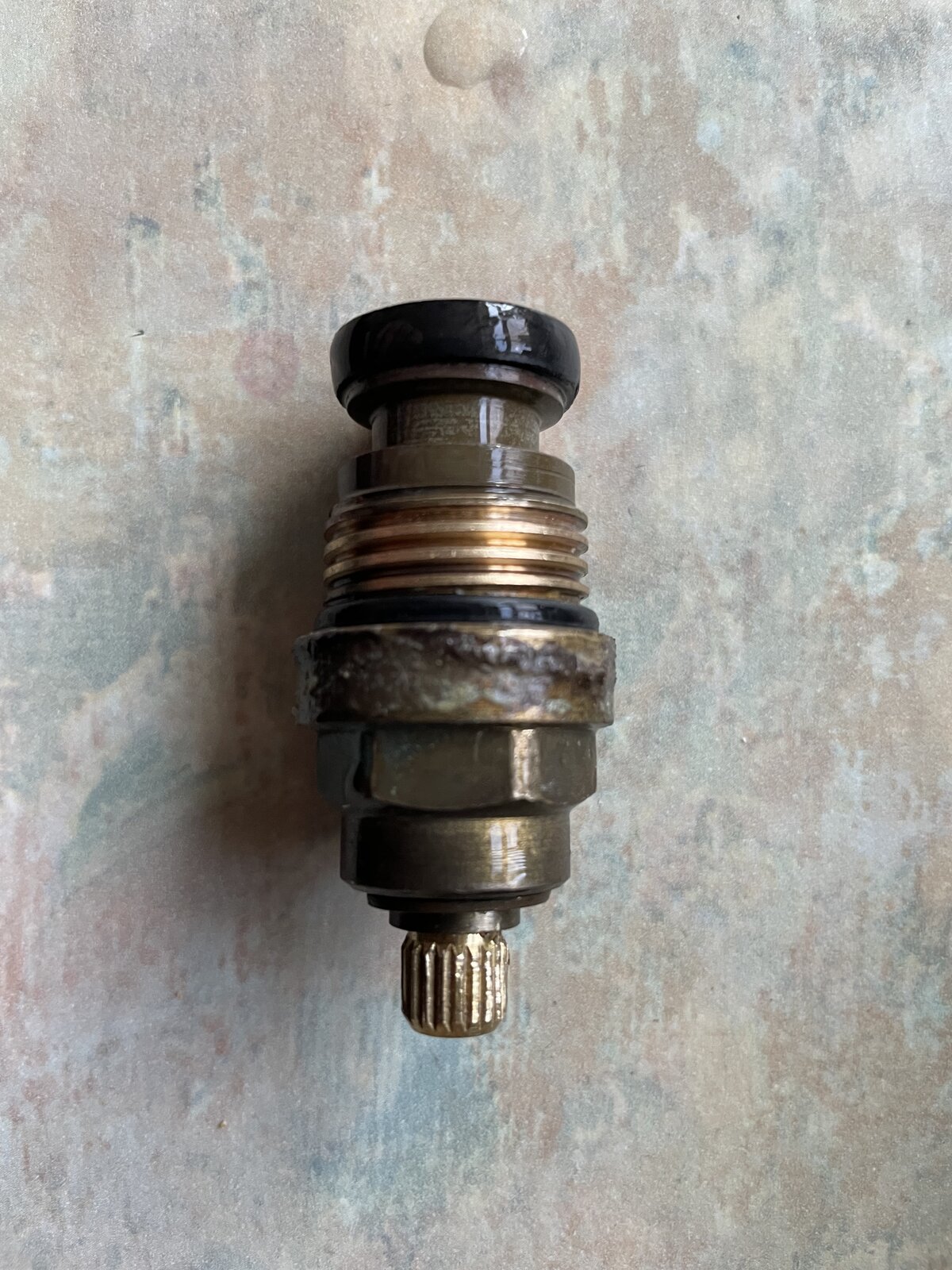

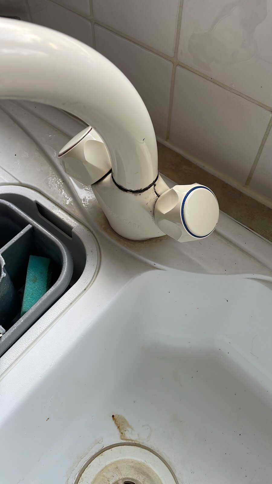

I noticed that the cold tap was getting tight and not opening up fully. Now it’s hardly opening and no water is coming out. The hot is fine.
The tap is a Deva DCP124-004.

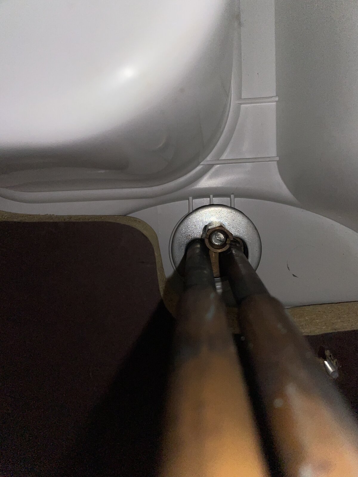

I was thinking of replacing the tap but I see that there isn’t any flexi hoses being used, just copper pipe.
Can the cartridge (think that’s the right word) be replaced?

Any idea what and where I can get this part?
Quite a few sheds or merchants. You can go the online route, but tap splines need to be accurate, unless you just want the washer and lubricant?
And post a plumber to redo the pipes? Seems excessive.
Struggling to find the reviver kit..
