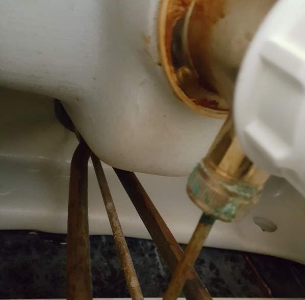

…so had a look underneath.

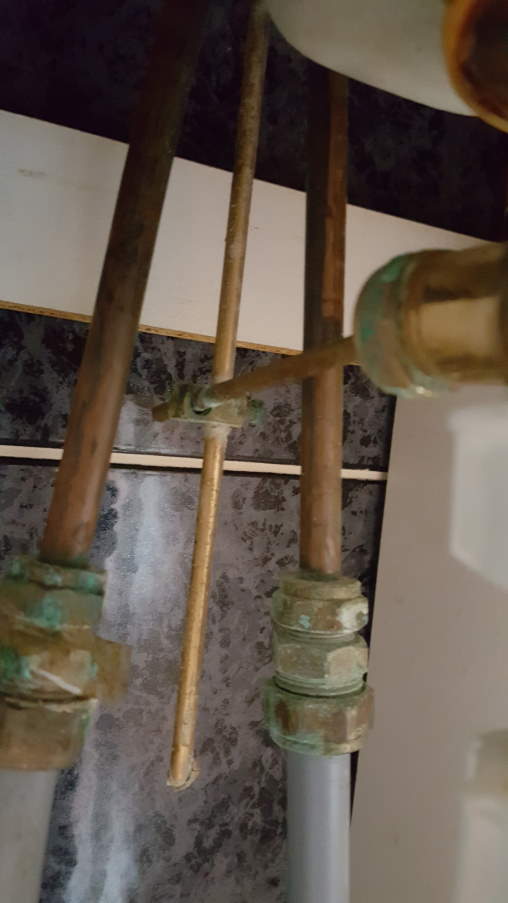

What do you think of this mess? If I buy a new mixer unit, is it likely to have little thin pipes attached like this one? I thought they all had the same ½” fitting?

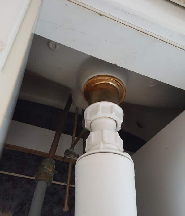

Note that the ½” pipes, lower down, are covered in solder like the inlet for the toilet was…
I’d kind of imagined just putting a new mixer in the hole, attaching a 300mm flexible pipe, cutting the lower copper pipes, and doing up the compression joints…
Oh, and of course that rising/falling waste thing… should that be a simple replacement for the one I have already?

Most Monoblock taps will have the smaller (10mm or 12mm) flexible tails and a fitting to adapt to 15mm (½") on the end.
I would advise changing the waste for a spring loaded pop up or pivoting type so you don't have to faff around with a linkage like you have now.

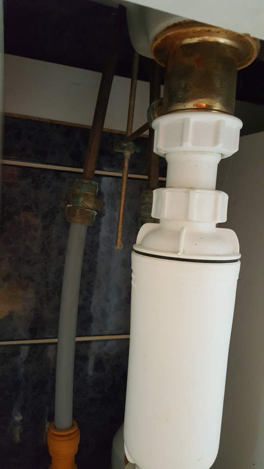

After the linkage is disconnected wedge something in the plug hole web and get a pair of grips on the under side top gold bit screws out of the underneath bit.
Put one of these in it's place.
https://www.screwfix.com/p/sprung-basin-waste-slotted/41691
Your trap looks like it is adjustable so that should fit.
Only things to watch out for is the washer on the trap is undamaged, you can get spares (1¼") and sealing the new trap can be a pain as basins are not always uniform one of these is worth getting.
https://www.screwfix.com/p/thomas-dudley-ltd-basin-waste-seal-kit-3-piece-set/8795r
If all else fails plumbers mait or silicone will sort it!(y)
It'll be part of the new waste: you get the plug and the hole!

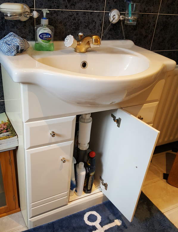

Having had a good feel around in the dark, I think this one is going to be (yet another) struggle for me. Problem is that the nut which secures the existing tap in place is away up in the narrow recess under the back of the sink. If I stick my fingers up there, I can barely feel it.
Realistically, I don’t think I’m ever going to get any kind of spanner up in there to undo it, especially with the narrow bore pipes from the mixer in the way. I’m guessing that the original installation was done with the cupboard unit lying on its back on a bench, then fitted into place with taps and waste already in place.
So it looks like either remove the whole sink and cupboard unit (if I can without damage), change the taps etc, then fit it back; or scrap the whole unit, sink, taps, the lot, and install new ones. Which then of course won’t match the rest of the bathroom.
What would you do… answers on a £500 B&Q voucher please...
I find that a long 3/8" socket with a long extension is good for reaching these nuts.
If you can disconnect the plug linkage underneath and pull it out from above, you'll get some more wiggle room.
