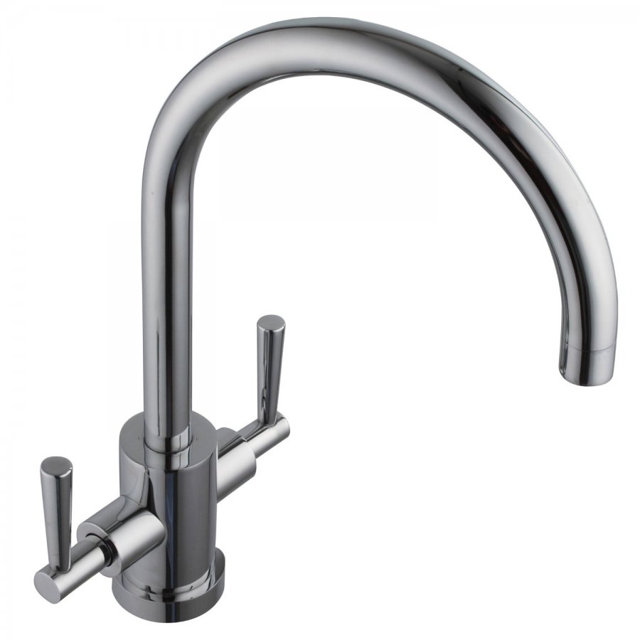

hi guys - i ve got this tap in my kitchen , ive noticed there is a lot of play in the hot and cold pillars of the tap, its not leaking, i was wondering how do i tighten the pillars, cant see any screws, i thought perhaps there might be a hidden screw somehwre?..any ideas..ta

If you are talking about the valve handles, sometimes they twist in, sometimes they have a little hole on underside where a grub screw is can be accessed, this sometimes capped. And sometime they are welded on, and little can be done then.
yes sorry thats what i meant to say "valve handles"...they seem to have some play in them . only a year old, this tap is suppossed to have a ten year warranty..ill have a closer look when im at home...

Can you find a link to the tap that you bought?
Do the upright handles themselves unscrew, giving access to a screw below? I would say they'd need to come off so the tap can be .
I'd give them a call and ask them if you still can't get access.
the levers dont unscrew, there doesnt seem tobe any make or name on the taps..heres the http://www.ebay.co.uk/itm/PARIS-DES...811?pt=LH_DefaultDomain_3&hash=item563ecdbbd3
i bought the tap from ibathuk, less then a year ago ..it has 10 years warranty , ive emailed them and phoned them they dont seem to undestand what im talking about. i have even sent them a video of the problem but for some strange reason all there agents seem to keep sending the same reply "tighten the tap , wash out the ceramic carttridges as they may be dirt stuck in there", i ahve told them i cant see how i can remove tap levers and tighten them"....

I'll take a small bet that if the levers do screw in they'll be tight. Otherwise you are absolutely sure there isn't a screw at the back or something?
One other thought. Do a Google image search on the picture of the tap. There appear to be a couple of non-eBay companies who sell that model. You could try asking them.
