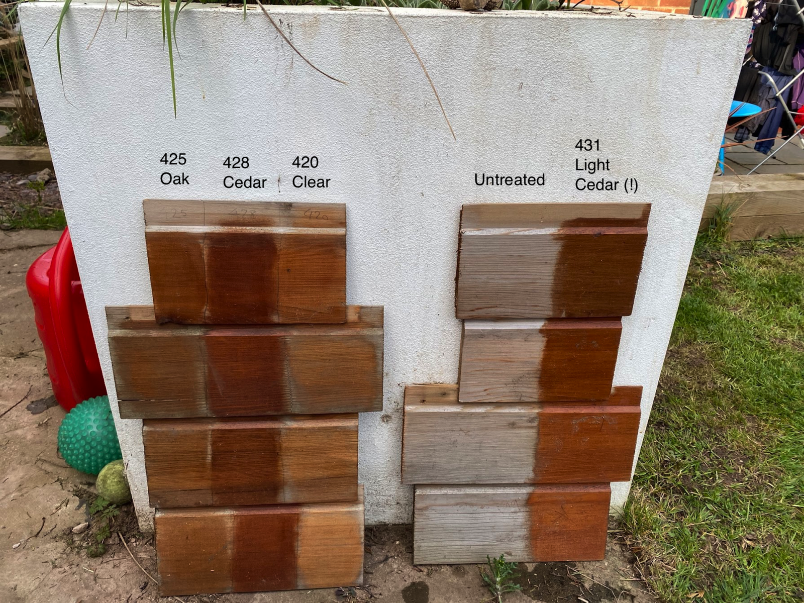

A year ago since I did my Cedar cladding, and I made some samples using various Osmo UV colours, which have seen the sun 6+ hours a day most of the year.
May be handy for anyone trying to work out which to use. Clear UV still gets my vote. "Light" Cedar appears far from light! All Western Red Cedar.
My place a year on (ish) 420 clear

As much as I like Osmo, I am not convinced that they have a clear UV oil which will stop cedar becoming grey further down the line. I hope I am wrong though.
Perhaps contact them. I have been happy with their customer support in the past.
