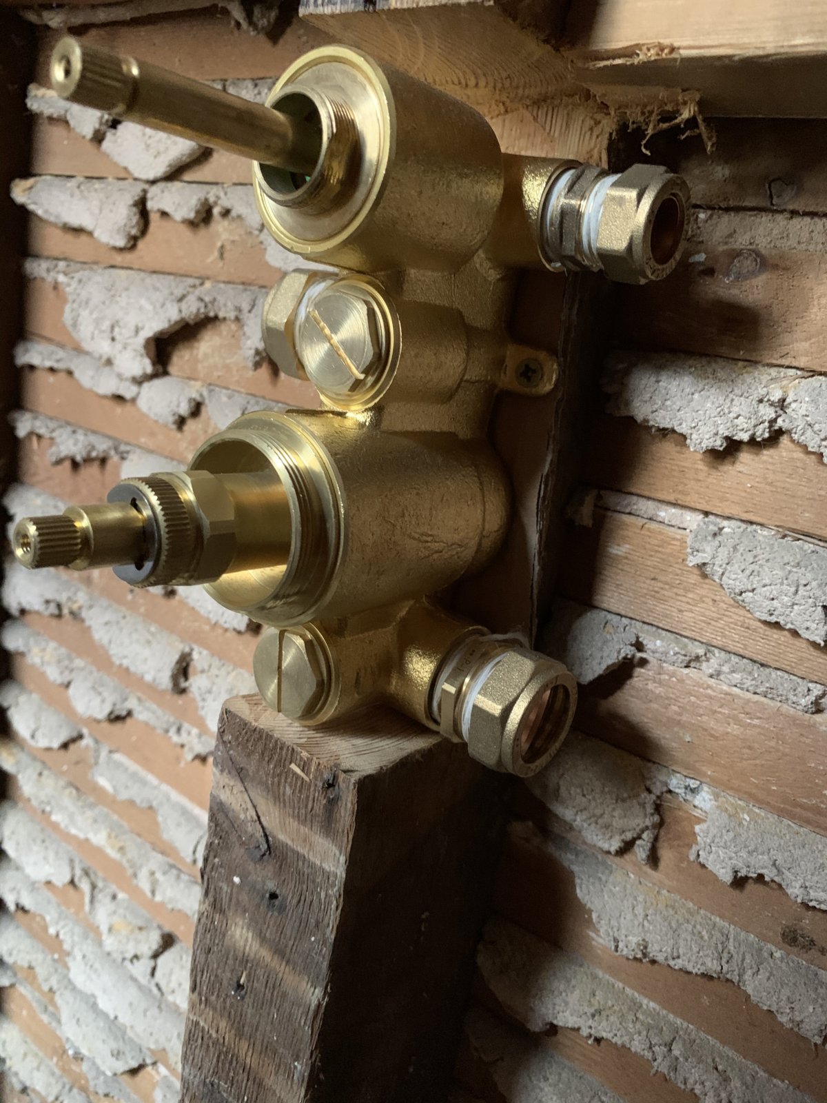

Hi all,
So completely refitting my brothers bathroom.
Got a 800 x 1000 shower enclosure.
Concealed 2-way mixture valve which I’ve fitted.

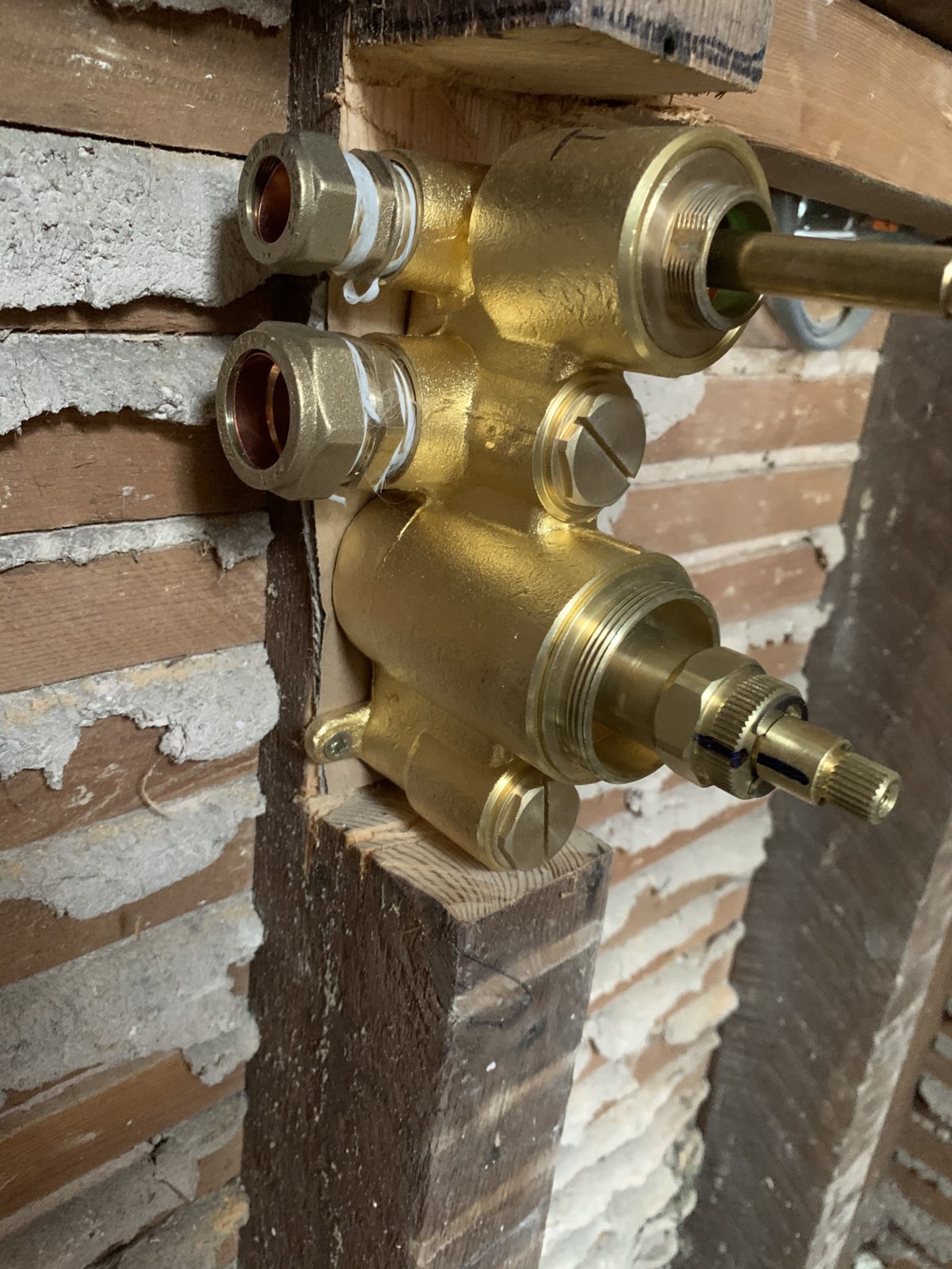

As you can see the inlets are 22mm. I suppose I need to just use reducers to 15mm?
For arguments sake the top left outlet will go up and above the new suspended ceiling and down the other side of the enclosure to the 300mm square shower head. The outlet on the right will go down, under the floor and up the other side of the new stud wall (part of the enclosure) to feed the diverted handheld.
I’m using pex pipe pretty much everywhere, I will use copper to come out of the valve and when going into the shower head and handheld. I’m trying to use single runs of pex pipe with as few joins as possible.
Now, I know a lot of plumbers/fitters don’t like concealed valves, or pex pipe for that matter, but that’s what I’m using so no need to comment on that.
question: do I need to put check valve on both inlet feeds? If so, where. A brand new baxi combi has been installed. Pressure is good.
all advice welcome (except comments on using concealed valves)

You could use 22×15 reducers, yes, but a better solution would be to use ¾" MI × 15mm compression fittings straight into the shower valve - reduces the number of joints used. You don't need PTFE on the thread the nut screws on to - it does nothing to seal the joint, just makes it harder to do up. I suggest you might need more on the end that screws into the valve though.
Both check valves and isolation valves would be a good idea, but they need to be in an accessible location for maintenance - above the suspended ceiling could be a good place

Check valves are full bore if you buy full bore check valves. They should ideally be fitted to both hot and cold supplies for best practise. The arrows on the isolation valves are to show you which way round to fit them, that's all. They don't have any backflow prevention function. Fit them the wrong way round and over time the water pressure will damage them.
There may already be check valves under the slotted hexagonal nuts or they may be only filters. Check the installation instructions. In either case, I'd suggest removing the nuts while you still have access, and replacing them with a little silicone grease on the threads. Make sure they are left accessible when finishing.

As @muggles mentioned, thread tape/seal/thread on the fitting threads does nothing, a compression fitting doesn't create the seal at the threads, in fact using a thread sealant can actually stop the fitting from tightening properly if there's too much used, so it needs to be removed.
The watertight seal is created at the olive when it is compressed against the pipe and the fluted faces on the nut and the fitting, so if tape needs to go anywhere then it's a few wraps around the olive.
There is no olive. If you look at the pics of the valve (previous post) the 22mm compression just screws into the valve.
I’ve tried tightening it with nothing and it leaked, so I tried ptfe and it leaked.
When I got to site this morning I re-wrapped the 22mm thread with locktite55 and it finally worked.
Then the bloody hot feed valve started to leak, so I undid that removed the ptfe and replace with locktite55 and that’s now fixed.
THEN....the frikkin cold started to weep every so slightly again,and it’s fully nipped up.
WTF!?
If you look at the pic again, the other end is a compression end with PTFE tape on the threads and they have olives, hence the reply.
Only reason why it will leak is, there isn't enough tape, there isn't enough thread seal, it's been tightened too much and the threads have mashed all the sealing agent up.
I use gas PTFE tape, 6/7 wraps (normal tape uses anything up to 14 odd turns) and tighten it as much as it needs - you get a feel for it - no call backs yet.
I’ve checked the threads they ‘look’ fine. They are fully tightened.
Locktite55 does seem better than ptfe, but I put quite a bit of that onto not sure why the cold has decided to start leaking very slightly after a day of being ok. ‍♂️
No guarantee that'll do it, they need to be tightened 'just enough', too much and it can then burst the seal that's been made with the tape/thread. District static water pressure tends to rise overnight when usage drops and that may have been enough to push past the seal, once it's leaking it won't re-seal and needs remade.
