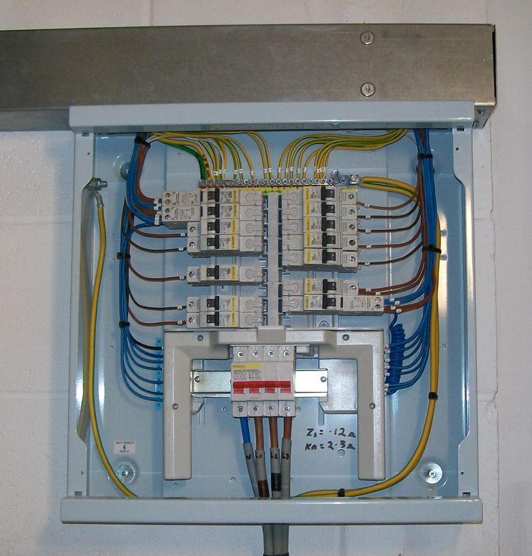

I would be grateful for comment / advice re: the attached photo.
Please be aware of the following:
1. The box is not distorted - it is a new MK metal one - image distorted by camera.
2. The single cable is there to 'test' accessibility.
3.As you can see this is not wired / energised - this will be undertaken by my electrician - he has agreed for me to undertake this (for learning/ save some costs) - and will be subject to his approval and change.
4. There have been threads on shortening neutral tails with varying opinions - so is the situation here daft / acceptable / good?
5. The label is only there to invite comment on loading / distribution. ie is it good practice to mix loadings?
With due respect to all contributors, I would be most grateful for comments from experienced professional (qualified) domestic electricians.
For those of you who 'think' I am intending to install this myself - I am not - I am trying to learn and get feedback on what is good practice so I can discuss the pros and cons with my electrician. If I were him I would cut the neutrals to make life easier, but the collective wisdom here may support or argue against that.
BTW - IF these are only every designed to fit in domestic CU's why do MK make them with such long tails, or are they used in industrial boards?
Thank you for your time and comments - this is a great forum. :D
View media item 60838 [/img]
That's nice an neat, but think ahead ...
Imagine what it will look like with all the wiring installed. Now change an RCBO - I think you'll find it virtually impossible without serious disturbance. The neutrals might be OK if you haven't put a lot of cables down the left hand side, but the earth tail will be a different matter. Those RCBOs aren't much (if any) smaller than the ProElec ones I posted a picture to earlier, and they are "fiddly" to wire with the neutral terminal so far down into the unit. You'll find the space above the breakers will disappear very quickly - IMO the box needs to be several inches taller above the breakers but few manufacturers seem to have taken on board that RCBOs are bigger than MCBs (one wonders if their designers ever actually use the stuff !).
I'd shorten the tails, there's no problem there - but I leave some spare length in case a breaker gets moved. For both neutral and earth tails, you really need a bootlace ferrule on the end as the terminals aren't very good with stranded cable - and for the earth you'll be sharing a terminal with a solid wire (or two) from the outgoing circuit. From a purely "how best to install it now" perspective, you'd shorten to the neutral and earth tails to just the right length - and the same with the wiring that goes into it. That gives you now margin for "oops, I need an extra inch" - but all those spare inches take up a lot of room in a not very big box.
The Pro-Elec ones come with long tails as well. I'm not quite sure why they are so long, but I think you have the right answer. Some industrial boards can be quite large, and I think most electricians would be "quite vocal" if they had to start extending tails off breakers. I'm not aware of Pro-Elec doing anything larger than about an 18 way consumer unit, so I'm sure they could be a bit shorter. On the other hand, they are probably all made in the same Chinese sweatshops and just printed with different labels to suit the customer.
As to which values of breaker to put where, I can't help thinking that's just one of those "we've always done it this way" things now. Some of the older fuse boards only had one position where the largest fuseholder could be fitted. I suspect that is a large part of the "largest by the main switch and work down" practice came from. As for modern consumer units, look at the size of the live bus bar and I can't see any reason you shouldn't have large loads at the opposite end to the main switch. As you can see from the photo I posted, I grouped the breakers into two groups - one group is stuff inside the flat, the other group is stuff outside (garage and outside lights). In part, the gap between them was just to give a bit more room for the cabling (and in part to make identification easier should someone be fumbling around in the dark - it's not in the most accessible of positions).

Is this better / more sensible / acceptable regs wise?

Despite appearances there is quite a bit of space between the bundles at the bottom to use the conduit cut-outs.
I have separated the Cooker (6mm) and split the sockets. Also, the garage is planned to have 10mm SWA, so plenty of space around to accommodate that.
I have the plastic spacers for the front panel, but are there such things as dummy units or is that silly / fussy? I'm guessing the bus bar ought not be exposed (above its cover).
JohnW2 & EFLImpudence
Thank you very much for the suggestions - blanks now in place & more space for the actual wiring. Very tidy and organised - hope my sparky approves!

JohnW2 & EFLImpudence Thank you very much for the suggestions - blanks now in place & more space for the actual wiring. Very tidy and organised - hope my sparky approves!
As you say, very neat. The only point I'd make it that, if it were me, I would have numbered the circuits according the the 'ways' of the CU (including those which are currently 'spares'), not just the ones currently in use. If you ever use any of those 'spare' ways in the CU, you'll end up with circuits numberd 1½, 4½, 7½ or 8½ :-)
