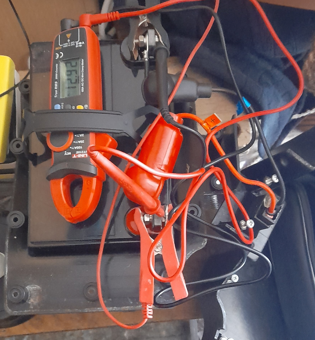

1754837830445.png1754837773727.png I would measure as shown at the battery, mine at the moment have the boxes open so I can charge without taking the scooter into the house. Also need to replace the overload in battery to right, on my to do list.
I guess I can run the caddies without the lids.
I would then see the voltage drop across each battery when used, and what, it should not drop below 12.4? Something like that?

The only place, to measure the voltage of any battery, which is under some loading, is at the actual battery terminals. Anywhere else, will suffer a lower reading, due to volts drop.

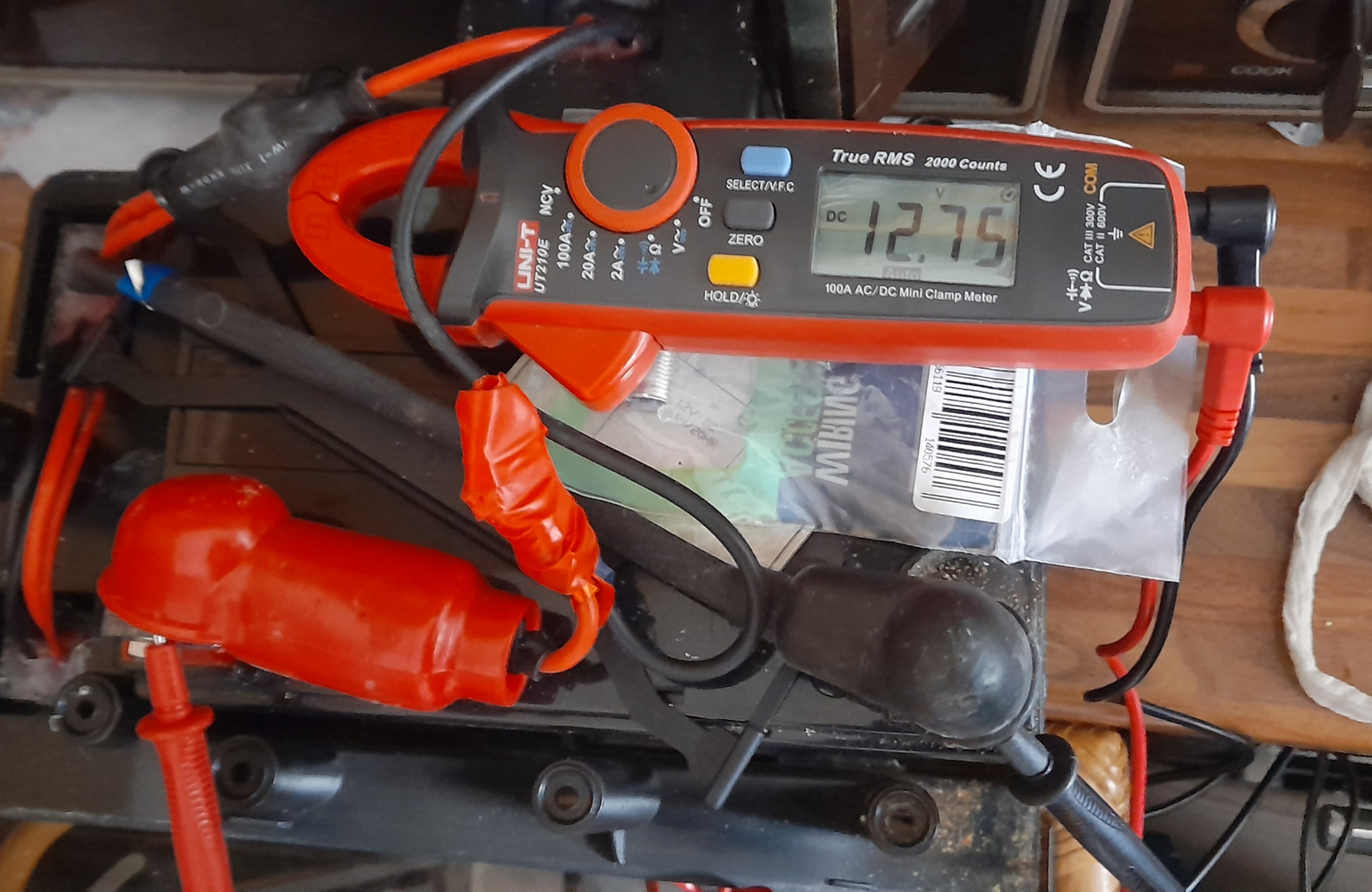

I took the caddy covers off and measured voltages on each battery directly with the scooter moving. I had to hold it while moving but I think I got stable enough readings.
I would like some opinions on initial interpretation though...

New Batteries - fresh charge
Initial voltage with scooter off: (fresh off a charge)
B1 13.11v
B2 13.15v
B1 (moving slow) 12.72 - 12.75
B2 (moving slow) 12.72 - 12.75
After that run I tested the batteries off again
B1 12.97
B2 13.02
B1 (med/fast pace) 12.65 - 12.7
B2 (med fast pace) 12.67 (ish)
