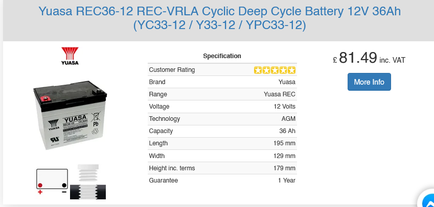

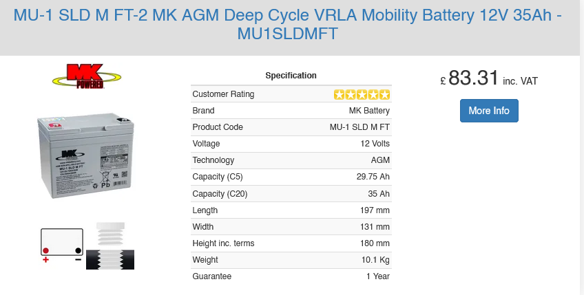

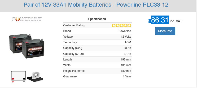

Deciding on some new AGM Lead acid batteries for a mobility scooter.
I'm going for 2x36Ah (approx) lead acid type.
I looked in to the lithium option...but I'm not convinced of the benefit (unless someone can convince me otherwise).
I using the sizing options on the tanya website, these are the results.
A pair of Yuasa at £170
or
A pair of Tanya's "own brand" batteries branded as Powerline at £86 for a pair art 33 -36ah
or
MK 35ah AGM x2 at £170
The only issue with the Poweline one are that the lug/connections are not the screw type. but I'm sure an adaptation can be made.
The price is too low to ignore consideration...but, I was trying to decide if it was too much of a trade off in potential quality or something.
They are the only ones that do not mention that they are "deep cycle", but they do have mobility on them, so they must be for that purpose.
Thoughts?

Until the experts have 100% perfected lithium and the charging thereof, I think you are wise. Far too many fires have been started when charging lithium-ion batteries. As for adapting the connection lugs, perhaps the prospective supplier of the battery could advise you where to obtain the necessary parts. Also, if they are sold as 'mobility' then each has to meet that criteria under the sale of goods act.
EDIT .. the lugs as in the photo are the bolt-through type so easily adapted to suit your needs(y)

Would you just go for the far cheaper powerline rather than the more expensive (and assumed better quality) Yuasa?
One thing I think people also overlook with the AGM lead acid, is that the weight of those batteries do provide a nice low centre of gravity counterweight against someone sitting high up in the chair.
But, on the Lithium front, SLK do 2 x20ah (assuming there is more usable capacity vs 50% of a 36ah lead acid). They cost £400 all in.
Still leaning strongly in favour of the AGM lead acid I think. Especially if people think those powerlines are good enough.

Wonder if the weight will reveal anything about the quality of the battery.
It seems that the cheaper batteries may have much less robust innards. More susceptible to damage to vibration, thinner lead plates, less cycles and so on.
Just trying to work out how much of an impact that has in mobility scooter applications, and whether it is worth the extra £80+ for a better brand.
Likely the batteries will come with a set of bolts and nuts... I seem to recall them being in little plastic bags with our purchase of 20/22 Ah ones of different brands. Would be worth a check with supplier to be on the safe side.
I've bought golf buggy batteries in the past when cheaper than "mobility". eBay sellers have Lucas for £120 a pair which we've used as well as Yuasa. (I avoid MK as they were OEM in our first scooter with a faulty charger and for no other reason.) Ditto for unknown to me brands. 17/18 Ah SLK were fitted in the second scooter and did OK but nothing special.
Unknown brand with no supporting technical specs (or manufacturer website I can find)... well you pays your money and you takes your chances.

OK, i bit the bullet and bought some new Yuasa's
The scooter is not used enough to warrant lithium or all the additional considerations and costs that involves.
Scooter is a TGA Zest Plus 4mph scooter. (Great scooter by the way)
So i went for the 36ah AGM Yuasa
