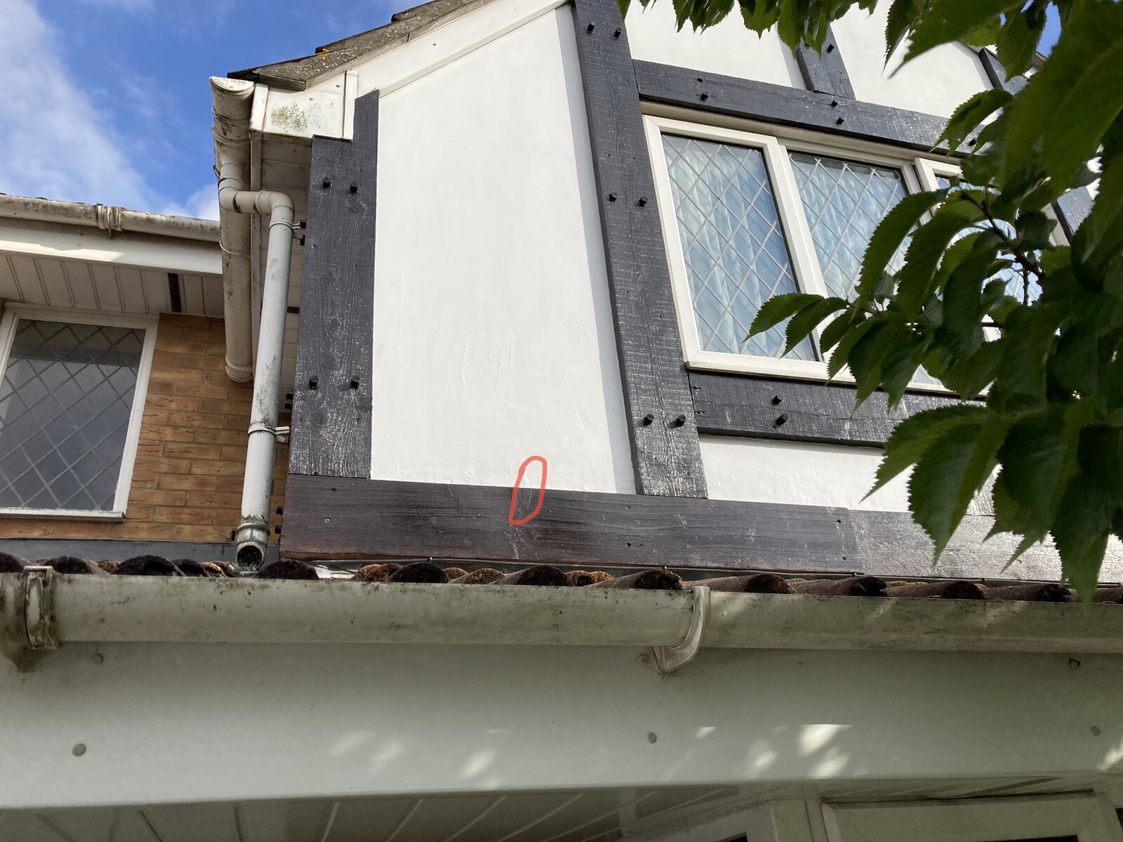

A few months ago I had a timber tudor board in the front of my house replaced. It is the horizonal one in the photo. I just found that there is a small vertical crack on the board (red circled). It is a small one (nearly hairline), but I wonder whether it would get worse with time.
Thanks for any advice.

I see you have two rows of screws
One near the top edge of the plank and one near the bottom.
This will always cause a crack when the plank dries out and tries to shrink across its width (not its length)
The screws restrain the edges and prevent them shrinking together
So it must split.
You can avoid this by making the holes so large that they can move about the screws, with a button or large washer under the head, or by using woodworking joints that accommodate movement.

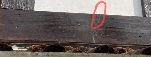

I think what you have there is possibly a knot in the timber. If it is it would probably have cracked less if the knot had been placed on the bottom edge rather than the top edge. Yes, it might get worse as water gets in to it, especially if it freezes in winter (as water expands when it turns into ice)
