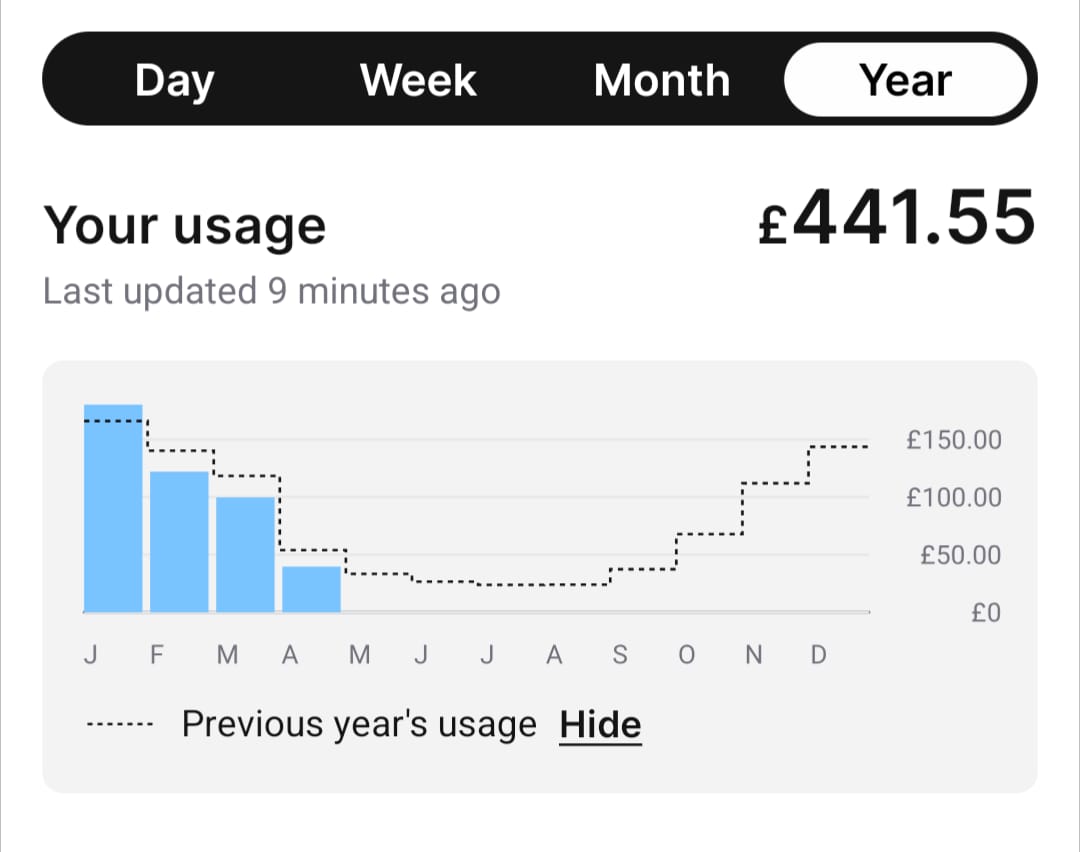

Glow-worm Climapro1 and Glow-worm wired outdoor sensor fitted in February and appears to be saving a fair bit of gas compared to last year.
It takes a while to get your head around keeping the house warm rather than warming it up...
Anyway wrong time of year now to post this but looking forward to hopefully making good savings moving forward.
on the other hand it has Been quite a mild winter this year
