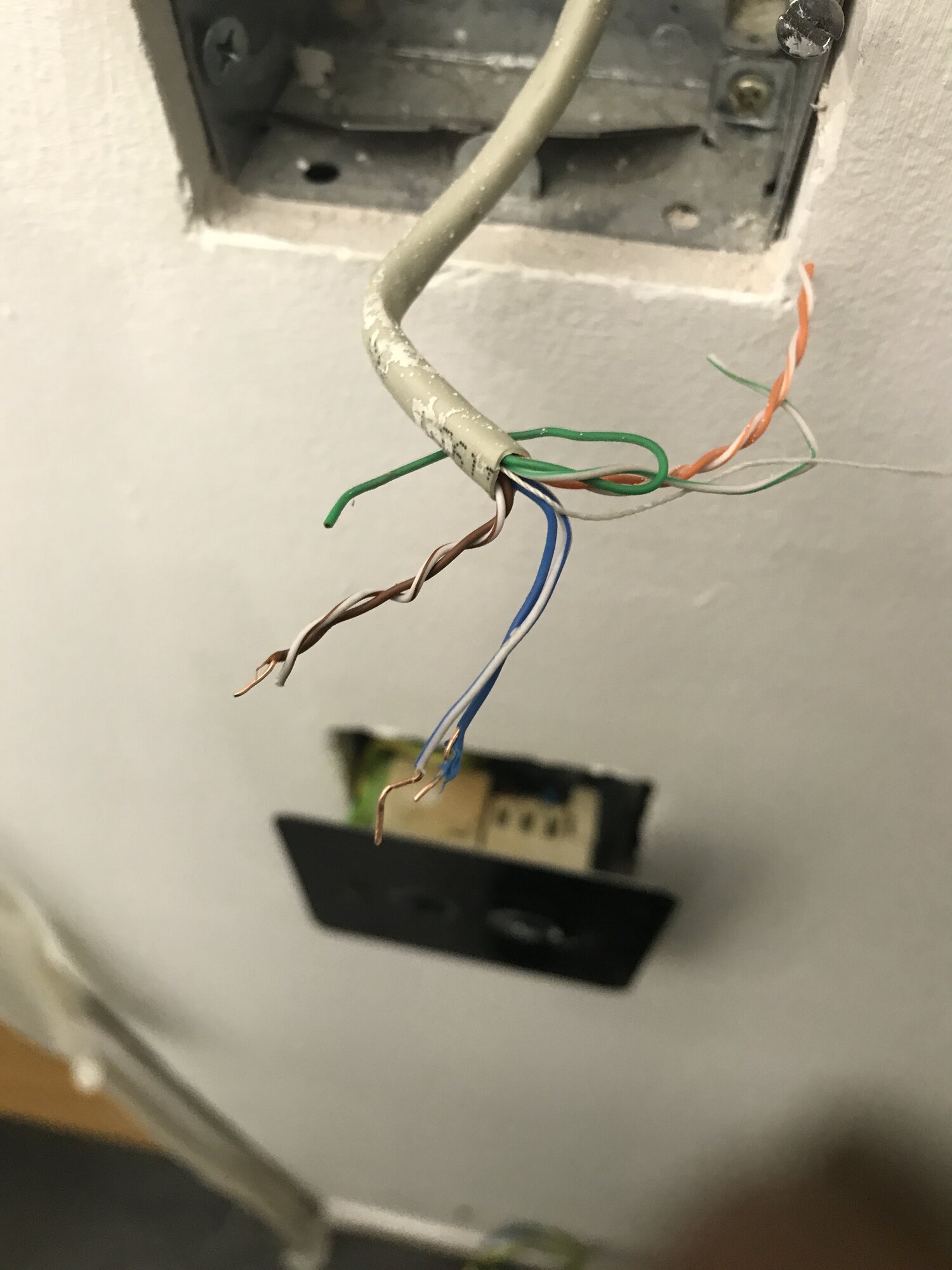

Hi,
I need your help, I have the MoesGo Thermostat but I’m unable to set this up correctly. So far I get a flashing red light. I have under floor heating and the previous setup I had was the ET-2 model. Please look at the pictures of the before setup and what I have now.
not with 230V L&N to power it, cat 5 can be used as switching on certain systems , but not to power that unit
Other than changing to a different unit. Can I not use a 230v to 12v transformer or something. And how do I find one which is compatible with cat5 wiring. Or do I just need to look for battery operated thermostats
