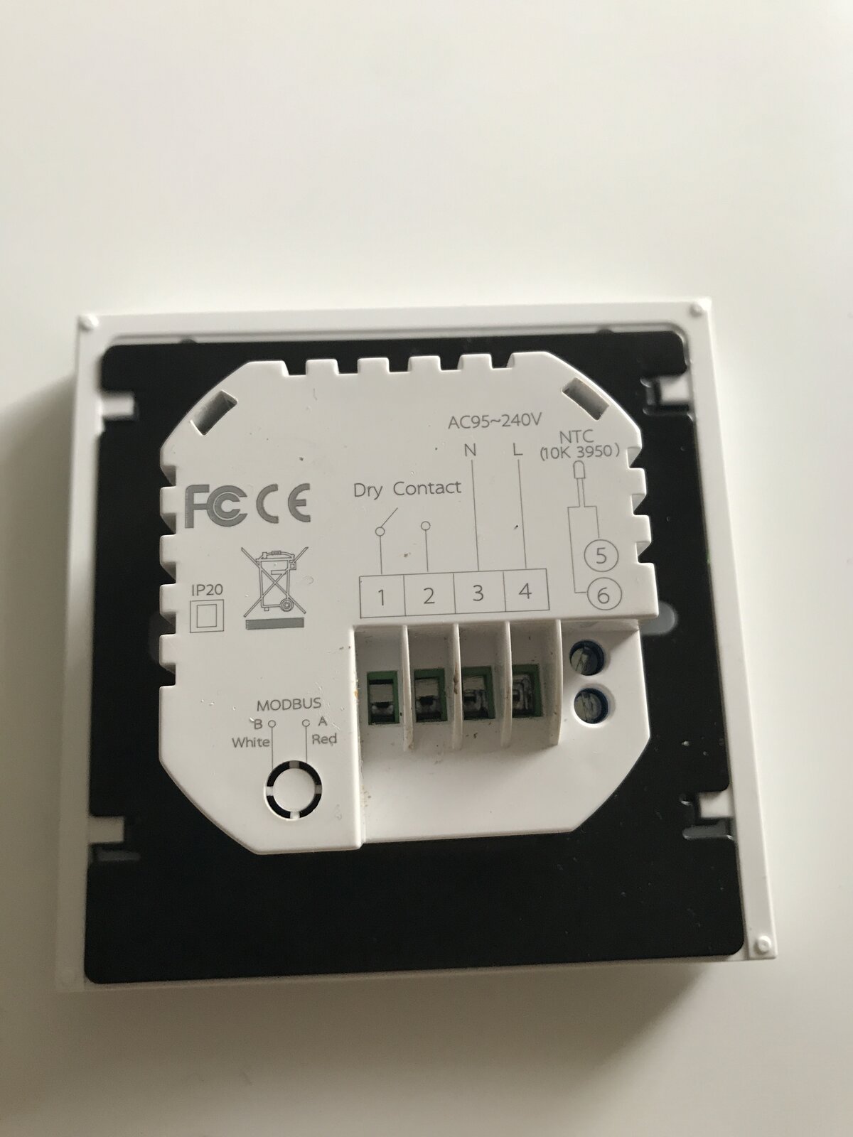

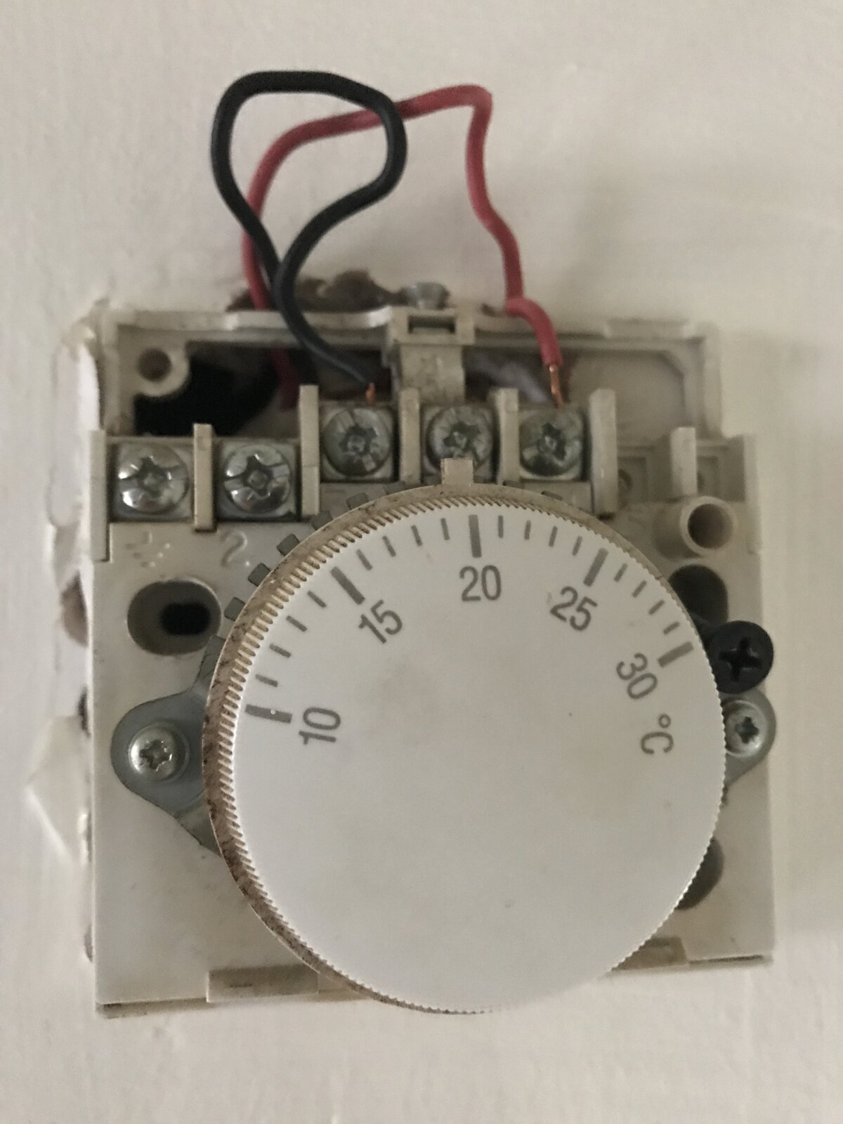

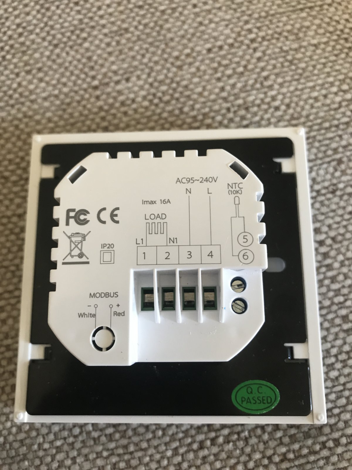

Hello,

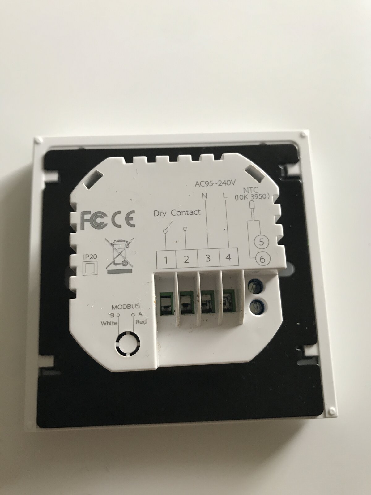

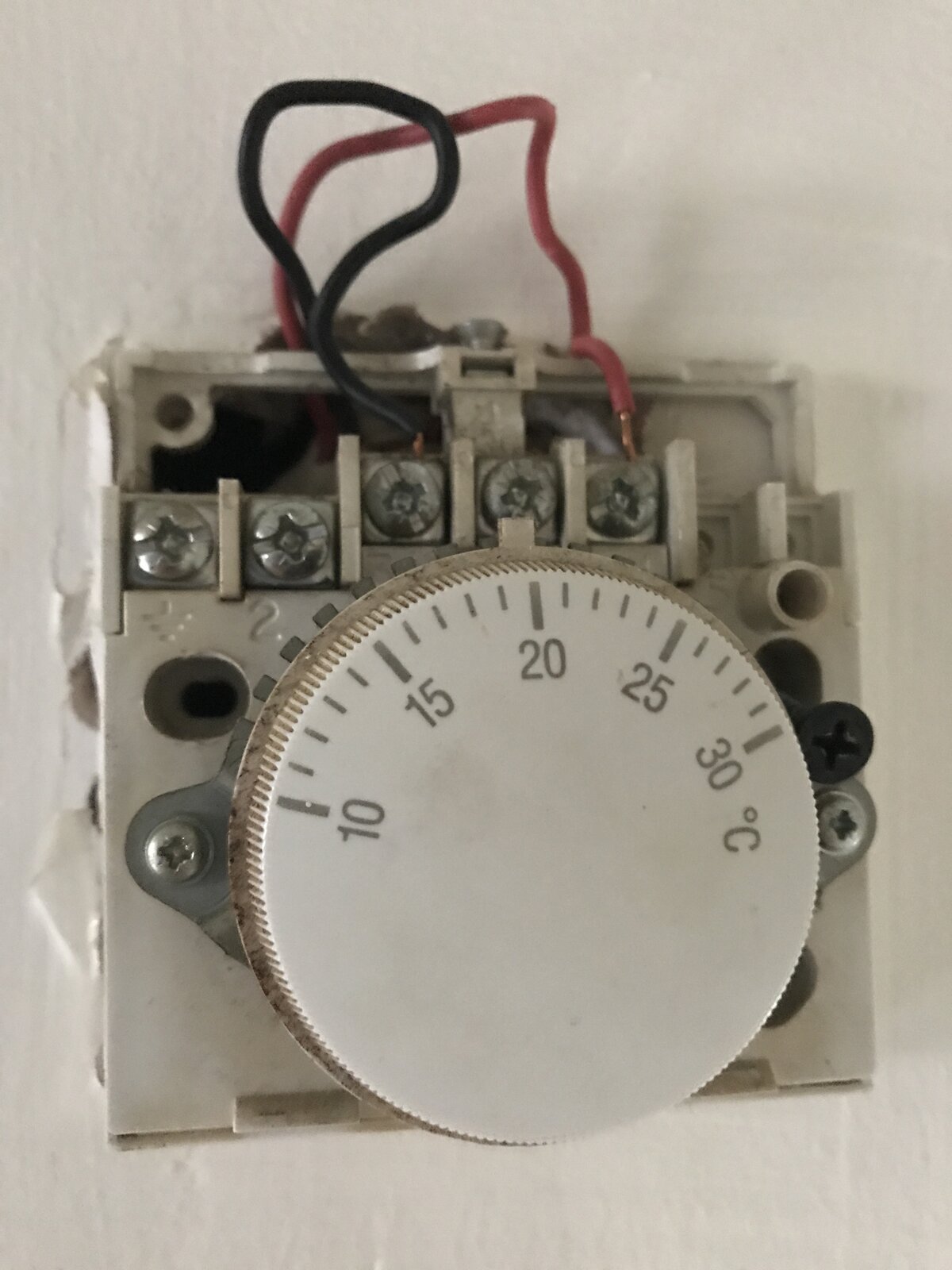

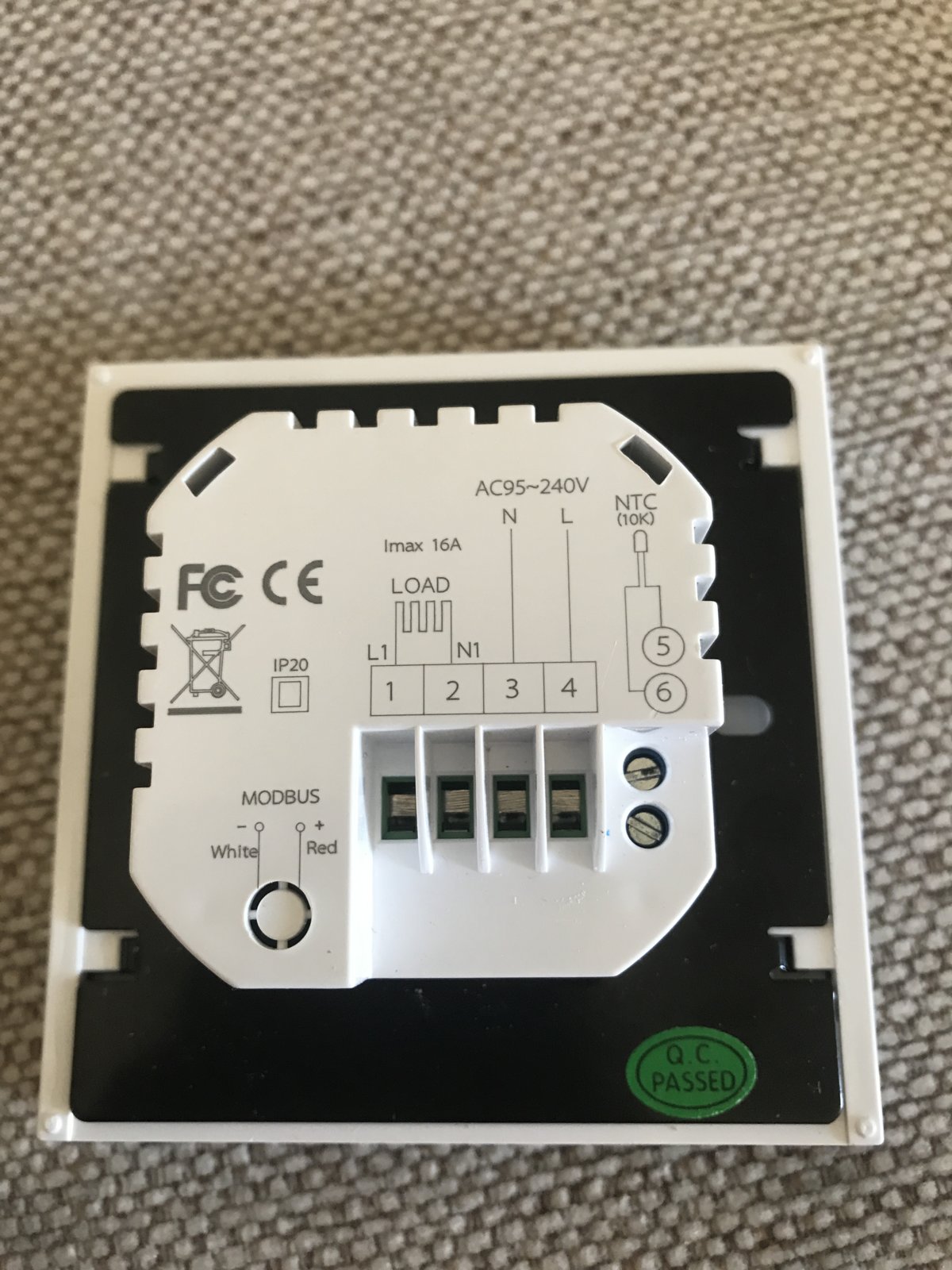

I am trying to replace my old T40 thermostat with a new digital thermostat.
The T40 has 2 wires: black and red connected. One of the spare red is not connected.
The new digital thermostat is the Moes BHT-002 and has 4 inputs, a live, a neutral and 2 labelled L1 and N1
I cant figure it out how to connect the cables. Help required please . Thank you
You have a thermostat designed for electric under floor heating, can you return it for the correct stat ?
Cant i use it with my normal boiler ?I bought it to use with the boiler
Just a reply to the other moes thread, although this stat will work (if it has air sensing built in) there is no neutral at the stat she has now, to the op you will have to get someone in that knows how to wire controls, sorry to have mislead you but its not a straight forward job.
Whilst that thermostat won’t work with your current setup, you could opt for a battery powered thermostat, which only needs the 2 wires you currently have.

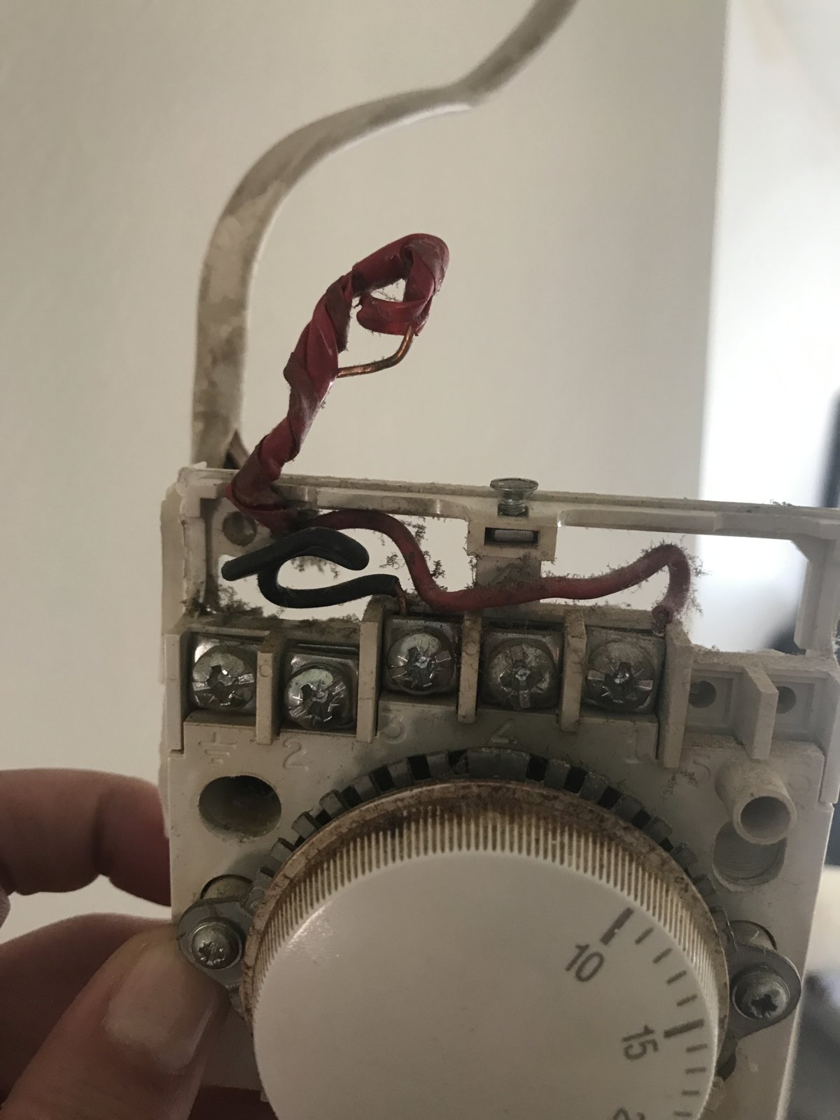

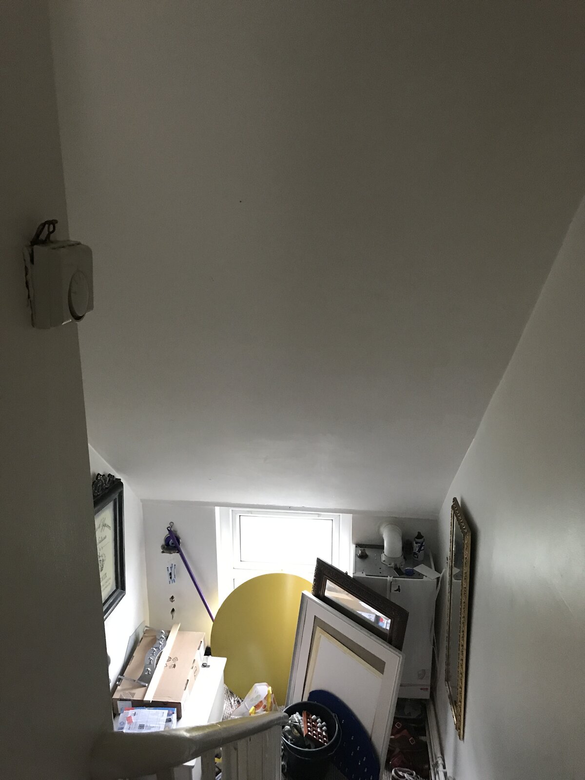

Hi all, I have the same issue, my boiler is set up on the hallway and the honeywell T40 thermostat installed by the stairs. Photo added. honeywell thermostat has 2 wires installed , and there is a third wire which is not installed.
I have a moes thermostat ready to install but we could not figure it out
Any help appreciated
Thank you

Hi Denso13,
What is the additional wiring? does our wiring system needs ( 240 live and neutrol? )
Can we use any 240 V ( live &neutrol ) wiring ? ( we have a light swith next to thermostat )
Does the new wiring has to be connected to the boiler ?
Thank you
If the unconnected wire is a neutral or can be connected to a neutral you can use the new stat, the wiring cannot be taken from anywhere except the boiler .
You'll need a live and neutral which should come from the same circuit which supplies the boiler and any other heating controls (normally from, or after, a fused spur supplying the boiler/heating).
A different two wire stat would be much easier.

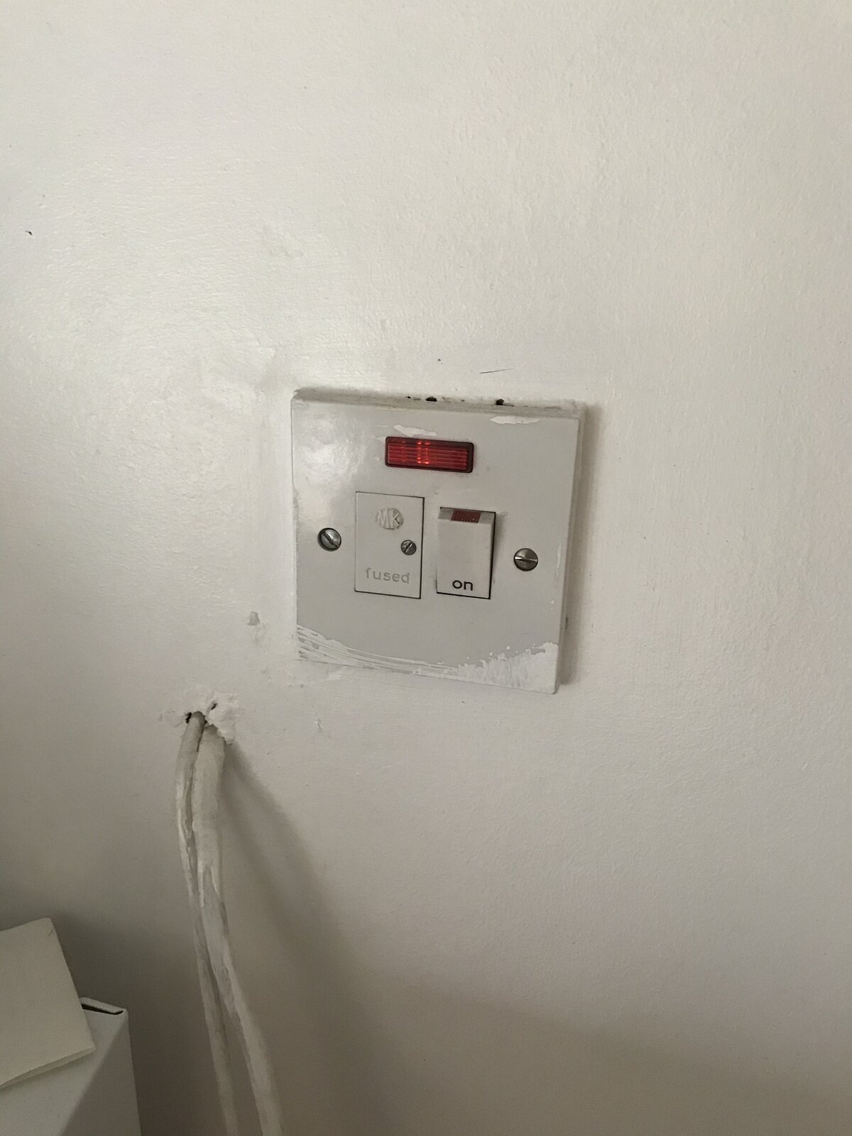

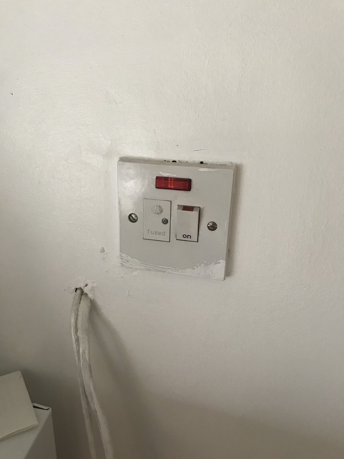

I added another photo, switch on the picture is Boiler on /off switch , 2 cables come through the wall goes in to boiler .
If i install the smart thermostat by the boiler, any idea if it is possible without using any wiring.
If the answer is yes, i will install the thermostat tomorrow, and will ask you more wuestiıns with the wiring.
thanks
You'll still need the same wires for connection wherever you put it, can't tell what you have by looking at your photo.
Not a good idea to put the thermostat next to the boiler.
Thank you Denso, i think we should give it up and start looking for an electrician.
