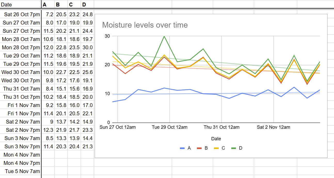

I have been monitoring the situation by measuring the moisture level in the ceiling at 4 different points at 7am and 7pm every day. I've also been running a dehumidifier in the room overnight. The dehumidifier has been collecting lots of water, although I do not know to what extent this is from the ceiling or the general atmosphere.
The moisture levels seems to see saw - it tends to be lower in the morning after running the dehumidifier, however in the evening, the moisture levels rise (and this is irrespective of whether there has been any rain). This is confusing - why would the moisture levels INCREASE when there has been no rain during the day?
See data/graph of the moisture levels below, with trend lines.
Thoughts?

I wonder if you got little to no insulation in the ceiling void?

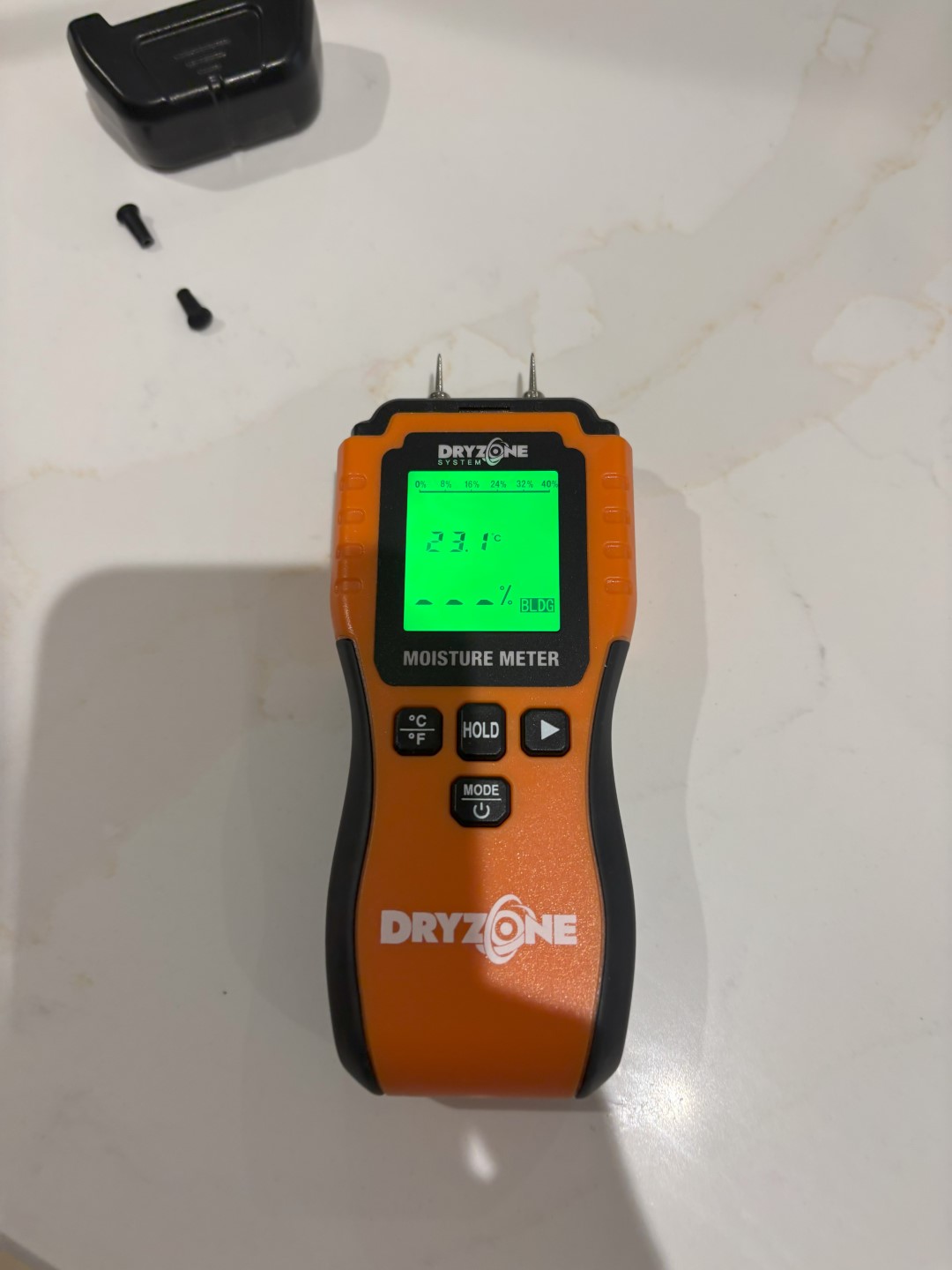

What sort of instrument are you using to measure moisture?

1. I have Dryzone Moisture Meter Detector from Amazon - see pic below. I put it in masonry/building mode as I am sticking the pins in plasterboard.

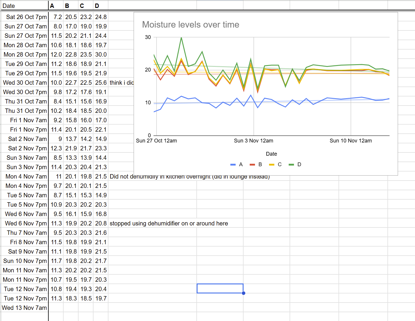

4. I have stopped running the dehumidifier. To be fair, it hasn't rained that much for some time but the moisture levels seem to be fairly consistent...
5. Interestingly, overnight I ran the dehumidifier in a different room which does not, as far as I know, have damp issues. I closed the doors. It filled the container with water by the morning, so it shows it is extracting a load of water from the air! Makes me wonder how effective it was at extracting water from the ceiling when I had it in the kitchen underneath the water damaged ceiling...maybe most of the water it was extracting was from the air!

“maybe most of the water it was extracting was from the air!”
Dehumidifier only extracts moisture from air .

Moisture meters for plaster are incredibly unreliable. Great for wood, rubbish for plaster. I used to use one and then realised that the salts in plaster that has previously become wet will will indicate damp even when the plaster is perfectly dry. As per @JohnD, tape cling film over a section.
