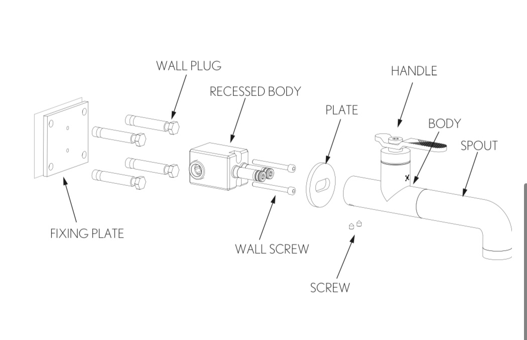

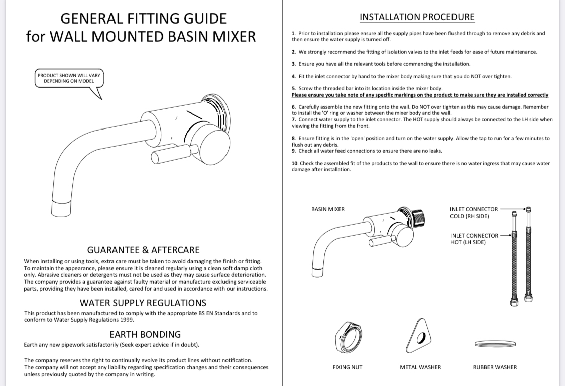

Hi,
I have just purchased a Hudson reed Tec wall mounted basin mixer tap but don’t see how the provided fittings can be used in a wall installation without creating a sharp 90 degree bend in the flexi hoses.
I have a wall cavity of approximately 70mm.
A similar crosswater version has a “recessed body” which addresses the issue by creating an elbow.
Any suggestions?
They haven't thought of that and don't seem to have any consideration for how it will be fitted in a stud wall.
