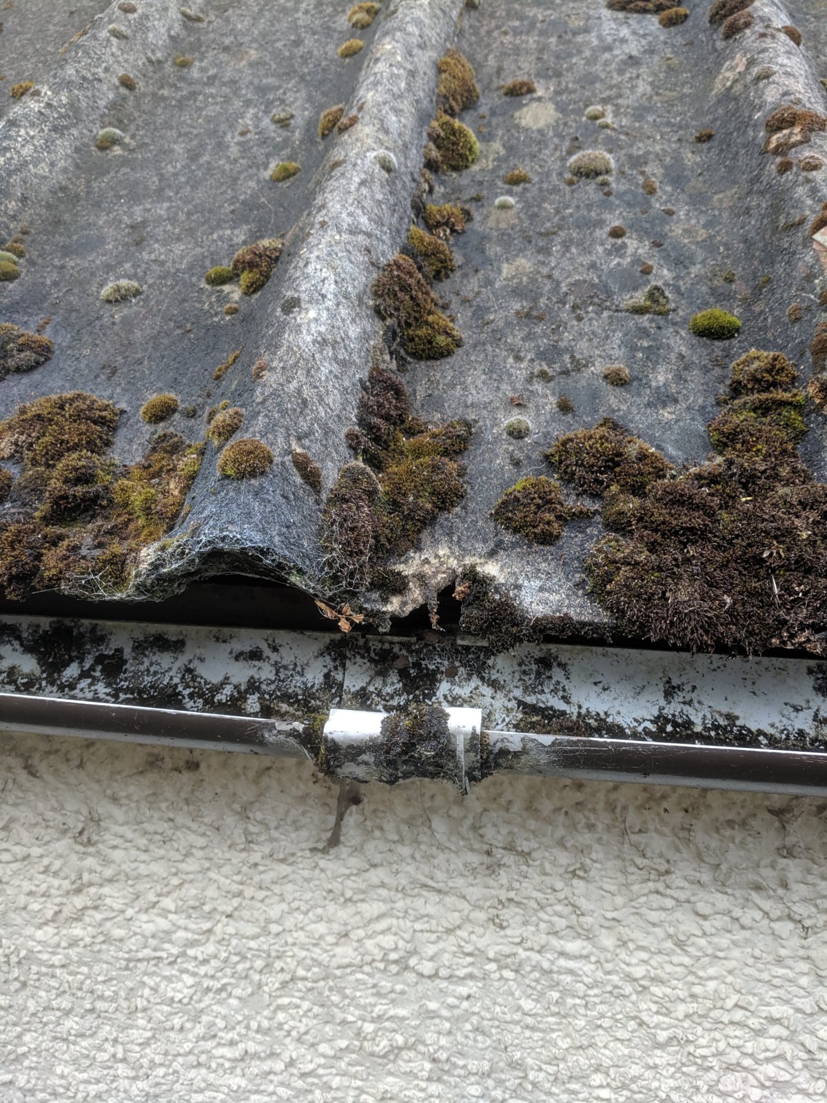

Sorry - more exciting roof news... I've noticed that a bit of concrete was knocked off the edge at some point - see picture. Maybe in some of the storms we've had.
It's nowhere that's going to cause a leak, but does this make a difference to roof longevity - or OK to still leave as is? Thanks!

Thanks - will look again at copper. As in the picture, something has took a piece off the edge of one of the concrete panels. Is this likely to cause problems, or just something I can leave? It's not in a position where it'll cause a leak or anything, assuming it doesn't get worse.
So long as the rain water drips into the gutter, everything is fine - if it doesn't, time for a patch of some kind.

Thanks. The rain should still run into the gutter fine - it was more whether damaging the edge of the concrete means the gap is likely to grow, or it'll just be as strong (or fragile) as it was before...
It will be fine - likely its just had a knock with a ladder, piece of timber or whatever.
