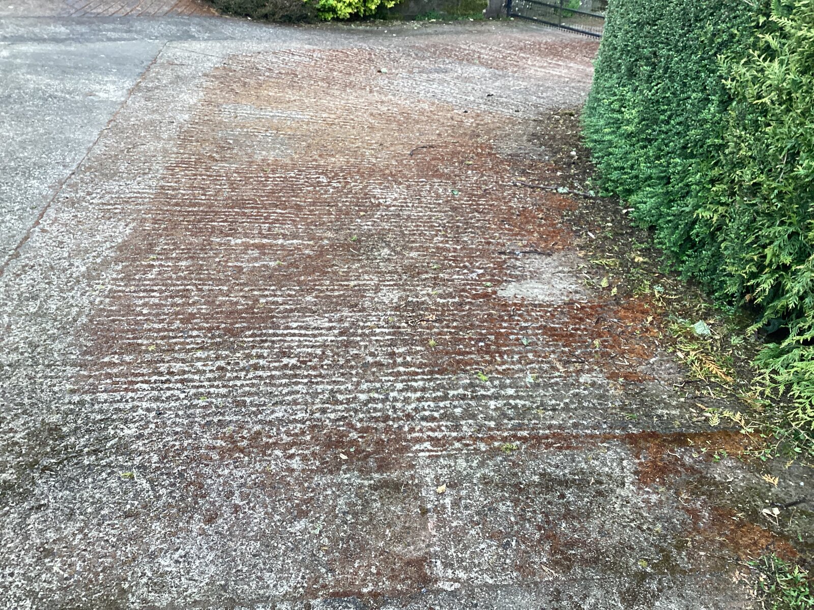

FYI, I sprayed my front yard last Friday (5th) when it looked like this

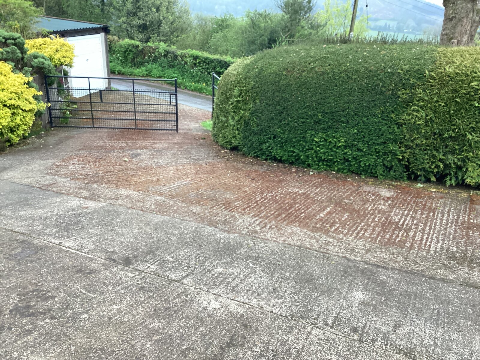

By the following Monday it looked like this
I used it at a rate of 100ml of BAC 50 diluted with 1500ml of water.

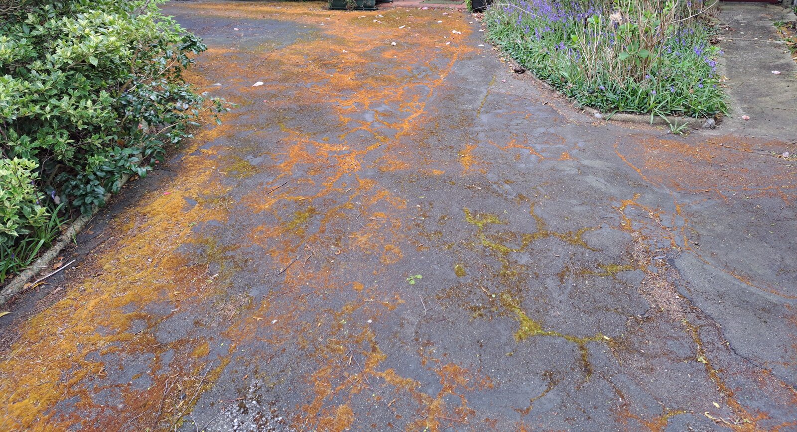

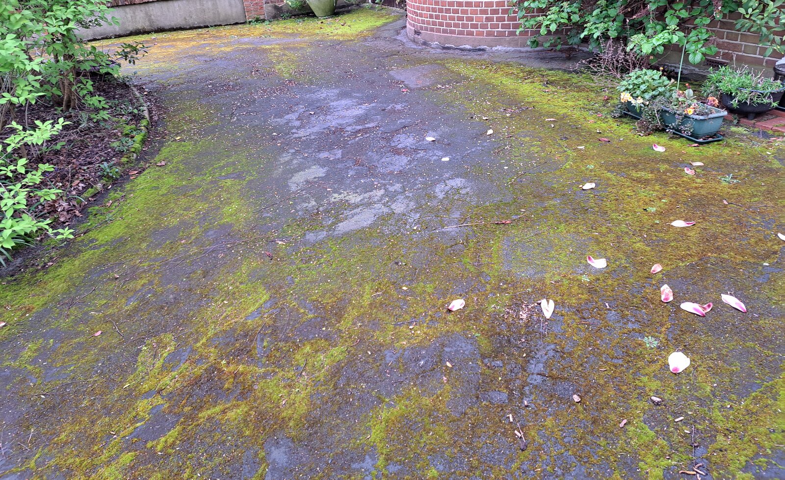

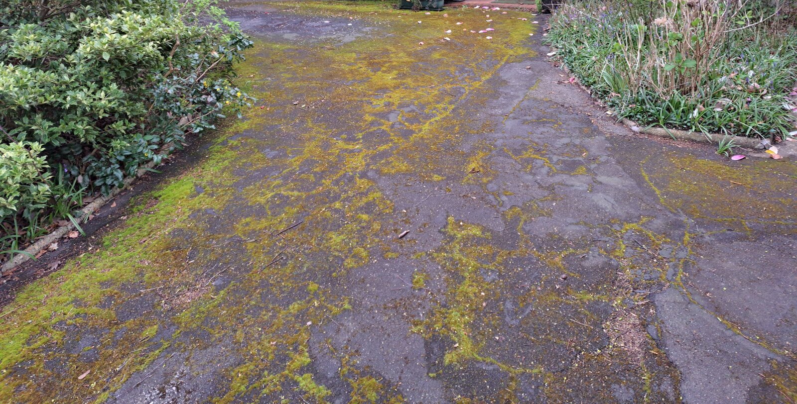

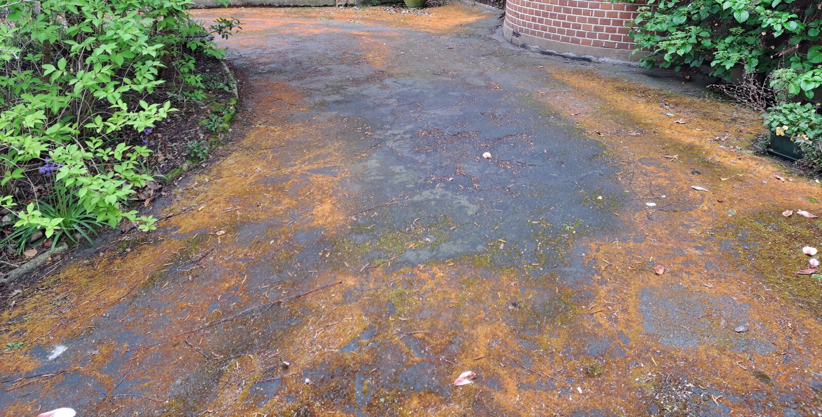

Moss gone brown and stiff broom dislodges it a couple of weeks after biological washing powder treatment
