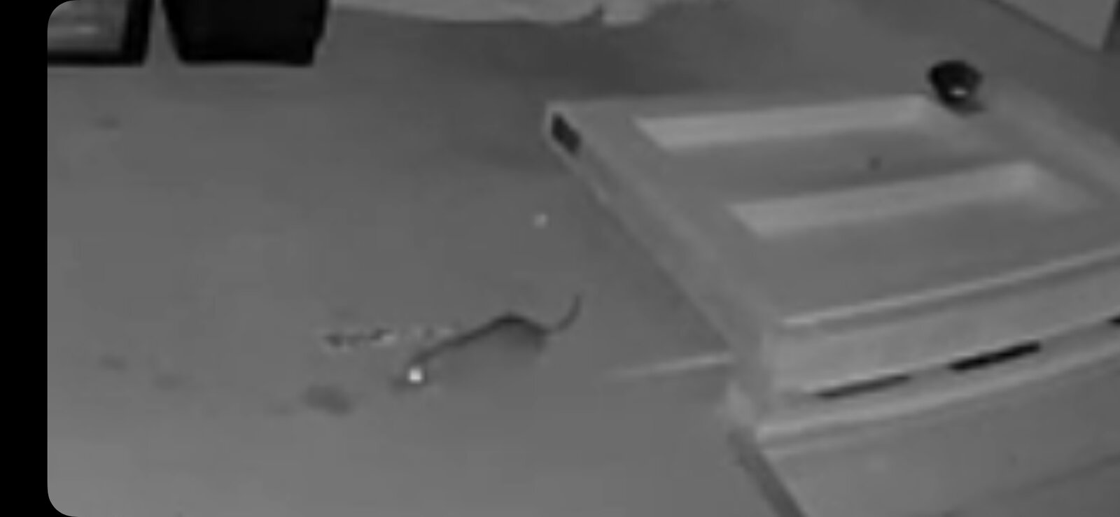

We have rats (for sure) and maybe a squirrel that are in our loft.
The council had environmental health lest control out who laid baits etc.
They advised I have a roofer or similar to check for entry points in the roof and on the outside of the building and seal up any entry points.
This is not something I can do so looking a professional company to do this.
However please can others advise the most effective sealants to cover up holes? Proofing (what type), sealant, rodent-proofing paste etc? Need something that's going to last for years and not something that only last a year.
So need to ensure who ever seals up entry points uses the very best materials etc?
There's no infestation yet just started to get a few visitors in last few days up there.
Only caught on camera the rats and no squirrels but suspect maybe a squirrel too as it was during the day and very nosiey and the way a box was ripped into looks like a squirrel.

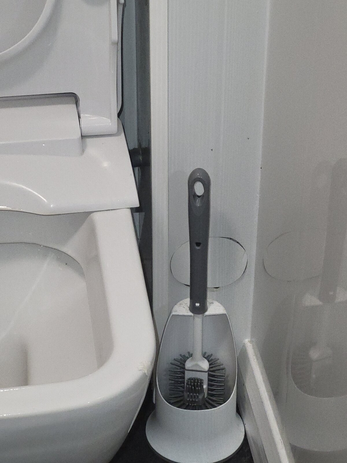

Can I also ask this question.
How can I proof off this hole (behind toilet brush) as the previous owners cut a hole though the plastic so you can access the stopcock and that round bit of plastic just comes out and then back in.
But as it's an entry point from within the walls and pipes and outside I want to proof it off but somehow allow for me to still access it if I need to use the stopcock.
Please can some people give me some ideas? Thanks
For starters i'd use a boxcutter to cut a cleaner hole, then apply a simple latch across the flap to prevent access from outside.(y)
Thanks. So you mean put another piece of plastic over the top and then a latch to open and close it?
Any links to any materials I would need would be really helpful. Thanks
