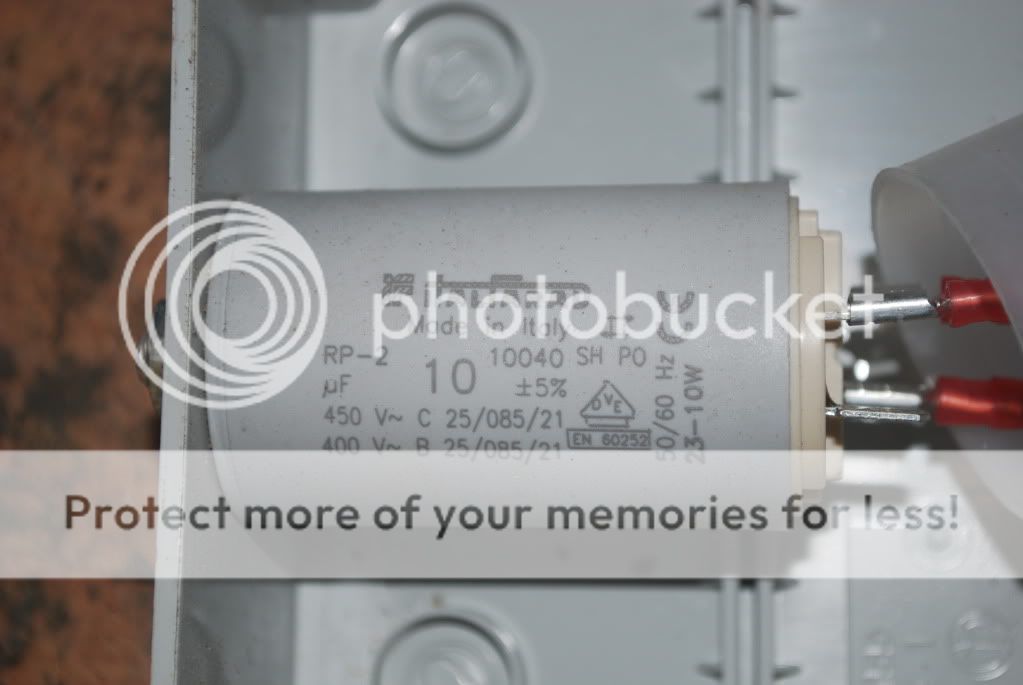

that's a 3 phase motor converted to run on single phase
so yes possibly the cap
any chance of a pic of the terminals?

Hi Matt,
Yes I have some here.
yup definitely 3 phase converted to run on single phase
so it may be the capacitor
the neutral will be common to either black or grey check the soundness of these connections on the cap
if you have a multimeter you can do a quick test on the windings (some will measure capacitance too)
where is the machine located?
if you have 3 phase power available then the motor will run much better on 3 phase
Matt
All I have is 240v here.
I will dig out my tester and have a look and get a new capacitor as I don't think they cost that much.

No probs and the cap will cost you around £7 from RS components here
Make sure you get one designed for continuous duty (running not starting)

I bought one of these
http://www.ebay.co.uk/itm/250717035891?ssPageName=STRK:MEWNX:IT&_trksid=p3984.m1439.l2649
The same as the one in that white box. I just hope it fixes it but looking at the motor there isn't realy that much that can go wrong with them.
Thanks for your help.
As I said in my earlier post, did you check that bothe weights are in the same plane i.e. downwards, as i can see the front one is hanging at the bottom, like wise make sure the one at the other end is in the same angle, if one rotates as I can see if the nut gets loose it can slide off its intened angle, as for capacitance, I do know some central heating water pumps stop running fast when a cap goes down, they spin so slow, and most I came across use 2.2uF 400Volts, they are roughly the size of a C size battery, you could try to undo the compartment where the cap is mounted and the value will be printed on it with the voltage rating. I am guessing for a motor this size you will probably need a higher capacitance possibly up to 10uF 400Volts and thats going to be fairly large like a D size cell.

I should have the new cap tomorrow and I don't think the weights have slipped as they are too tight to move and I have found this picture of the motor and they show the weights in the same position. But if the cap dosn't sort it I will have a mess with the weights.
