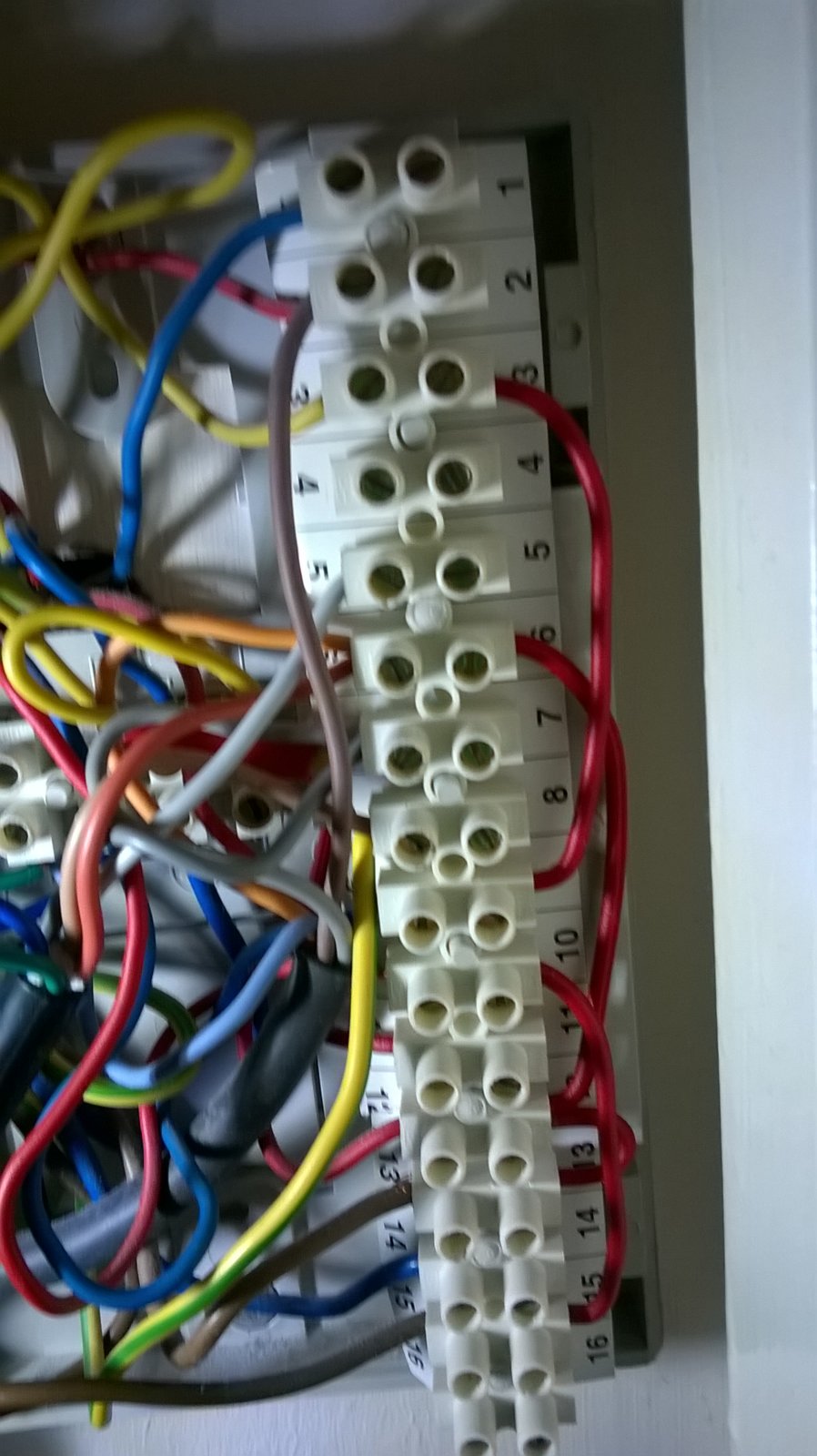

I have an intermittent fault with my boiler, it is not firing up in the morning with call for hot water so I had the boiler serviced hoping that may resolve the problem. I have since replaced the combustion chamber seal which was falling apart and partially missing, (read on a forum that can cause similar problems) , not mentioned incidentally by the service engineer.
The problem got worse, to the point where the boiler would not fire up at all, so I removed the motorised head, checked the gearbox a bit clunky so lubed it up seemed a lot smoother, that was about 4 weeks ago and the gearbox is still ok. I also checked the copper valve movement when the head was removed and it seemed a little stiff so I got the pliers on it opened and closed it for a minute or two and it seemed to loosen it up. Put it all back together boiler was firing up ok ,however it is still playing up, when the boiler will not fire up I can press the rest button on the boiler repeatedly and it won't fire up. As soon as I remove the motorised valve and replace it the boiler fires up ?
That is how I have come to the conclusion that it is the valve assembly. Thought I would try this and if the status quo remains I will call in an engineer.

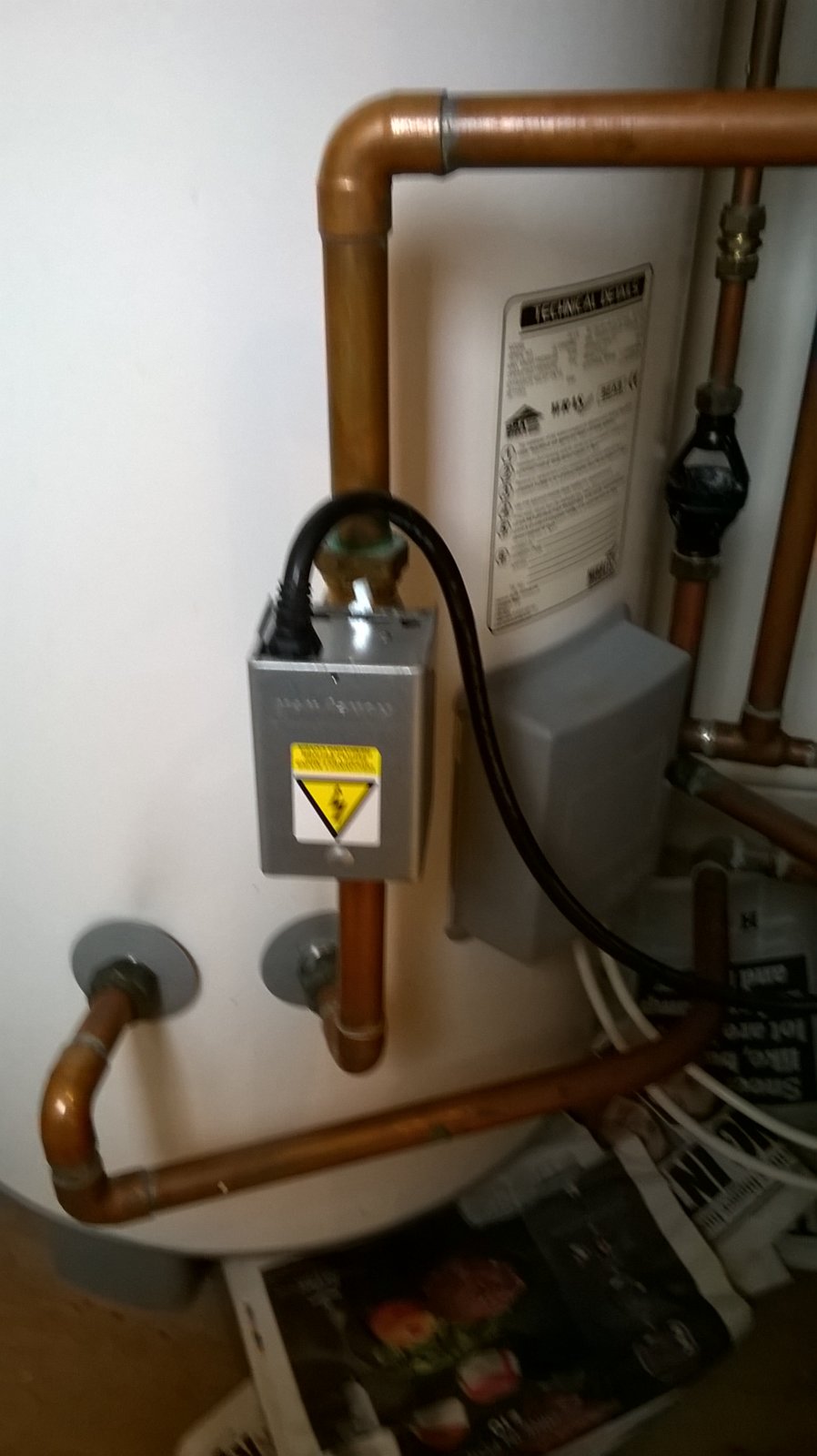

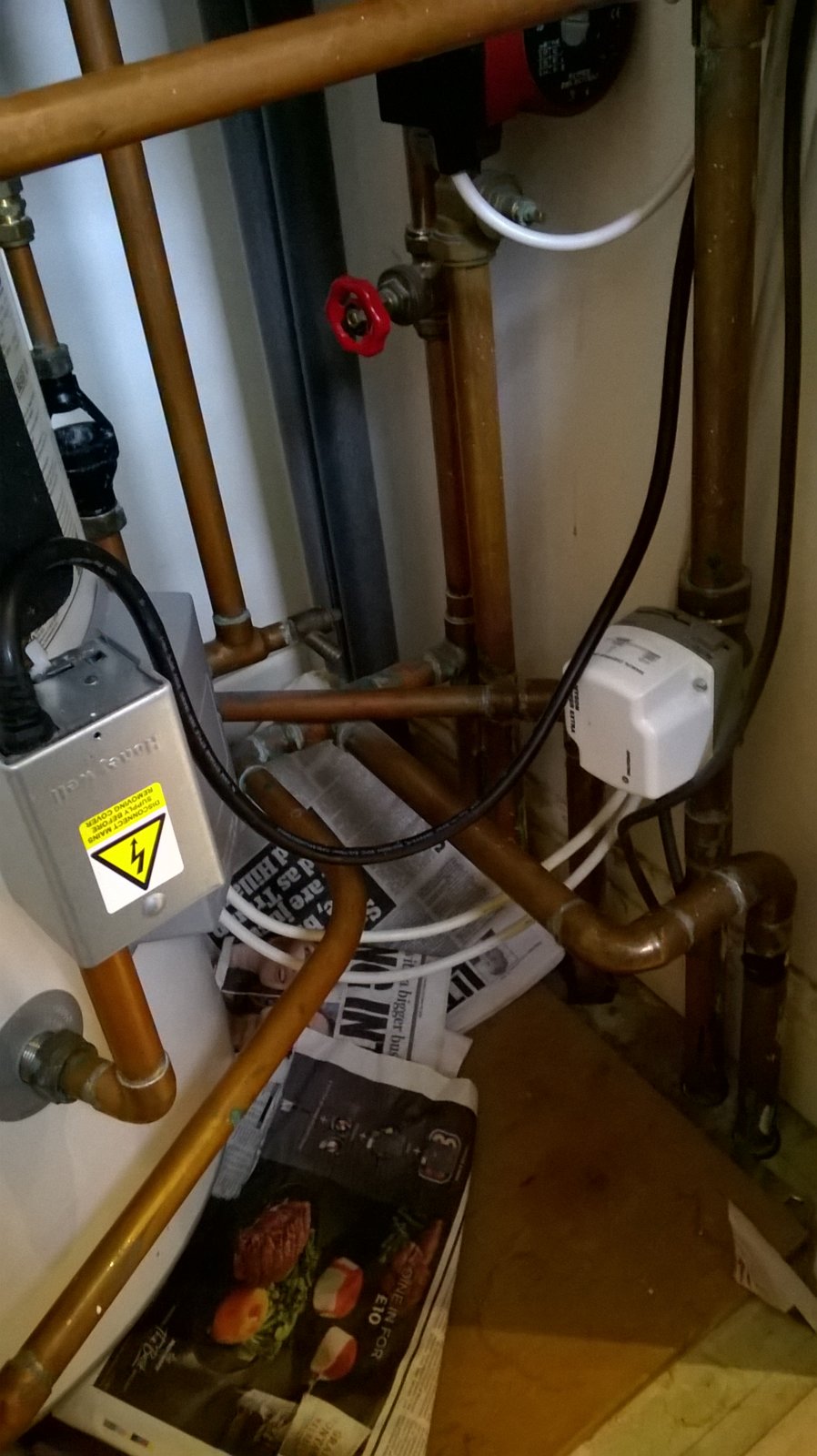

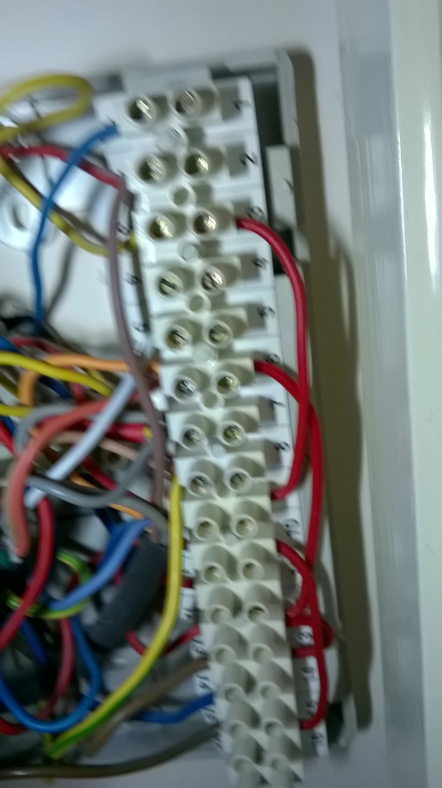

Thanks for getting back to me, interesting point about the motorised valve, as I have a six wired motorised head on 22mm copper pipe, this would suggest then that I have a 28mm motorised head six wired on 22mm copper pipe instead of the five wire. I am a little confused as the (sixth wire, white) is supposed to be electrically isolated, so does this mean it is not connected to any other part of the circuit?
Have attached some pictures which confirms the white /offwhite cable electrically isolated, not sure what you meant by the valve being attached to the Mega-Flow hope the pics clarify.
Really appreciate your time
Regards

The Honeywell valve in the pic above is on a pipe connected to the Megaflo; which answers oldbuffer's earlier question.
More importantly, the valve is part of the cylinder's safety system - necessary as it is an unvented cylinder - which must be repaired/replaced by an engineer with G3 qualification.
