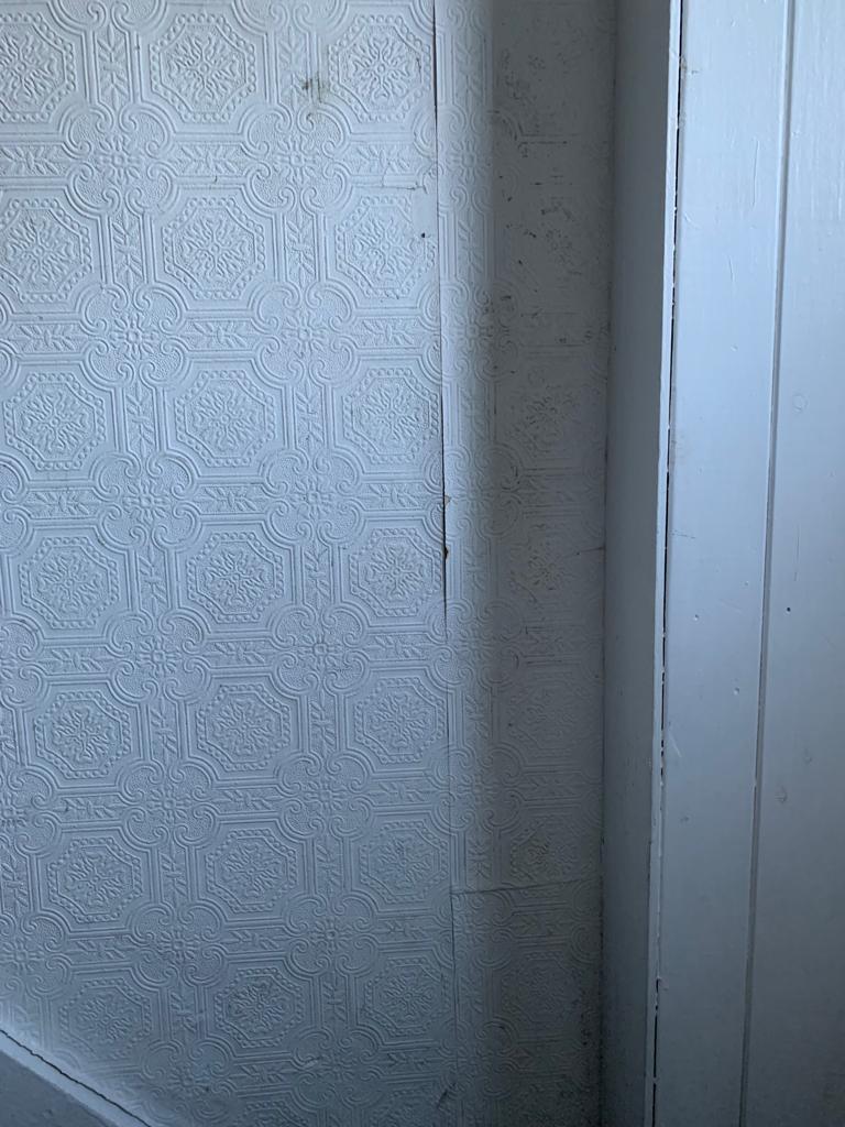

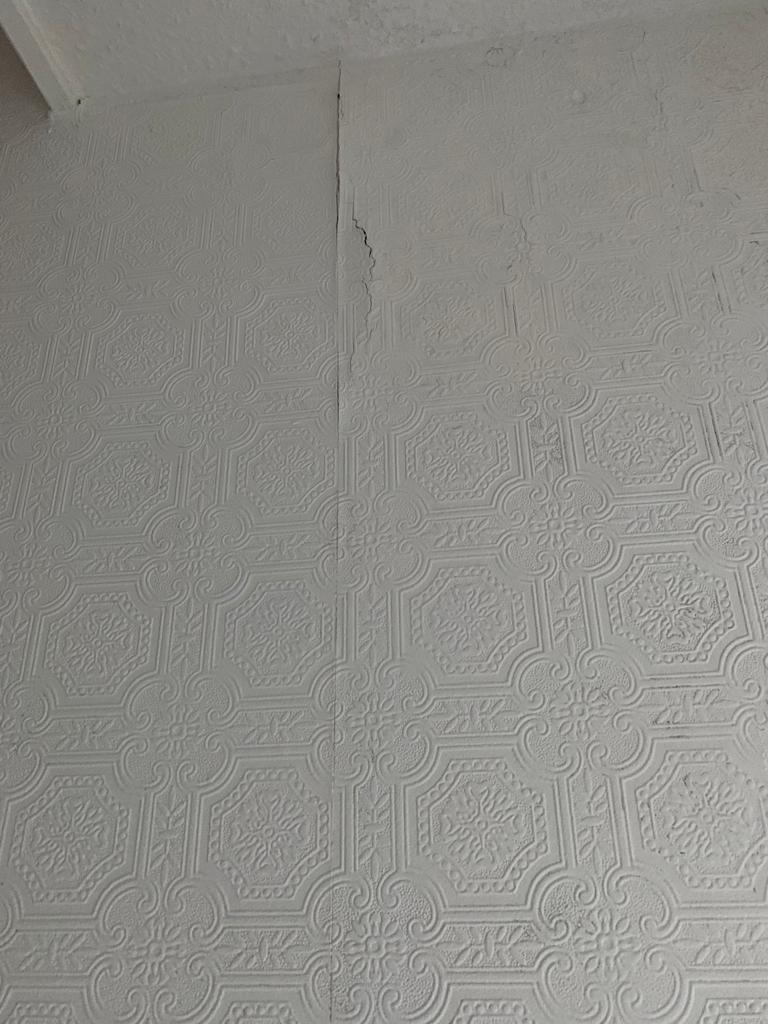

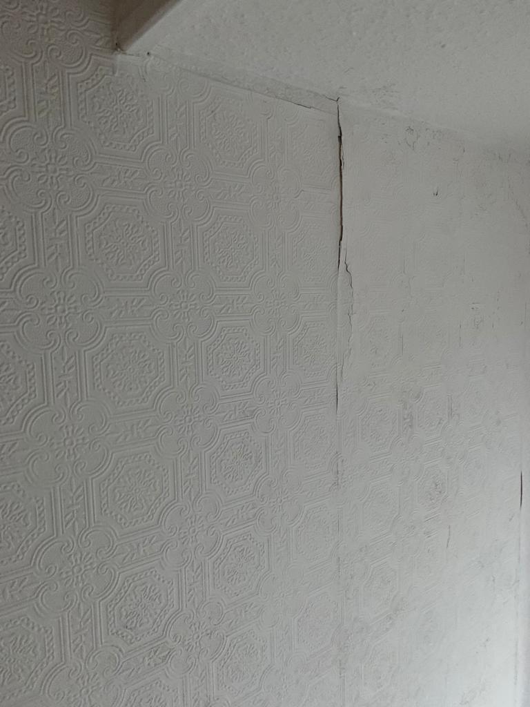

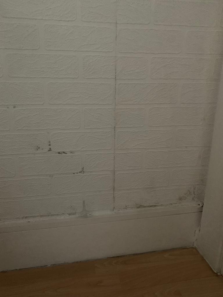

Hi everyone, does anyone have a checklist when trying to work out where mould / damp is coming from? This concerns the inside of an external wall with cavity construction.

this is a rental property. the mould is in the stairwell, so there is no room to put clothes there. But yes, this can be a problem where the property is "sealed" with double glazing and is heated with a gas boiler.
Watched skillbulder on youtube that covered subject?
thanks, I watched the video on coating the walls. I was hoping that coating the walls (possibly roughcasting) would be a last resort. Not sure about a price but I'm sure it would run into the £0,000's. I'm tempted to start with getting the gutters and downpipes flushed out. This can be done quite easily and not too much £'s

why not post pics of the problem showing the interior, and the exterior elevation & at ground level?
yes, would make sense. I don't live at the property and I was trying to have a sniff around to see what order I should do things in. I was going to go, gutters and downpipes, ventilation vent in front door, air brick and if all that fails then consider doing something to the outside wall. Are there any steps that I have missed out? Can I try anything else?
Is the floor solid?
this is damp at the top of a stairway.
Do you have CWI?
this is a first floor, 4 in a block flat. cavity walls, yes; cavity walls insulation no. I've been told that the cavity wall insulation is not suitable in this type of property. Not an expert, but I was told that cavity wall insulation could bridge the gap between outside and internal wall.
Is the outside rendered?
no, but a lot of these buildings have been roughcast. can't imagine much change from £5,000 for roughcasting.
Any previous damp work?
no, no previous damp work.
Structural damp is always evident, and the cause very near to the stain.
Likewise for leaking pipes.
In the absence of structural damp or leaks, black mould is always from excess humidity created by the occupants. Always.
Without seeing pics its difficult to suggest where the mould/damp signs are coming from?
Damp can penetrate from outside even with cavity walls.
I wasn't suggesting rendering, in fact, I would avoid rendering if possible.
photos from the stair area
The moisture from drying clothes and cooking, can spread from other rooms, to condense on cooler surfaces. Especially, the steam from cooking, can rise up stairs, to find a cool surface to condense out upon.
