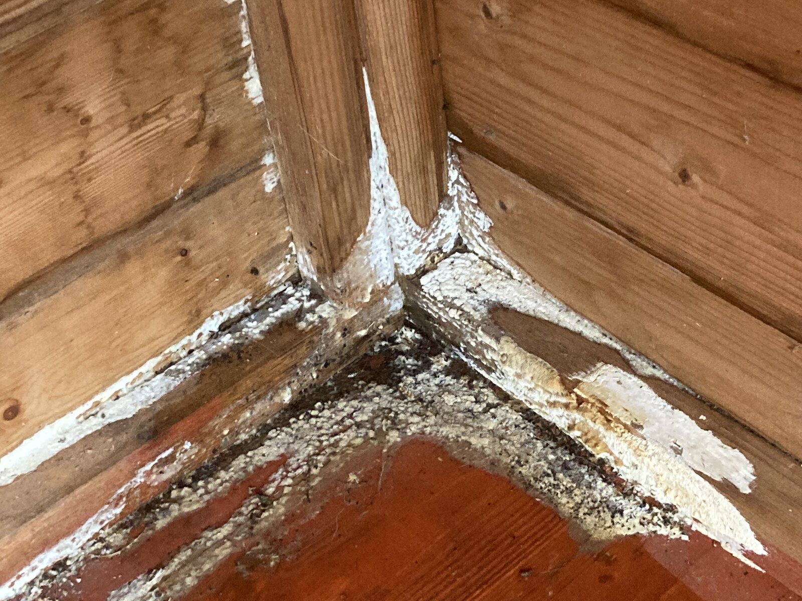

Found this in Shed Corner. I assume it's Mould. If so ho do I get rid of it?
you find the leak, and mend it.
Once you have done that, you may have to cut out and replace the rotten wood, depending how severe it is.
Some photos of the outside, including the gutter, downpipe, potentially leaking roof, and cladding, may be informative.
I can see the problem, Leaves have gathered all around the Bottom of the Shed and are conducting water into the base. I usually keep an eye on that sort of thing. Once I have cleared everything & it dries out can that mould be treated?
