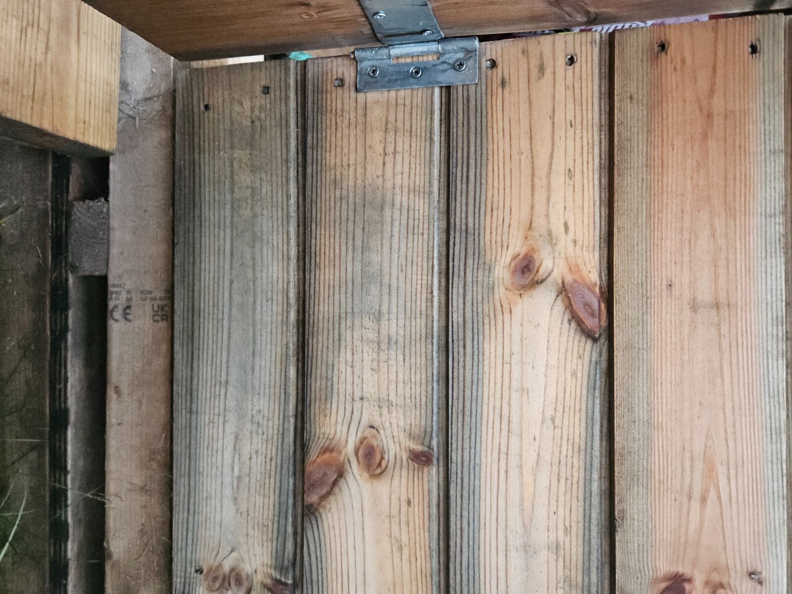

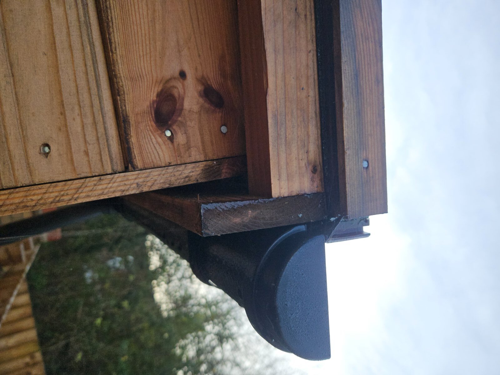

Hi, last year I got a shed delivered & put together by a local company. My dad helped me put guttering up along the facia board so that it collected rain into a water butt.

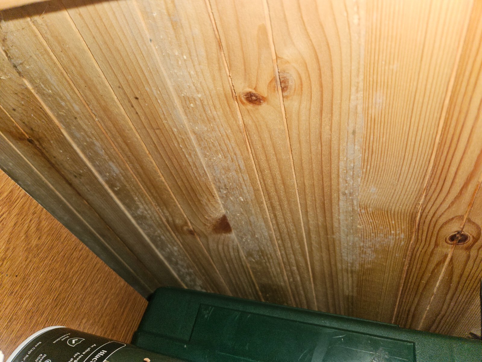

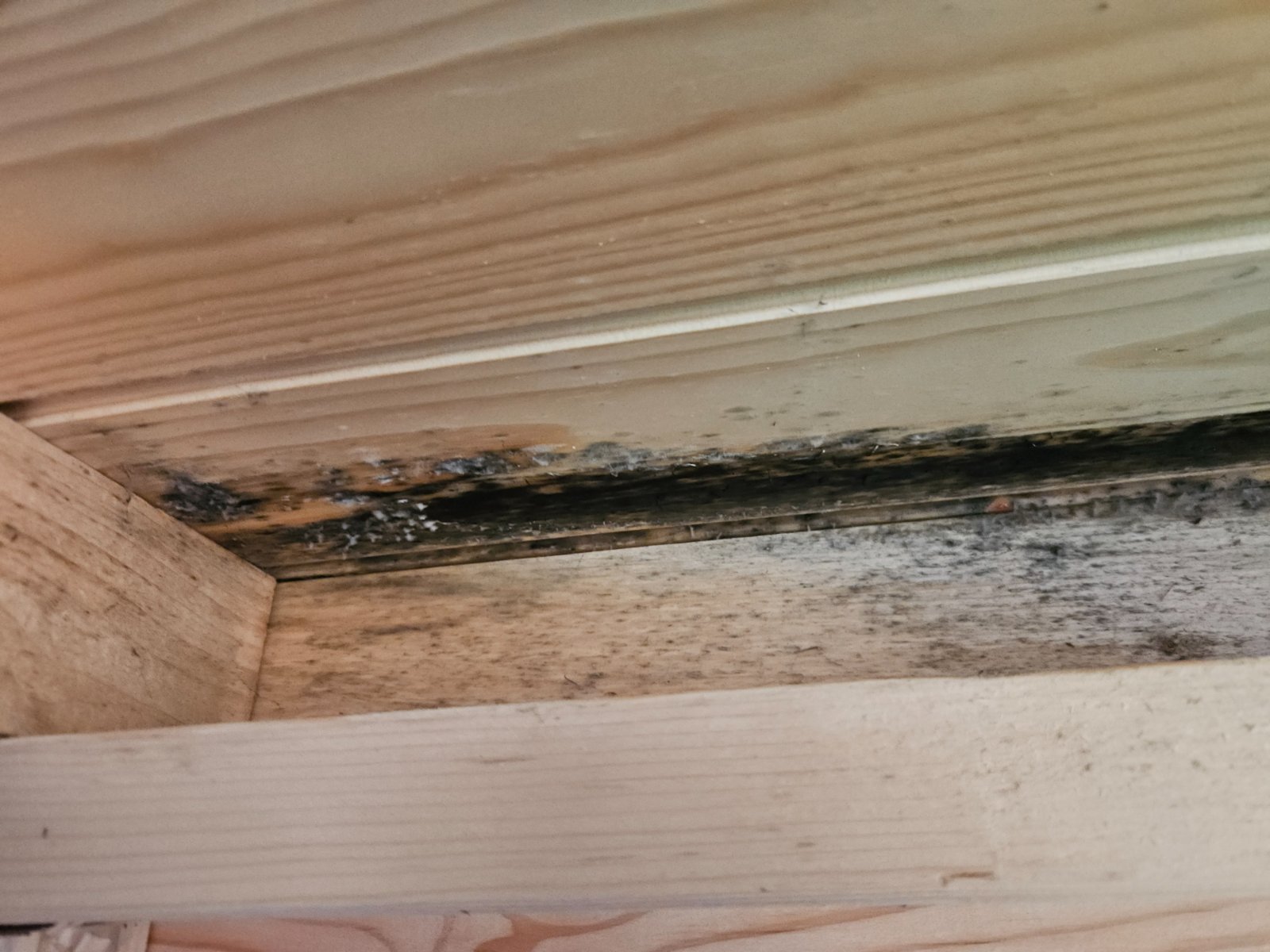

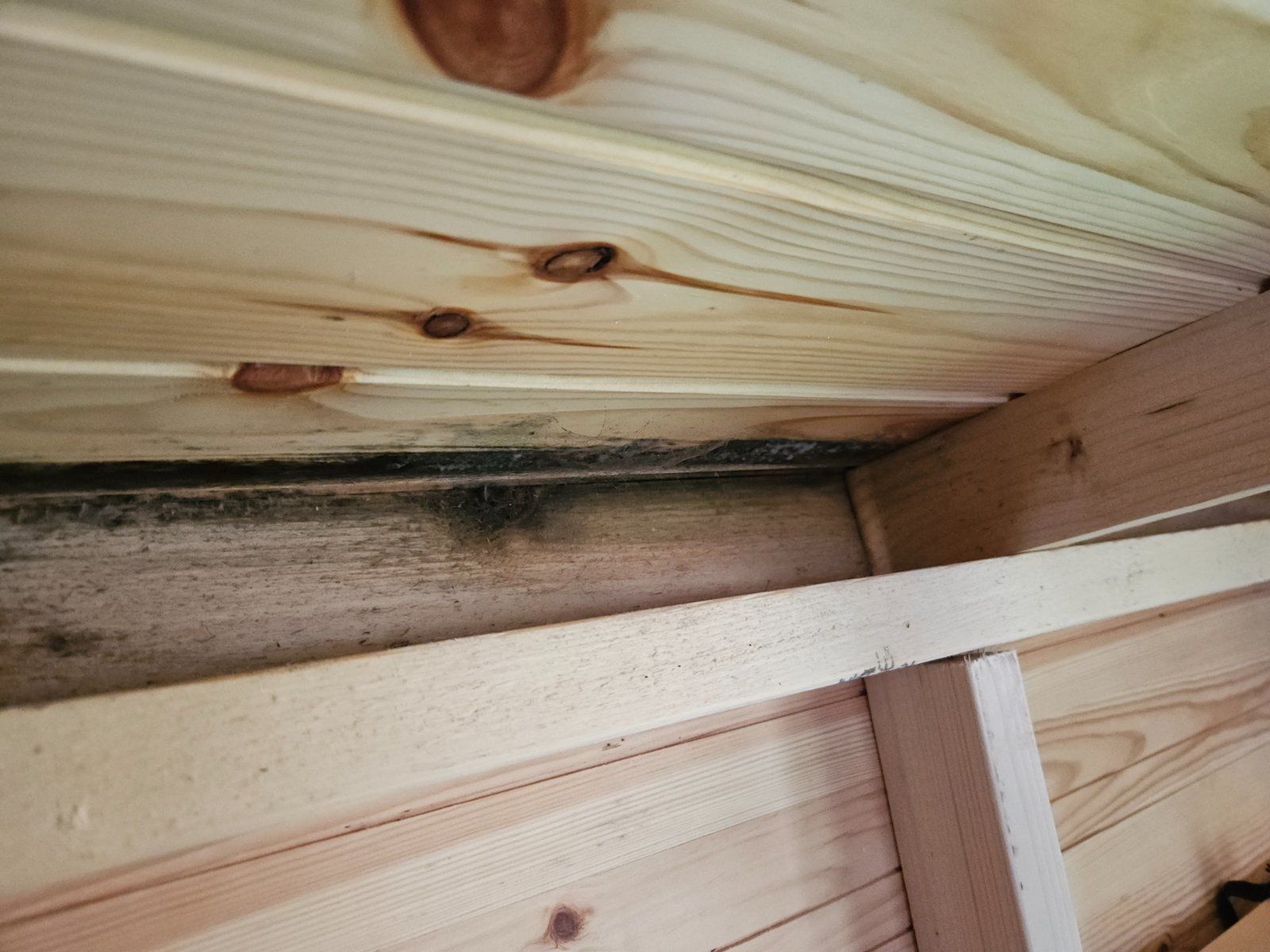

Skip forward to last month when I noticed a big patch of black mould on the top of the shed, near the air gap that is built into the design of the shed. (See attached pics)

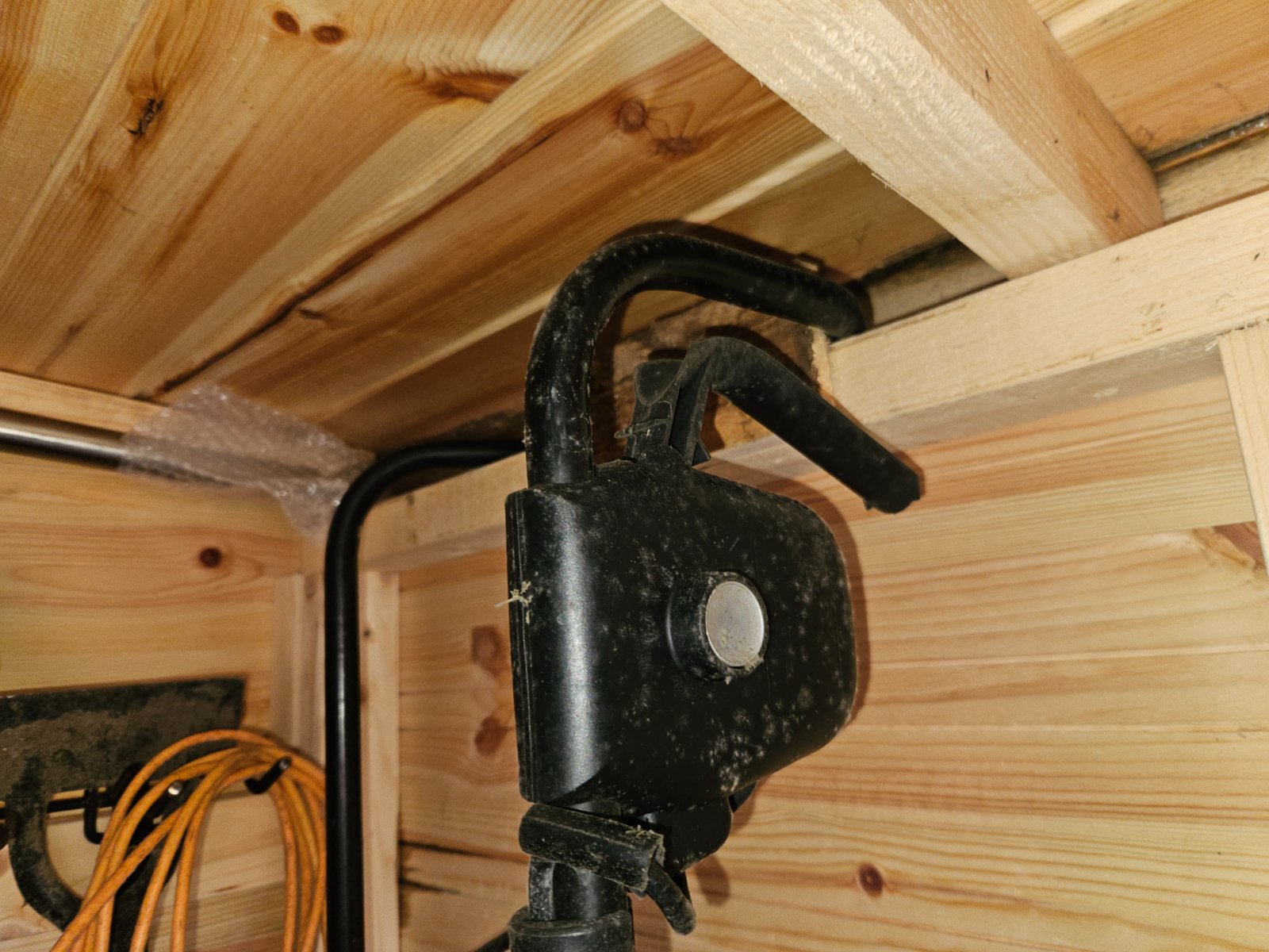

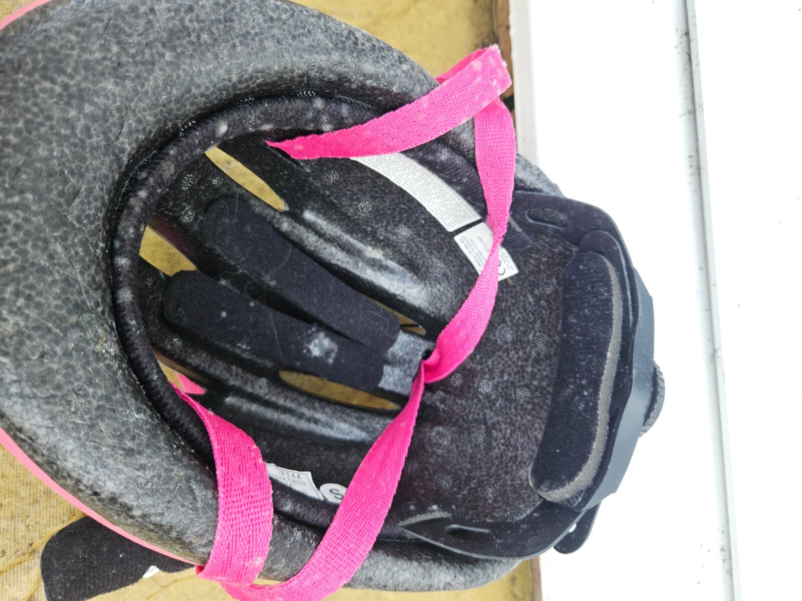

Then over the weeks and days I have been noticing more and more of my belongings in the shed having mould on them. I've had to throw some kids toys away, my tools are covered in mould, basically anything that is porous is covered in fluffy green mould, even mine and my kids' bike handles & seats.
I go in and out of the shed regularly for tools & bikes and air it out when we get a nice warm/sunny day so I can't understand at all why it is getting SO much moisture inside it!
The company have been quite good in that the boss rang me last week and said he would send his men round to replace the black mould covered boards and felt if needed as it looks like it might be a leak. He also said they would weatherproof the outside again.
However today the guys turned up and almost immediately one of the workmen started blaming the black mould on the positioning of my guttering which is:
brackets fixed to fascia board and gutter sits right under the edge of the roof (which is felted) with an extra little bit of felt underneath that felt.
However, the guys, and the boss have all said that the gutter should be sitting under the timber fascia board, so the rain runs off the roof, down the fascia and into the gutter.
What do you guys think?
I might try and add some drawings to show what I mean if this doesn't get much traction because I'm talking a load of gobbledegook
The last image is the outside of the shed as I am convinced the weatherproofing treatment they used has ran off with the rain (they apparently use Creosolve - any opinions?)
Why no photos of the gutter?
Sorry, yes I did mean to. Here is one. This is the only one I have before it has been taken down by the workmen today. But apparently it should sit underneath that long, downward piece of wood instead?

Guttering is doing nothing , roof looks short , it should overhang the facia so gutter can sit under the roof edge which should be roughly centre of the gutters.
can you show an actual picture off the felt end compared to the gutter
my thoughts dpm tucked behind the felt to extend into the gutter
I can't unfortunately now, they took it down before I even had a chance to get up there and look at it properly. But basically there was a piece of roofing felt (added by my dad) tucked and pinned under the edge of the original roof felt to allow for rain to run down it's own felt, onto the new piece & into the gutter (I guess which, yes acted like a piece of dpm behind the felt to give the extra length to get the rainwater to drop into the gutter instead of down the side of the shed. Essentially, as @foxhole says - the roof is quite short so no overhang to put the gutter underneath
other thoughts
is there any staining under the roof planks further up the roof slope
my thoughts may be water getting under the felt further up and mostly finishing up at the bottom and because the roof is so shallow it just tracks back into the wall
My own rules for fitting gutters are.....
Gutter as close as possible to the drip edge of the roof, gutter 1/3 to 1/2 of its width, back from the drip edge, but preferably 1/3. The 1/3 helps with the collection of heavy rain, where water would be speeding down the roof, and might spill beyond the gutter. If the roof is shallow, like on a hut - ensure there is some sort of definite drip edge.
If the gutter brackets don't naturally allow the between 1/3 to 1/2, because the fascia is too far back, then fit blocks to space either the fascia out, or just the brackets.
