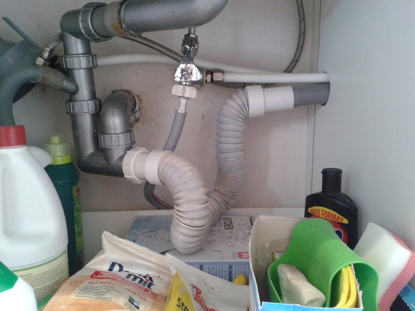

A couple of years ago I had a hand basin installed in my WC which shares a wall with my kitchen. The man who installed the basin drilled through the wall to attach the drain pipe to the piping under my kitchen sink (pictured - the grey tube on the right comes directly from the hand basin, attaching to the accordion pipe). It works ok, but fairly regularly the accordion pipe gets thoroughly mouldy and smelly, at which point I either clean it out or replace it. But this shouldn't be happening. I'm a plumbing rookie but want to replace this myself as it seems like it should be straightforward. But do I need have a trap? Is there a better way to connect it? It's seems amateurish and obviously it's poorly done if it keep moulding up. If I need a professional to do the job, I could go that route too. Advice/input appreciated!
Bill
