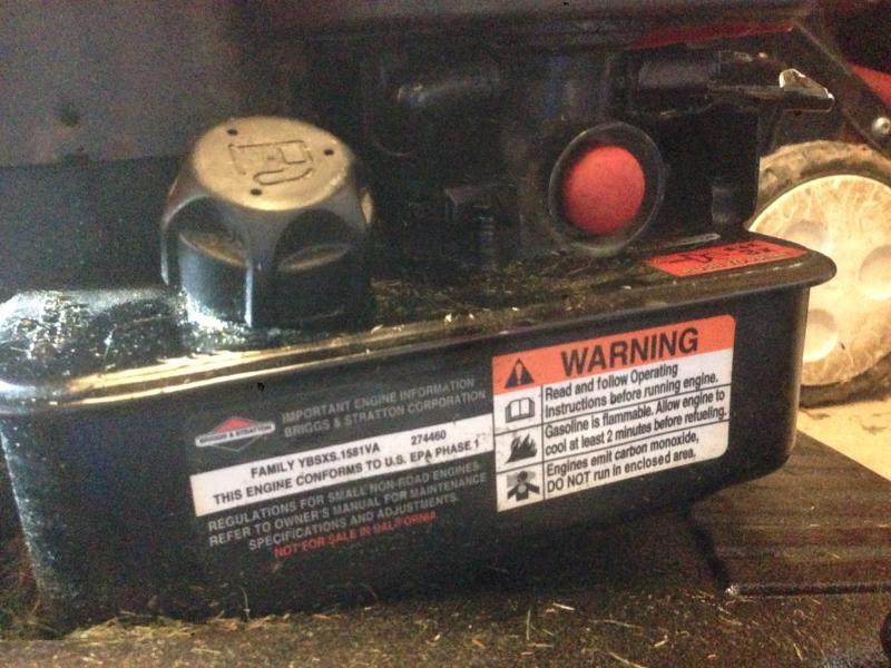

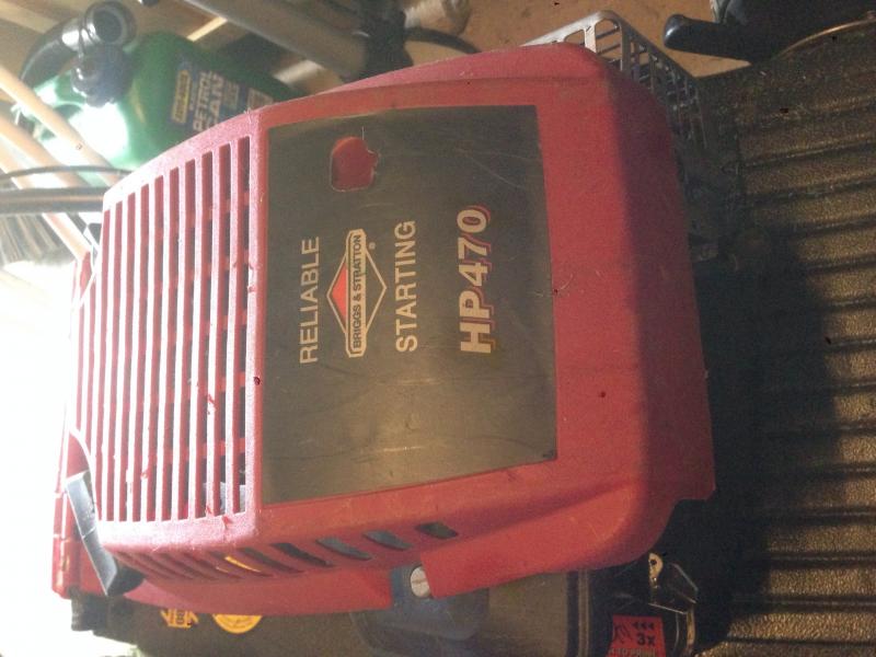

Can you post a pic of your engine please.....carburettor side?
John :)
Ok, and thanks for the pics!
That machine has a foam filter....give it a wash and it should be very lightly oiled, to catch dust.
You see the primer bulb on the carb? There is a gasket and diaphragm just below - where the carb screws onto the tank (5 screws). I strongly suggest you replace these, as they deteriorate very quickly.
When you release the carb, check out the pipes that dip into the fuel.....there's a filter on the end which blocks.
This diaphragm thing is actually a pump that pumps petrol up into the carb.....just note it's position when you renew it!
