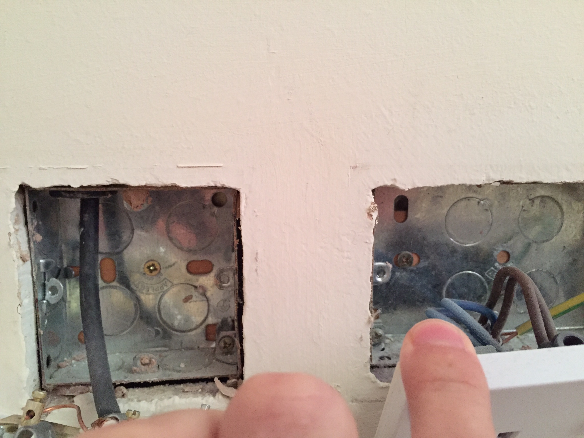

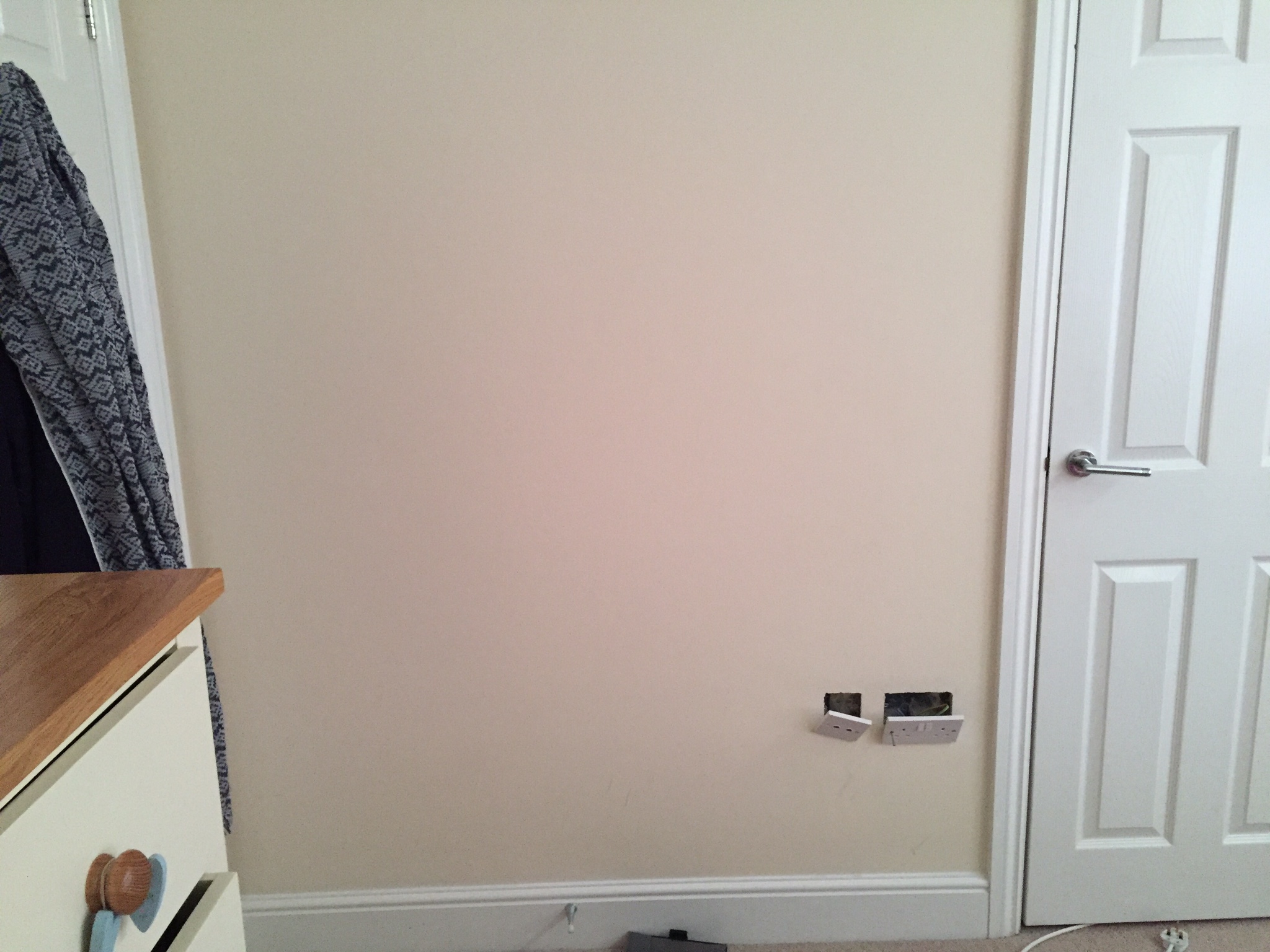

In the bedroom, there are two tv areal sockets close to where the door opens and closes. It is quite clear it has been designed to have a tv put on the wall rather than on a piece of furniture.
I have tried to find the stud partitions, but I am not having much luck. I removed the face plates for the TV areal and power sockets and from what I can see, there seems to be a block of wood running horizontally to the floor. Is this right? I thought they were always vertical?
Can anyone give me some advice on how I can find the wooden partitions so I can drill into them and get a tv mount up and in place on this wall?

There might not be any. Is it an external wall, those back boxes look like they're screwed into something? The plasterboard might be dot and dabbed onto the block work, or it could be built using thin metal support rails instead of wood supports, many new houses are built this way.
Use a small drill (1mm )& drill a series of holes until you find the batten, the small holes, will be hidden behind tv, when you move & fill the large holes fill the small ones. Simple job.

Behind the wall is the stair case going down, so it is an internal one. The back boxes appear to be screwed into a horizontal block of wood.

Sounds sensible. How far apart should I space the small drill holes?
If you don't have a stud detector, you can use a strong magnet to find where the studs are, even if they are wooden, because the magnet will find the screws that hold the plasterboard to the stud.
Or, if you unscrew the metal box (the aerial one) from the horizontal nogging and pull it out through the hole, you should be able to poke something thin (eg plastic ruler) through the gap between the plasterboard and the nogging to the left until it hits the vertical stud, which will tell you how far away it is. You should also be able to listen to it hitting the stud to determine if it is a wooden or steel stud.

Horizontal timber is just to fix the sockets in place, nothing to do with wall construction, what type of bracket are you fitting?

About every 40mm, that's what I did to find a batten, but I did it before I decorated the room.
If you can unscrew the backbox and pull that out you can get a long bendy stick like object and shove that along until you find a vertical, at least you will know where 1 is then :)

Bear in mind you might not have much timber supports, your house might be built with jumbo stud instead, like this...
http://www.buildingmaterials.co.uk/146mm-jumbo-stud.html
My new build house approx 14 years old is built with this stuff.
It would not surprise me. The quality of the house is not that amazing. If it is jumbo stud, would this cause a problem? Might I be better using something like spring toggles?
