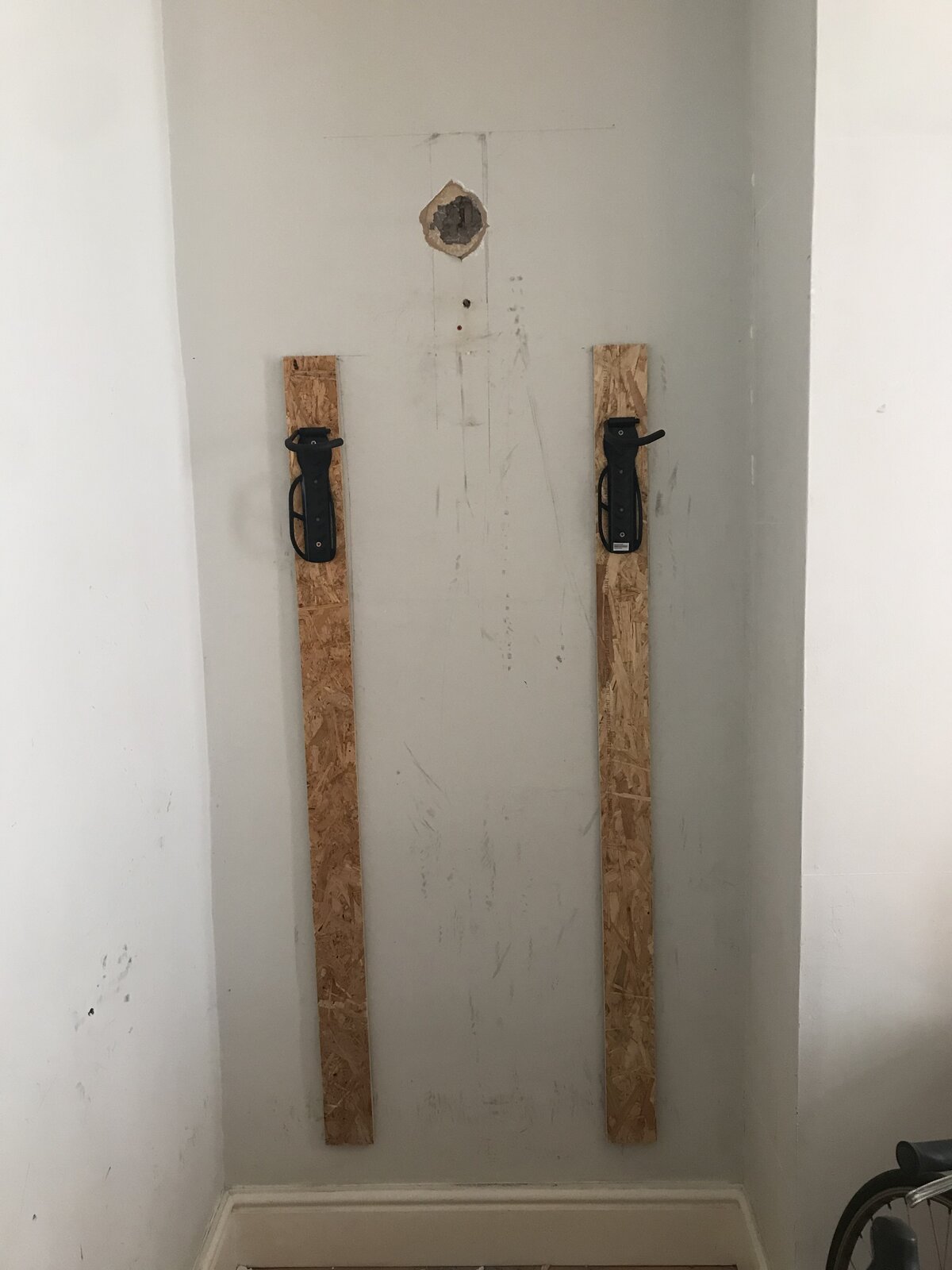

Hey,
Relatively new DIYer here and this is my first post, any advice for this problem gratefully received!
I'm mounting OSB strips and hooks onto the party wall in the alcove of my Victorian terraced house. The idea is to hang bikes up from their front wheels.
The walls are 9 inch oooold crumbly brick with 2cm of old crumbly plaster over the top.
There should be three hangers side by side with the middle one about 20cm higher than the outer two - staggered so the bike handlebars don't tangle together.

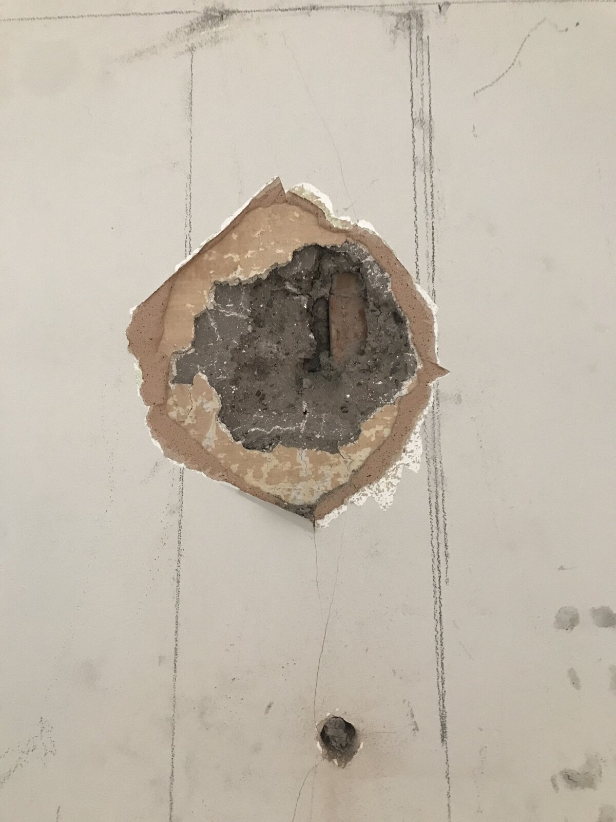

I'm attaching pictures of what happened to the middle one - when I hung bikes from all three the middle one failed and pulled out of the wall taking a big load of plaster with it.
I've now realised (I think) that this is because the screw was nowhere near deep enough in the wall:
The screws I used were 60mm long, and I used red rawl plugs.
The plaster itself is 20mm thick.
The OSB+hook is 25mm thick.
So my screw was only 15mm into the brick, whereas I think for such a heavy item it should be at least 40mm into the brick (so the screws need to be at least 20+25+40mm long = 85mm)
I think the one that's failed was actually in the mortar not the brick, but reckon it's a matter of time before the others fail too.
You can just drill the existing plugs out when you drill a deeper hole for the new fixings. If a masonry drill won't take them out, use a normal drill bit just to clear the plastic plugs out of the hole.
I notice you didn't state the screw size (other than length), but red plugs (5.5mm holes) suggest 4.0 or 4.5mm. I'd go brown plugs, 7mm holes, 6.0 x 100 or 6.0 x 120 screws. Double plug the holes if necessary. No need for frame fixings

For the benefit of the OP. Double plugging means drilling a hole deep enough to accept two lengths of plug (collarless).
There is little to be gained from drilling really deep holes and using long screws if the plug is substantially shorter. If you only use one plug and try to bury it deep in to the brickwork, when you tighten the screw, it may just end up pulling the plug in to the plaster zone (and up to the reverse side of the OSB).

A point about frame fixings - AFAIK they were originally introduced to fix PVCu window frames in place. This is because a metal screw put straight into a PVCu frame could damage the PVCu, whereas the sheath (plug) which goes right up to the head means there is no metal to PVCu contact. In addition, though, because they are designed to hold a window in place, they are primarily designed to resist sideways pressure (of, say, wind on the window) and so may not offer good straight pull-out resistance. Lastly, they require a 10mm hole, which is getting a bit big for many DIY drills and bits, but well within the capabilities of an SDS drill
The 7mm hole with brown plugs and 6mm screws is a proven method for securing materials to walls, concrete, etc with known pull-out properties. It is cheap and readily available (our local ironmonger sells plugs by the dozen and screws individually). I don't believe in spending excessive money when it simply isn't necessary (typical tightwad joiner). Whilst I suggested 6mm screws, I did so to maximise the strength of the fastenings to well above what is required to hold the weight of a bicycle, and in fact 5.0mm screws of the same length would do the job and require only a PZD#2 screwdriver (6.0 screws need a PZD#3) although with 5mm screws I'd suggest is that a penny washer (aka repair washer, mudguard washer) might be added beneath each screw head. Hardwood plywood would be a better choice than OSB for strength and durability
The double plugging thing is to deal with ropey masonry. Yes, OP, you are right to place your holes in the middle of a brick or block, but sometimes even then you don't get the best of grips, so removing the screw, pushing in a second plug, then rescrewing can be necessary. This is most often required on old Victorian buildings, etc with ropey bricks or stone, but it can happen that you need to resort to this on modern blockwork, too
