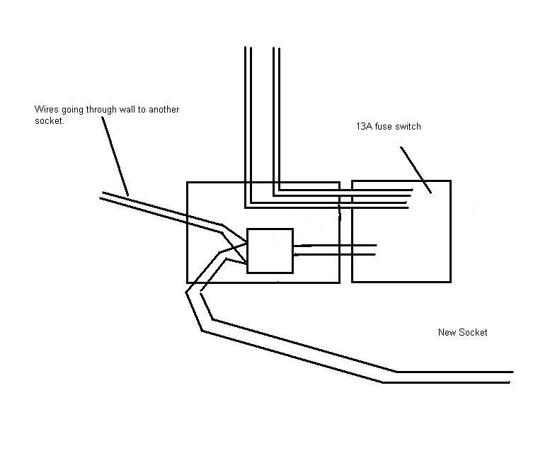

I need to move a socket about 5 foot from its current location.
I have chiseled out to run a cable down and behind the skirting board. My question is joining the cables. I intend to use a 30amp porcelain block, leave this in the old socket housing and put a blanking plate on.
I have also noticed that I have 3 of each wire already twisted together, it’s a double socket with 2 sets of wires and I think it must bridge off through the wall to another socket in another room making a third set of wires.
Is this approach OK? What about that many wires into the one block?
You cannot run cables behind the skirting unless they are in earthed steel conduit or buried >50mm deep. Take a look at this:
http://www.diynot.com/wiki/electrics:installation_techniques:walls
Even if you run the cables in a safe zone, if they are not in conduit or >50mm deep they will required RCD protection; if the ring final is already RCD protected that is taken care of.
From your description, there already appears to be a spur connected to this socket, so you cannot simply run a single cable from the existing position to the new position as that would mean you have two spurs from a single point on the ring.
You need to extend both legs of the ring to the new position. You can retain the connection to the spur behind the blanking plate. To do this you will need to identify which of the three cables is the spur.
Probably better to buy to modern plastic connector blocks, rather than use porcelain! Don't forget you will need G/Y sleeving for the CPCs.

I can see which one goes off through the wall but what about the other 2 sets of cables?? Surely they are both just live cables. Could I connect one set onto the spur and then the remaining set to spur off to the new soocket?
Are you saying porcelin blocks are a bad idea?
You may as well use a fused connection unit to serve the other socket rather than a choc block, at least the cable will be protected by a 13amp fuse then (though you still need to listen to Davelx advice regarding mechanical protection) .
What does the spur currently serve? Is it a socket you use as if it isn't I tend to remove this.
Don't forget a grommet on the back box
No - the current carrying capacity of the cables in the ring a less than the rating of the protected device,; this is acceptable because there are two current paths to each socket on the ring and it it assumed that the loads will be distributed evenly around the ring.
A single one- or two-gang socket spur may be connected to each point on the ring - you are suggesting connecting two sockets to one point which the regultations to not permit, as this would violate the distributed load assumption to much.
Also DO NOT BREAK THE RING. If you do this then the cables in the ring are not sufficiently protected against overload and there is a risk of fire.

Attached is proposed (which I get the ipression is wrong)

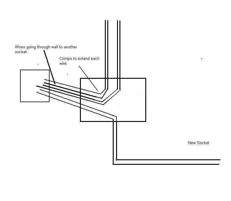

From what I am getting proposed2 would that be right?
(ignore the dodgey drawings and the fact is not horizontal/vertical lines).
If the spur is just on the other side of the wall, I would extend the ring to the existing spur socket. The correct way to extend the cable would be by crimping. This will solve the issue of second spur on the same socket. All the advice given before is correct and I would add my advice to follow it.

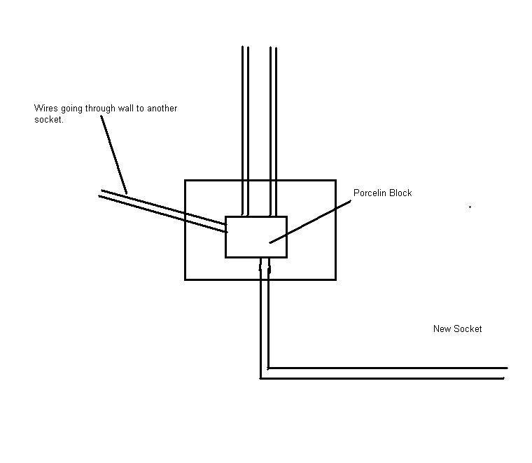

If I understand you correctly shoud it look something like proposal3 ??

No, that's an unfused spur with two sockets - not allowed. Have another look at the diagram in the post above. Proposal 2 complies with the regs but limits your total load on those two sockets to 13A.
You need a proper ratchet tool to use crimps safely and you can't put more than one wire in each end anyway. Nothing wrong with 30A terminal blocks (plastic) so long as they are accesible for inspections and tests (ie behind blanking plate).

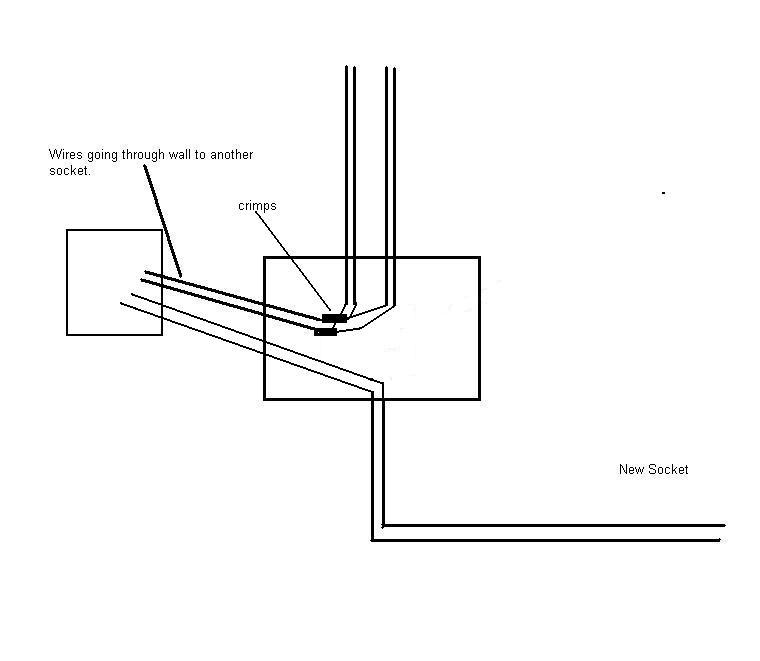

It kind of looks right (in the diagram they have two sockets, one in the ring the other spurred off).....
is the point at which I connect the ring main together, should the cables extend and meet at the socket on the opposite wall before spurring off back through the wall to the new socket??
see attached (that was a rubbish explanation).
I have looked at these crimps and can not find much on ratings, the best I found is use the Blue ones are they correct?
Thanks everyone for the advice, bit long winded got there in the end.
