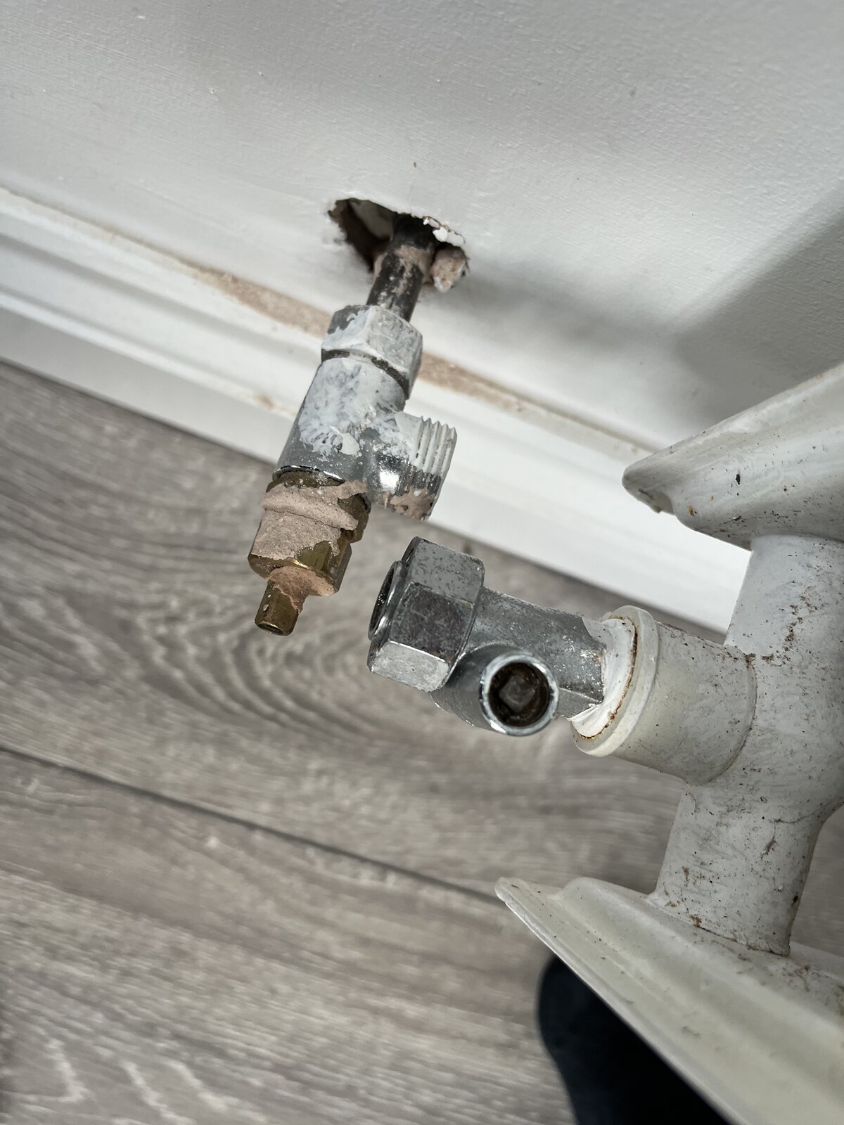

Hi all, We’ve been doing work on our conservatory , the radiator was originally up against the brick but we’ve put plasterboard there now the radiator is a bit too far away from the copper pipe, can anyone recommend what to do?
If you have access to the pipe on the otherside of the wall remove a section and then remake it longer to reach the new position
Plumber could fit a straight connector to the existing pipe and then refit the fitting. Just depends on the room available.
