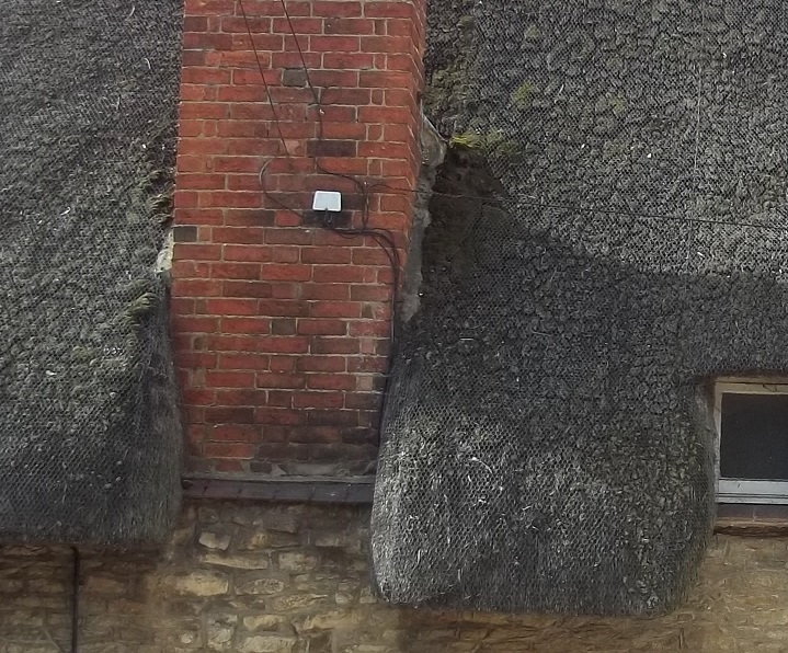

My (un-used ) chimney stack with 6 circuits in two 4pair drops. ( mine and 5 circuits for adjacent businesses ) ( before the re-thatching )
When another business circuit was needed it was found that both the spare pairs were open circuit. Hence another drop was needed but it could not, under new rules, be flown from the stack.
A 12 pair underground cable was installed in a new wayleave across my yard and the aerial drop wires removed. The business was charged for a new line. The cost of changing from over head to underground was large but not charged to me or the business as OpenReach would have had to remove the over heads some time in the ( distant ) future even if a new circuit was not needed.
