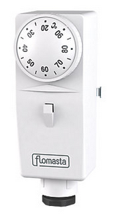

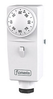

I live in a three story house, and like you found the boiler system a complete mess, to get a thermostat on the tank to control the boiler using a hard wired methods was simply not going to happen, it would be a major job to remove ceiling to route wires, and even worse trying to raise floor.
I remembered my dad having same problem and using a motorised valve to control his DHW in turn controlled by a wireless thermostat, but they no longer seem to be marketed. What there was seemed very expensive, so I was left looking for a cheap alternative method, also no thermostat for central heating, and I found the triple and earth to the boiler from the programmer changed colour enroute and had one core open circuit, so seemed prudent to convert to extra low voltage, and I went for Nest Gen 3, in hind sight not a good selection, but it does with two ELV wires allow me to control central heating and domestic hot water, and power the wall thermostat.

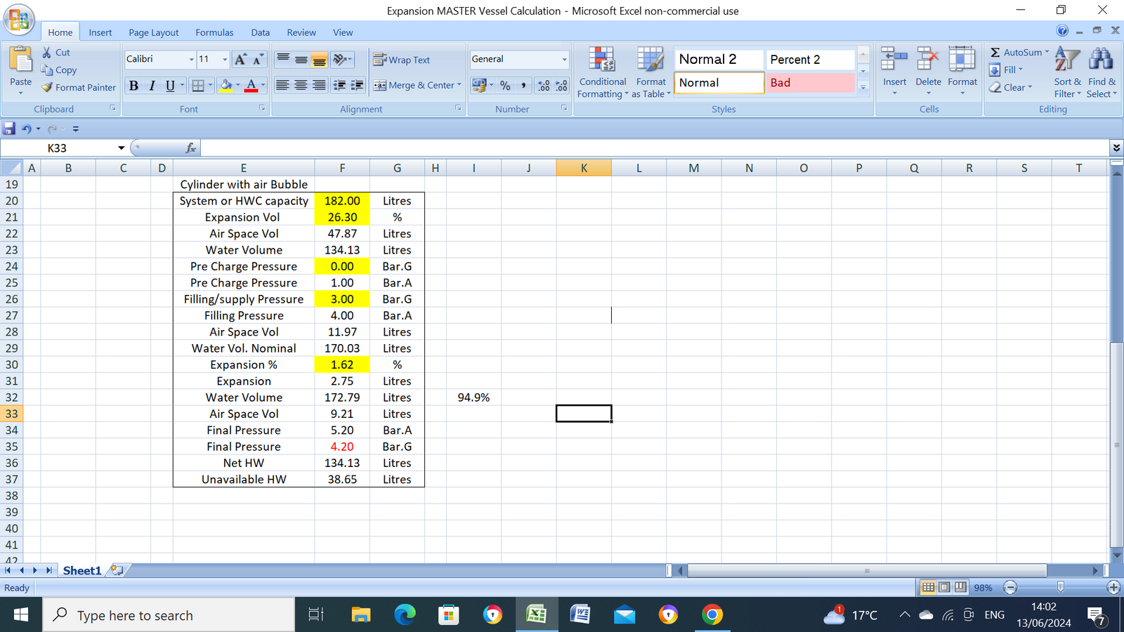

I just cannot see how any HW cylinder with a internal expansion bubble can deliver what it states is its nominal capacity, as HW.
From the megaflow brochure, it says the "170SB" has empty weight of 48kgs and a full weigt of 230 which = 182L, it also states that its nominal capacity is 170L which, because of where the T&P RV is located and presumably the bottom of the dip tube (dimensionally, 26.3% from the top) is also correct by my calcs once the cylinder is pressurized to 3.0 bar (cold). At the end of the heating cycle there will be 173L of HW in the cylinder but only 134L of this, due to the position of the dip tube is available, the 39L of HW above the bottom of the Dip Tube is IMO unavailable. If so, then you effectively have "only" a 134L HW cylinder.

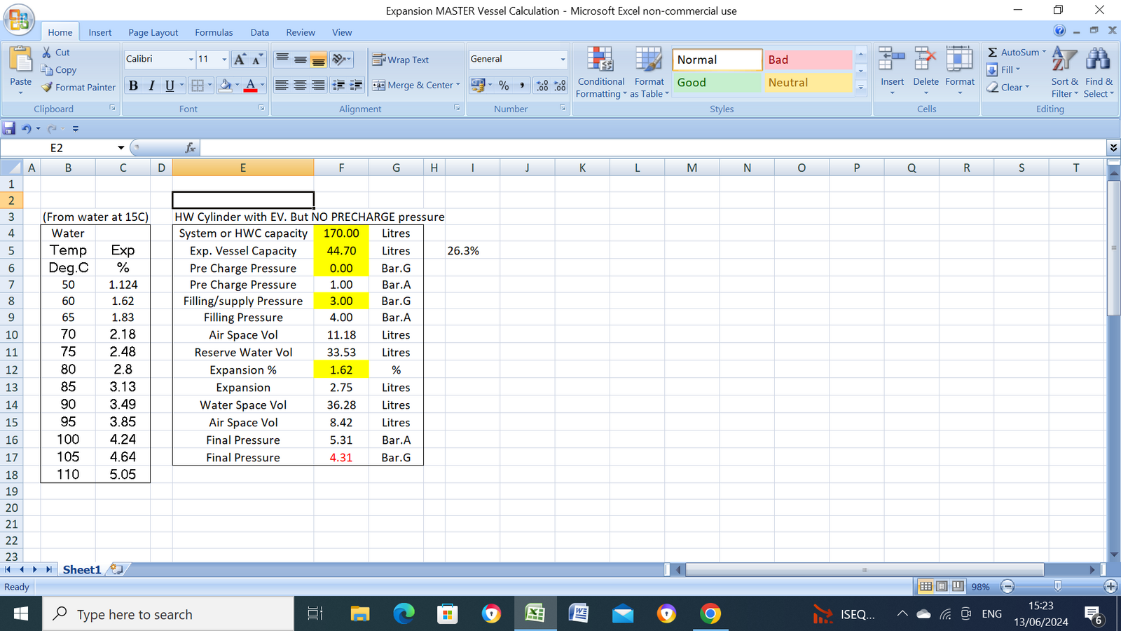

For anyone interested, a snapshot of my calcs.
My OSO air bubble unvented cylinder range states that one can remove the draw-off dipstick and gain circa 20 % capacity of HW... 170litre -> 200 litre from the installation manual. It requires an external EV to do that of course!
Recheck your calcs? as without a cutaway dimensioned drawing of the cylinder I think you have likely made an error? Remembering that an air bubble weighs next to nothing, no matter how large.
The air bubble, above, only occupies 9.2L, less than 5% of the total volume, the reason for the huge expansion vol required before refilling (26%) is that, for obvious reasons, one cannot pre charge a Megaflo to 3.0bar, in the example below, of a conventional HW cylinder with a EV but no precharge then, that EV would have to be practically the same % vol (26%) of the cylinder to keep the final pressure to 4.2bar. With a precharge of 3.0bar, 10% is all thats required. I've been doing these calcs for years on EV sizing so would be pretty confident that the air bubble calcs are also correct.
