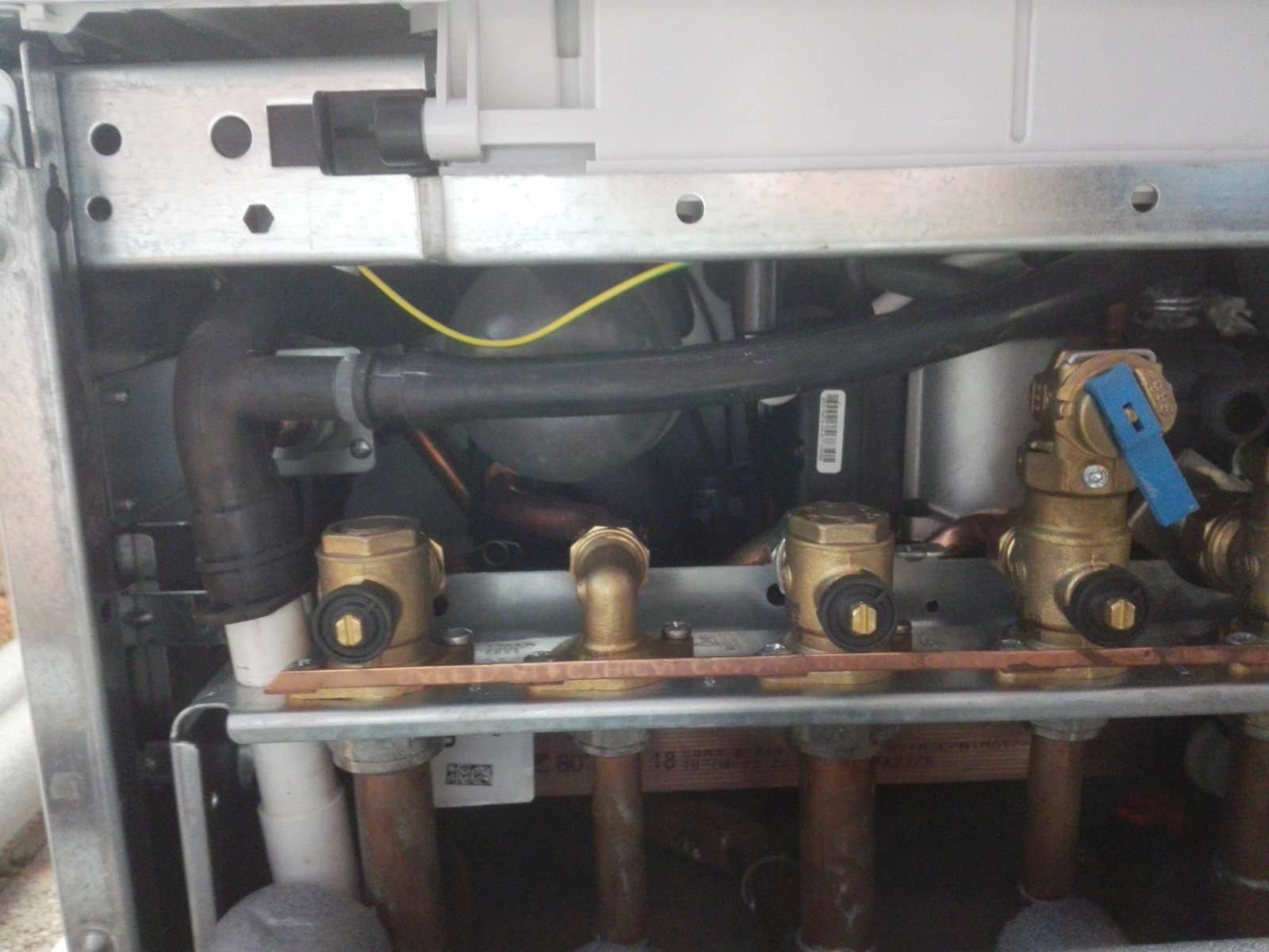

Here is the underside of my boiler, with the plastic tray removed:
Push fit connectors properly installed are miles better than a compression fitting. You're thinking based on hunches and assumptions, that somehow metal is better than plastic. A push fit connection once properly installed will _not leak_ and will probably outlive you. Those compression fittings could be weeping within a year.
