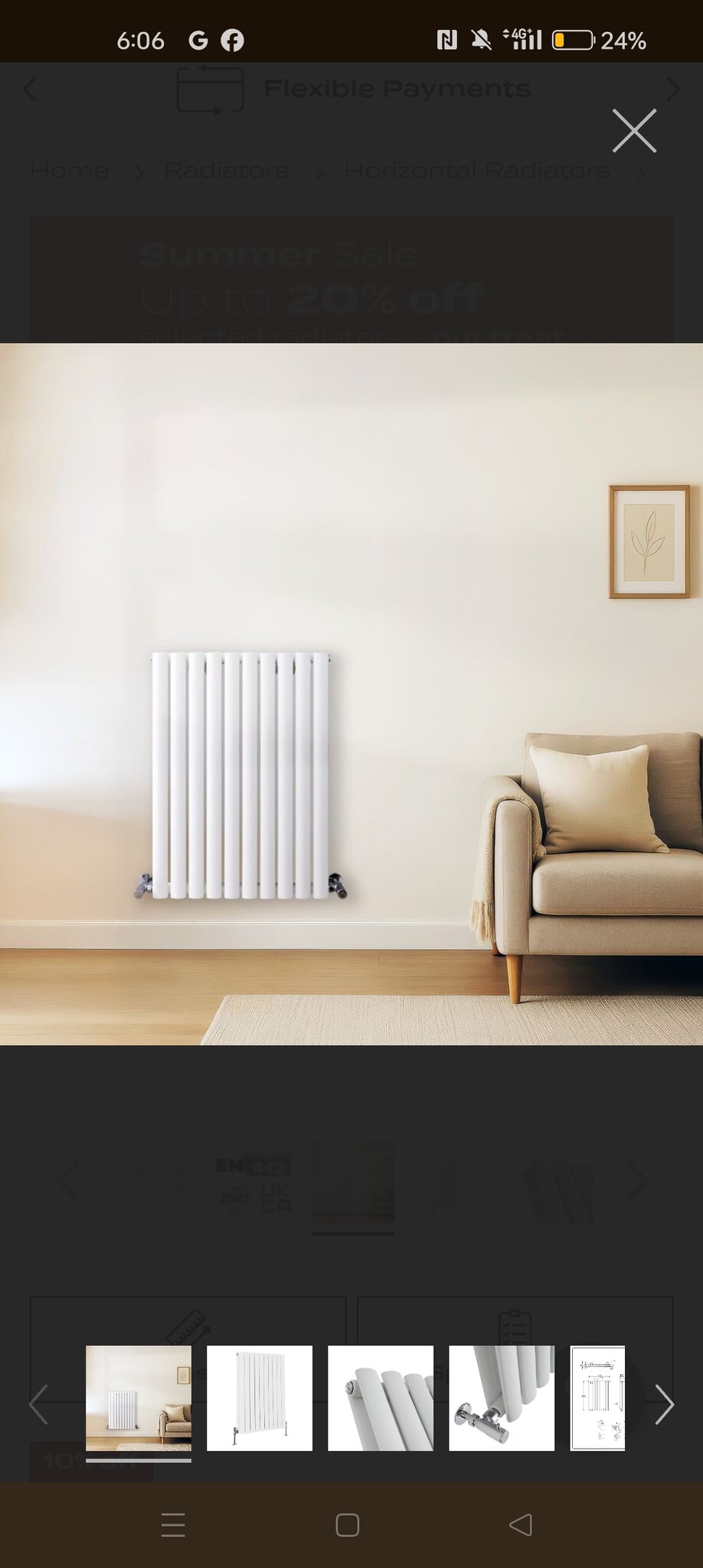

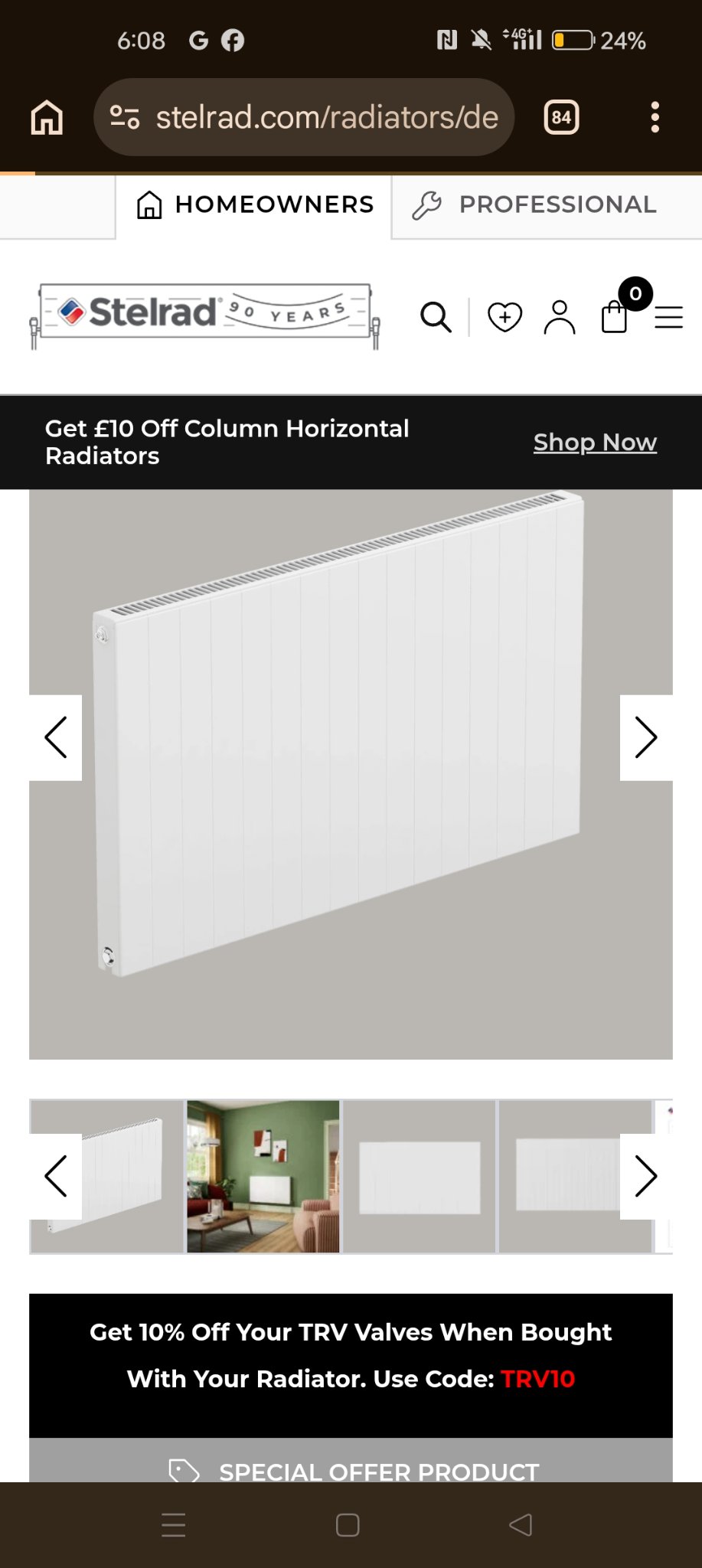

@denso13 Thanks. It would fit better with the room to move it. Currently theres a single panel 100x45cm radiator but we have a sofa bed in front of it so it's blocking wire a bit of the heat. Was thinking of getting a 60x60cm K2 to the side so there's nothing in front of it
@denso13 also another question. Do you think convection radiator are much better than column radiators?
I was looking at the stelgrad compact vertical line k2 one that is 60x60cm that has a btu of 3200.

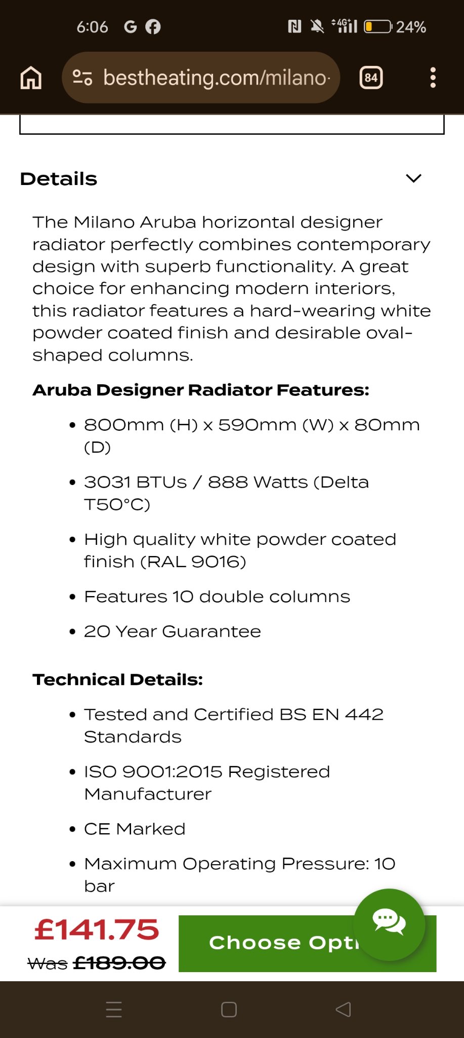

But also saw the Milano Aruba column radiator in 80cm height x 60cm wide which is more expensive but looks better.

What you have linked to isn't a column radiator (rad) I'm afraid - it what is called a tubular designer rad. They look great but can struggle to heat any room of a reasonable size efficiently, it's all down to how they work. They are not convecting rads, more radiant.
With radiators, experience has shown that convecting radiators (Type 11/21/22/33) are by far the most efficient way to heat a space, true column type rads come in 2nd, with designer tubular rads coming in last, when comparing like to like outputs, in anything but the smallest of spaces.

I agree. I had a larger version of the Milano tubular radiator in my main bedroom and, although its BTU rating was adequate, it failed to provide decent heat. I've now replaced it with a Type 22 convecting radiator of similar overall dimensions and this is much better at heating the room.
