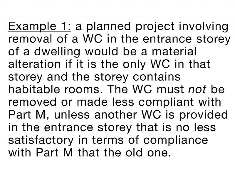

Planning Permission is irrelevant unless you're house is listed. Building regulations will require you to retain a downstairs toilet.
Which part of the building regulations is that requirement found in? It can't be Part M, since that's not applicable to an existing dwelling.
That is a quote from the Approved Document, which is clearly in contradiction with what the actual legislation says. If you're claiming Part M as being the only reason, then the argument for not removing a downstairs W.C. because it's against the building regs. is clearly as incorrect as the similar argument applied to socket & switch heights, as here:

An interesting one, since many people take the approved documents to "be" the building regs. If you could show from the actual regs that something did not apply in some sort of appeal (with legal persons interpreting the rules), they would have to back down.
That would be the section for Part M in Schedule 1 of The Building Regulations which states quite clearly:
The requirements of this part do not apply to -
(a) an extension of or a material alteration of a dwelling
http://www.legislation.gov.uk/uksi/2010/2214/made
Regulation 3 defines what "material alteration" means for the purposes of the building regulations, as quoted above.
The example from the Approved Document above even starts by acknowledging that the proposed change constitutes a material alteration. For some bizarre reason, it then completely ignores the fact that the regulations say that as far as Part M is concerned, "the requirements of this part do not apply to {....} a material alteration of a dwelling."
In fact it's even more bizarre, because if you read section 0.4 on page 11, it does acknowledge that:
Under the General Limitations on Application of Part M, the requirements of that part do not apply to an extension of or a material alteration of a dwelling. This means that the extension or alteration work itself need not comply with Part M.
But it then completely contradicts itself by continuing:
However, a planned alteration to a dwelling that has the potential to reduce the compliance of the dwelling as a whole with Part M must be carried out in such a way that there is no reduction in the extent of Part M compliance.
Clearly, that is not what the Building Regulations actually say at all.

IMHO it's pretty clear to the people that do this work, day in day out Paul, that for the purposes of BRegs compliance the provision of the existing GF WC must remain.
It's pretty crystal clear to be honest. Where's mikric :cool: ?
I would say that "The requirements of this part do not apply to {....} a material alteration of a dwelling" is pretty much crystal clear.
Maybe we need BAS to highlight that in big red block capitals......
