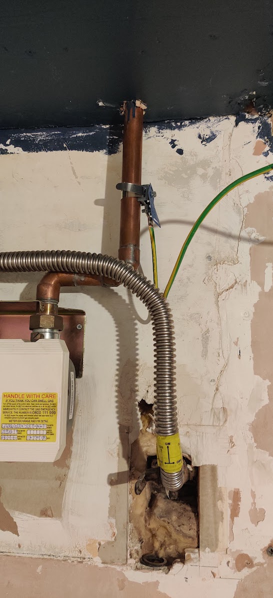

The previous owners had a rewire done last year and the electrician has installed a new earth bonding cable from the consumer unit to the gas meter in the room below.
However, they've put it in some ugly plastic trunking across the roof which the owners then roughly threw paint at. We're completely redecorating the room so would like to run the cable in the wall instead.
I've done some searching and can't find too much about moving them - I'm wondering:
  • Can the cable be extended, or does it have to be one unbroken cable into the consumer unit (which would be notifiable?)
  • Does the cable need to run through the zones set out for mains cables?
Any thoughts appreciated, TIA!
Incidentally, you are actually allowed to use other parts (except gas pipes) as the bonding conductor, so -
you could have a conductor from the gas point of entry to - for example - a water pipe and then another conductor from a connected water pipe to the main earthing terminal. This may mean the conductor does not have to run where it is unsightly.
You have said the bonding conductor runs to the consumer unit. Is that where the main earthing terminal is or is there a terminal block near the incoming electrical supply?
To where does the earthing conductor run from the incoming supply point? Does it go to the consumer unit?
Thanks, couple of pics attached. It's the cable to the left of the 2nd picture and goes under (but not into) the black block and straight into the CU. Worth me opening to take a look at what it's connected to?
