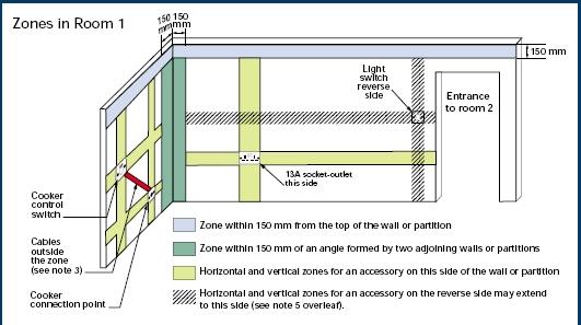

In terms of cable zones, not sure what to do here? Easy enough to stay within a zone running cable along the wall from the old sockets, but given I need to bring the cable forward out of the alcove, what would a zone be here? Can I just run the cable along the floor inside the boxing in, then up underneath the new socket in a zone?

Start with safe zones for wiring

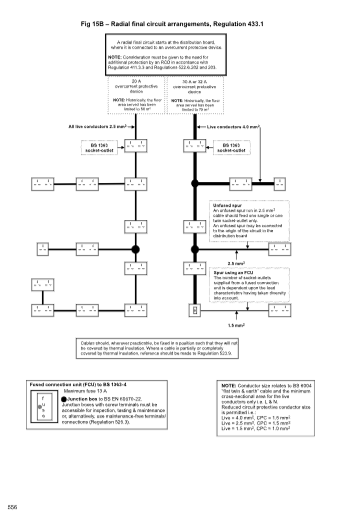

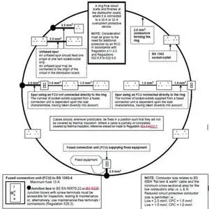

using a blanking plate helps to keep in the safe zones, then need to look how the original is supplied, with have Ring finals, Radials, Unfused spurs, and fused spurs, your need to work out which you have, Ring final.jpgRing and radial circuits.pngthere are a host of rules of how you can extend depending on what you already have, there are also limits to both line - neutral loop impedance (or prospective short circuit current) and the line - earth loop impedance (or prospective short circuit current) often meters auto measure L - N as PSCC and L - E as ELI, there are two reasons to measure, one is a standard B32 MCB has two devices in one, the heat part is 32 amp, but the magnetic part is with a B device 3 - 5 times that figure, so simple ohms law 230/160 = 1.44Ω add 5% for safety, so maximum limit is 1.38Ω.

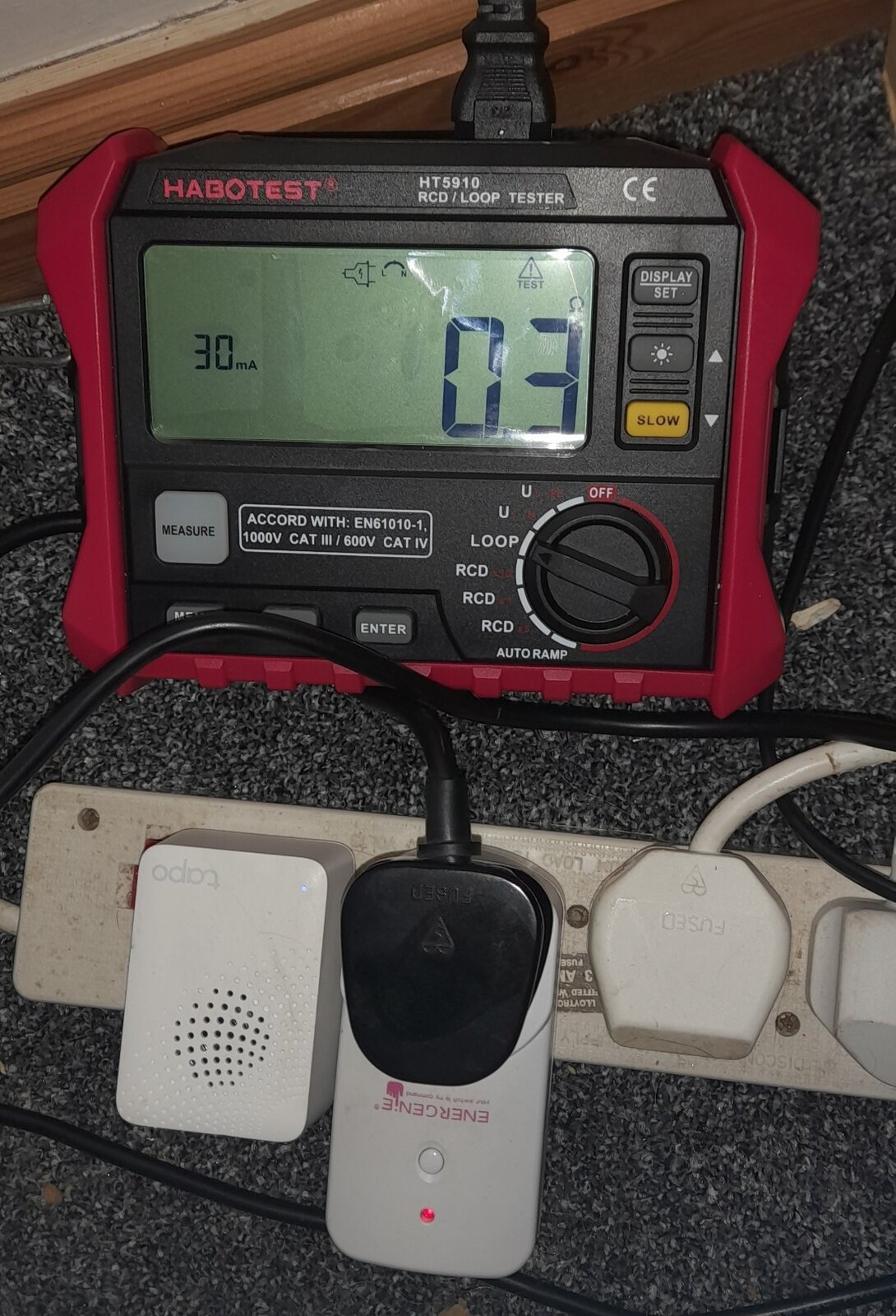

With the L - E and a TT supply, so must have an RCD, the value of the ELI exceeding 200 ohms may not be stable, so that is the limit, the L - N reading is more to do with volt drop, a ring final is limited to around 106 meters of 2.5 mm² with radials and spurs depends on the fuse/MCB size, my tester is a cheap one, only around £75, so only gives 1 decimal place, Loop-test-socket.jpg so 0.4Ω would be a fail, however not for this test as supply is 13 amp fuse, so 3.86Ω is the limit, one can calculate the volt drop from the loop impedance, but since mine only to 1 decimal place, rather inaccurate.

So in real life, the DIY guy starts with the last installation certificate or electrical installation condition report, and we look at how close to the wind the installation was sailing back then, and is there room to increase the loop impedance, in the main easy way is use a FCU where the old socket was, as moving from 1.38Ω to 3.86Ω gives one a lot of extra cable, and also cheaper testers can be used, these

I’ve realised a mistake I made here overnight. If I connected the two cables currently in to the back box with one new one to run to the new socket, I’d be creating a spur. What I actually want to do is just extend the ring by moving the location of the current socket. So what I need to do is connect two lengths of cable, one to each of the cables coming in to the socket. Then I’ll no longer be creating a spur.

So you will have two cables running in the same place. Why do you prefer that?
You could use one run of 4mm² cable if you want more than one socket on the spur.
Ok but what benefit do you think that will provide?
The joints at the present socket location will have to remain accessible or a maintenance-free method used for the connections.

I realise that, it is important to realise DIY moving of a socket is taking a chance.
In the main, the safest way for DIY moving of a socket is to replace the original with a FCU (fused connection unit) and in essence the new socket is a permanent installed extension lead.
If you can see the cable of the trunking the cable is in, then don't need to follow safe zones, and if you use an RCD FCU then you can get around no RCD at the consumer unit.
