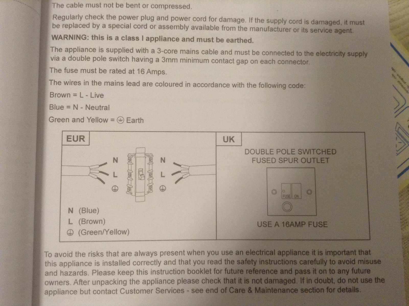

So - the one Winston pictured of the MIs stating an FCU with a 16A fuse are on to a winner then; selling any old crap with impunity. ... There seems to be a huge lack of common sense around.

So what about that 16 a fuse that B&Q want in the FCU for their oven supply.
Best to do it that way then. It will obviously be a different product to the one pictured.
