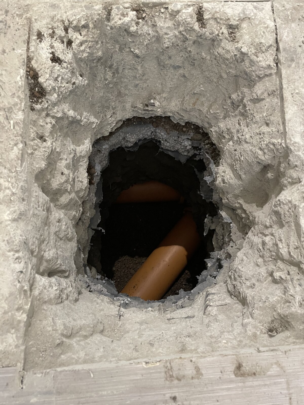

Im moving a toilet and sink into a new room that I’m creating, it’s about 2 metres away in a new build house.
I’ve dug through the concrete for the toilet waste and directly below is the soil pipe that it’s currently connected to.
What would be the best way to tap into the pipe? The pipes not going to have any movement. And to connect the sink, would a strap boss be ok?
I’d like to then plumb a sink into the the original toilet connector, is there a specific joint for this?

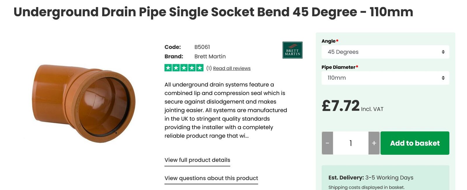

Only way to connect a Pan to that horizontal run is by using a junction. You will need to make the hole bigger and cut a section of pipe out, before using a junction and slip collar to slot it in, unless the upstream section will be redundant after moving the WC, in which case, fit a bend, and then come upwards. Either way you'll need good access to the existing pipe to be able to cut it squarely and chamfer the cut end.
Are you fitting 'sinks' or 'basins', there is a difference and the waste pipe sizes are also different.

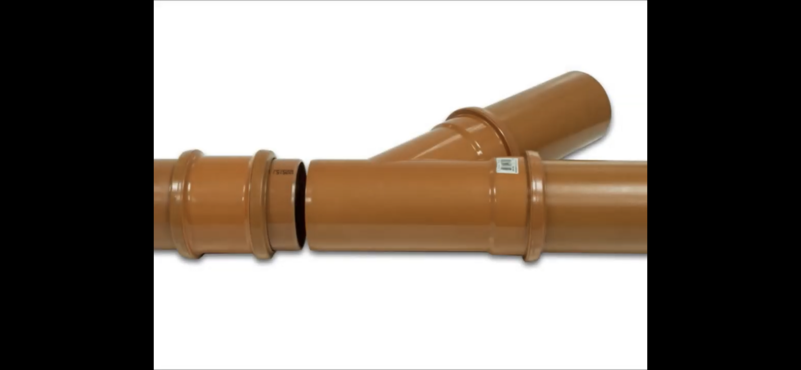

Thanks Hugh, that makes sense. Will the slip collar fit directly to the junction, like in the picture below?

Yes, slip collar can be slid back right onto the pipe, then slid back to make the joint once junction has been inserted into the cut.

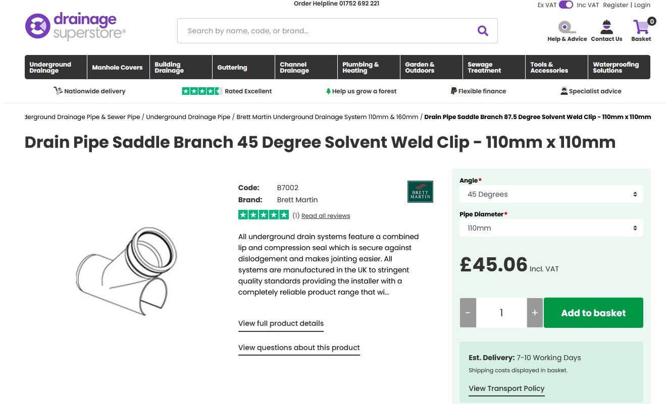

I’ve dug out a channel for the basin to be connected to the drain, can I use a strap boss fitting for this?
