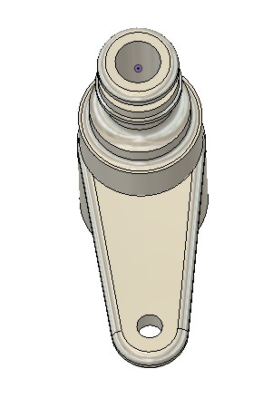

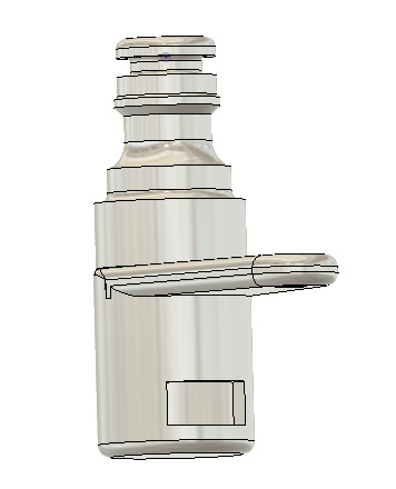

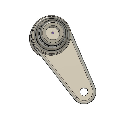

I’m going to 3D print one.
As this mower isn’t fitted with one where in the top of the deck am should it be inserted. It’s my luck that I would drill a hole where the item would have little or no affect.
The usual position is maybe 2” in from the blade tip, so the water splashes to maximum effect.

Hi,
Not the attachment BUT the part it connects to.
Cheapest I’ve seen is £17 so I’ve designed my 3D version.
What do you think ??
