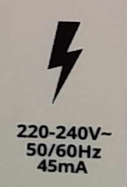

The LED R7s lamp I used for my outside lamp was marked 85 to 250 volt, I have the boxes for two smart GU10 bulbs, one no voltage marking the other 1658571875932.png the box for non smart GU10 also said 220-240 50/60 Hz. Old quartz GU10 240 volt, 50 watt, 350 lumen 2800K Germany Tesco written on the bulb, and the old Pro-Lite GU10 7W FLU 2700K 220-240V ~50/60 Hz 50 mA so all my GU10's are designed for 240 volt. With the energy saving types a range 220 - 240, and the quartz 240 volt.
A lidi E27 Smart bulb was marked 230 volt 50 Hz, but the still boxed B22d bulb tungsten marked 220 - 240 volt. was surprised the pearl bulb 40W 380 lumen, the clear 40W 350 lumen, I had not realised how much worse the GU10 was compared with standard bulb I thought quartz was better not worse to standard bulb.
But two 11 watt CFL one marked 600 lumen the other 700 lumen. Both still new and boxed, really should dump them.
