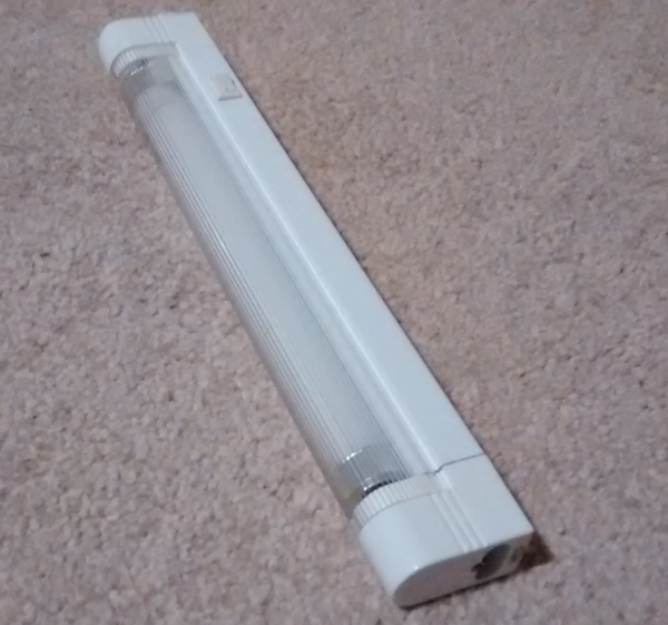

I've got a conundrum and I'm looking for some help.
In my kitchen I have some accent lighting - this consists of 2 x GU10 bulbs in some glass cabinets and 3 of these kind of strip lights under the upper cupboards - all 5 lights are controlled, simple off-on, by a 1-way switch that's part of a 3-gang fitting.
The other day, all my kitchen accent lights stopped working. Everything else in the house works. All sockets, all other lights. I've taken a GU10 bulb out and replaced it with a working one - the kitchen lights don't work. I took the suspect GU10 I'd removed and it works in my bathroom!
So I thought I'd check my Consumer Board... on there they are tied to Downstairs Sockets as opposed to something like Downstairs Lights (this doesn't control these, I remember from some time ago) or Kitchen Lights (this doesn't exist) but Downstairs Sockets is flipped-up and all my sockets are working.
When I briefly looked at the wiring, what I think I am seeing is a wire coming out of a hole in the wall and into a junction box, this splits out into the 2 x GU10s - then, 1 of these strip lights joins onto 1 GU10 and 2 of the strip lights join onto the other GU10 one after the other. So, let me try to diagram this...
Wall - Wire - Junction Box - 1 x GU10 - 1 x Strip Light
|- 1 x GU10 - 1 x Strip Light - 1 x Strip Light
Is there any way that I can, safely, start to figure out where something has gone wrong and fix it? I have a multimeter. :confused:
Is it normal for kitchen accent lights to be tied to the Consumer Board via Sockets? Is there going to be somewhere where I can find a socket that's providing power to these things? It's not in plain sight, that's for sure.
Thanks for reading, would really appreciate some insight from the forum.
I would bet you have a Fuse connection unit hidden somewhere in the kitchen which has a blown 3a fuse, have a hunt …..
Regards,
DS
There ought to be a fused spur or a 13A socket between your Downstairs Sockets circuit and your lights. Kitchen fitters do like to hide wiring and wiring accessories. Photos are always useful.....
If the hole in the wall is at floor level (below/behind a fitted cupboard) or at ceiling level (above a fitted cupboard) and there's a 13A socket above the worktop/below the cupboard then you'll probably find either a 13A socket or an FCU behind the unit below the socket/above the hole in the wall. Good odds the fuse in that will have failed due to (hopefully) old age.

I went searching and I found a switch instead of a fused spur... a switch in the darkest depths of a cupboard that was off. Why was it off I wondered to myself, so I asked, it turns out someone (not me, someone female) had also seen that switch a couple of days ago and had, in their expert opinion, figured that "it wasn't doing anything", so flicked it off!
That is it, in a nutshell.
I suppose I didn't even know about the switch, so something has been learned (by me).

You might want to think about replacing that switch with a switched fused spur at some stage- 'protecting' the skinny wiring on those striplights and GU10 things with a 30A fuse (or 32A MCB) isn't really a good idea.

That rather depends on what circuit the lights are fed from.
What you say is true if they are fed, for example, from a ring final (e.g. 32A circuit). But they may be fed from a lighting circuit or another circuit that has a fuse that IS suitable for the wiring used in the OP's lighting circuit.
The OP has rather implied they are fed from the downstairs sockets, but it sounds like this needs confirming 100% before anything needs doing.
Hi all... I genuinely don't plan on doing anything else now the lights are 'working' again. I wasn't looking for a mini-project or anything, I just wanted to get beyond that little niggle. But, yes, on the Consumer Board "Downstairs Sockets" removes power from these lights, along with the downstairs sockets, of course.
