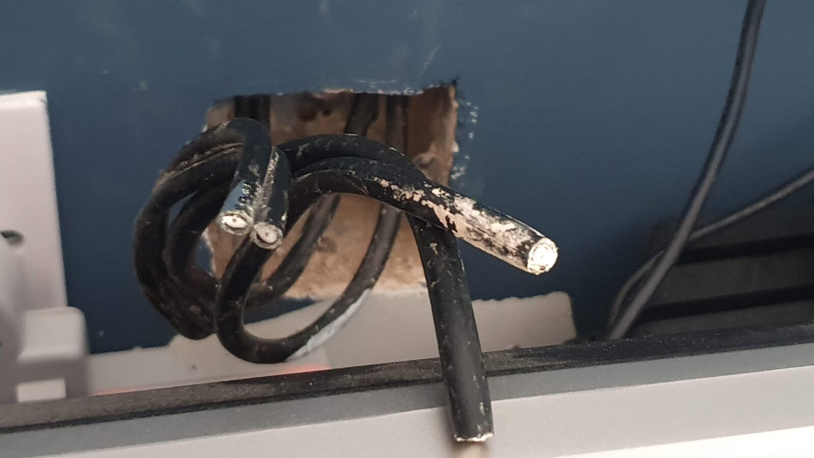

My new house has a socket box slot cut into it, but no faceplate. Instead, there are four black wires coming out of it. Both have a black skin, white 'solid' bit in the middle and then a thin copper wire dead centre. Two are quite thick wires, the other two are quite thin.
Based on that, my guess is that the thin ones are coax and the thick ones are satellite. Does this sound right, and based on that, what faceplate do I need?
I'm guessing something like this: https://www.screwfix.com/p/schneider-electric-lisse-1-gang-quadruplex-multimedia-socket-white/4966j
Is this right, and if so, how do I tell the difference between the radio coax cable and the TV one....or are they basically the same and it doesn't matter which goes into which bit in the back of the faceplate?

BIB - more than likely it's the other way around: The thin ones are probably going to be satellite, and the thicker coax will be for TV aerial.
Sky have been using a thin shotgun (twin) coax for several years. It's a bit more lossy than thicker good-quality coax, but on a typical 7-10 mtr cable run the losses are acceptable so long as everything else about the installation isn't too compromised.
You mention that this is a new house. Does that mean that your builders have installed the cable? This is an important question because it goes to the quality of the cable and where the ends terminate.
Second, if this is a new build, are you sure that there's a TV aerial installed somewhere? Ditto for a satellite dish and FM aerial. The reason for mentioning this is that I've worked on several new builds for customers taking first possession, and I've yet to come across one where the building company bothered to have even a basic TV aerial installed let alone a Sky dish or FM aerial.
On this basis then, I wouldn't spend any money yet on a faceplate until you know what you're dealing with at the other ends of the cables.

Perhaps the below photo will help.
Apologies, I was a bit amateurish in my terminology. By 'new', I meant the house was new to me, not a new build.
The cabling in question is in an existing extension to the house and clearly designed to provide power and signal to a wall-mounted TV. When I was buying the house, the previous owners had a TV mounted on the space. The space in the picture is about 5ft off the ground and there's also power outlets to its side. To my untrained eye, it looks to me like the previous owners had a faceplate here and for reasons best known to them, decided to chop it out and take it with them. You can still see the backing box if you look carefully.

straighten the cables out and take another picture - help us to decide on what the cables are and so help you.
I would fit f connectors to the cable ends so that you can figure out what does what then, if you are intending to put a tv on the wall in the same p!ace using a brush faceplate will hide the cables not required and allow the required ones to emerge. looking at the pic the two cables on the that are "stuck" together are the sat connections and the other two may be the aerial feeds. you are lucky that the previous occupiers left as much cable sticking out as they did

When you were viewing the house, was the TV on and playing either terrestrial TV (Freeview) or satellite TV (Freesat/Sky)? The reason I ask is that without some sort of proof, all you can really say that there was a TV in the room. It may be that the cables have never been connected, and maybe the owners were using some other way to get pictures on the TV such as built-in streaming apps for Catch-Up.
Looking at the picture you posted, there's plenty of cable within the back box, so I wonder if a faceplate was ever fitted. Perhaps the previous owners left it 'as is' and were happy that the TV covered the space? It's all moot anyway. You're dealing with what you want to do rather than worrying about the ins and outs of how the previous owners had things set up.

Have another look at the Sky dish. Sky would normally fit an LNB with 4 outputs for any installation where 2-to-4 live connections were required. However, for larger systems it was possible to upgrade to an LNB with 8 outputs. Count the number of cables coming out of the LNB. If it's six or more, then it's possible to have three sets of dual cables (lounge, MB, conservatory) all connected and live from the LNB. However, if there are just four, and it doesn't look like there's an obvious way of connecting any addition cables, then there's a problem with the maths or there are two other common possibilities. The first is that a diplexing or triplexing aerial distribution system has been fitted, but this means that only one satellite receiver can take single from the multiplexed feed without causing signal clashes.
The other common possibility is that some of the cables are not connected. This is why you need to test the cables. You'll need to work out if they're coming direct of the dish or going via some sort of distribution amp or if there's something else going on.
The simplest option is to put F connectors on the two thin cable ends, then use a back-to-back barrel connector and extension lead to bring the signal to your Sat receiver/TV. Once you've tested both cables you will know if either / neither or both are live.
A small but important practical point about faceplates for wall mounted TVs is they look great when nothing is hanging in front. But when you put your ultra-thin telly on a slimline bracket and then find that the cables attached to the faceplate now foul the back of the TV you'll start to curse.
Unless a customer specifically insists, I always steer them away from a faceplate unless there's a good technical reason to have one. For what you want to do, a brush plate is a better alternative.
These come in a variety of sizes and colours.
The cables will lay flatter behind the TV, so you can achieve that slim-line install look rather than having a wafer thin TV stuck out 2-3" from the wall because of the plugs and cables sticking out at 90 degrees.

Cheers - very good point about outlet faceplates disrupting the bracket space. I've probably got enough room (I've got a PS4 wall-mounted behind the TV!) but a brush plate will probably be neater once I've got some F connectors on them.
