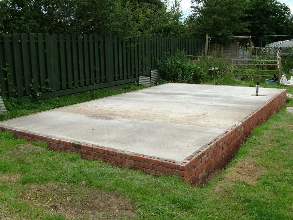

I live in a semi detached house with the consumer unit situated at the front of the house, I have a large garden and have built a workshop about half way down it. I am planning to have the electrics installed by a local company but before I do I want to do a little forward planning if I can and am seeking your advice.
The workshop stands on a concrete base through which I have made provisions for a cable to enter from under ground and when it has been put in I intend to fill the hole with concrete and finnish the floor inside.

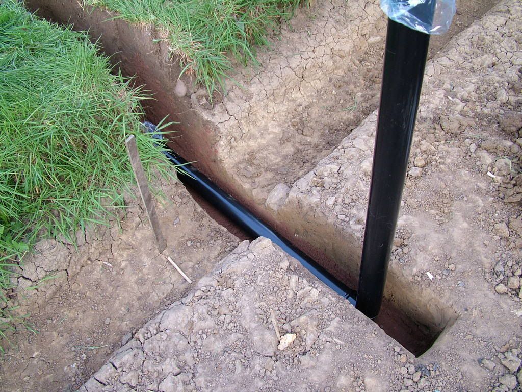

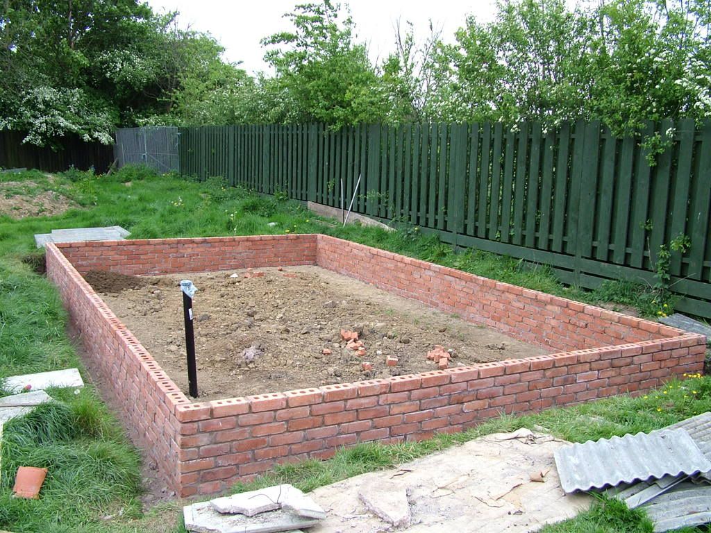

Thanks for all the replies, and I must admit, all have made me think a little harder to the extent that I am now closer to a solution but, and there is always a but, here are some photos to let you know what I am up against.
This is some drainpipe i put in to allow for cable entry
how would you do it?????
i'd use a drill, sds i would put a 10mm hole through at an angle, then my 16/20mm then the 25. Or if the hole needed to be bigger id use a core drill. I don;t really see what the problem is here?
have just had another look. I'm not sure what size cable your using, but if its 35m and you want to run a few buildings i guess its going to be atleast 10mm2, you will have lots of run trying to pull it through that drain pipe. you should have run in some ducting with a smooth curve or even put the drain at a 45' angle.
Yo - my first thought as soon as I saw the first photo was "good luck trying to pull 10mm² SWA round that 90° elbow...." :?
