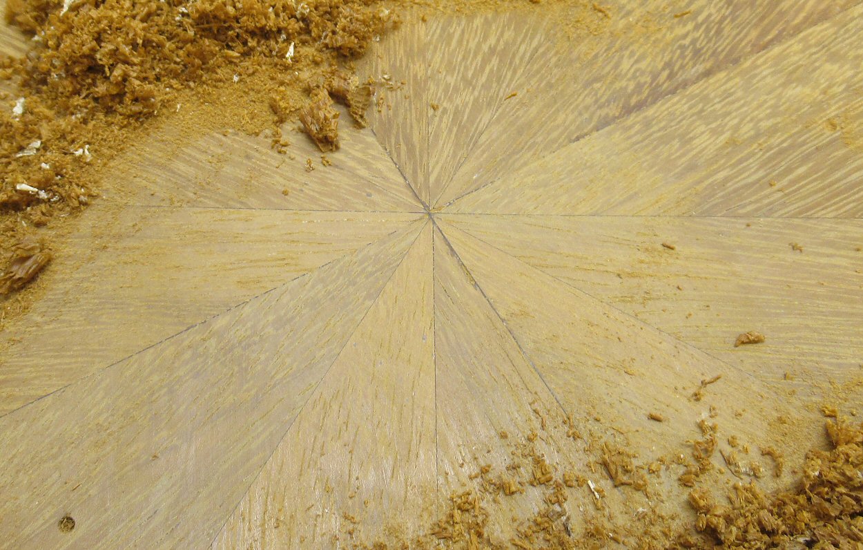

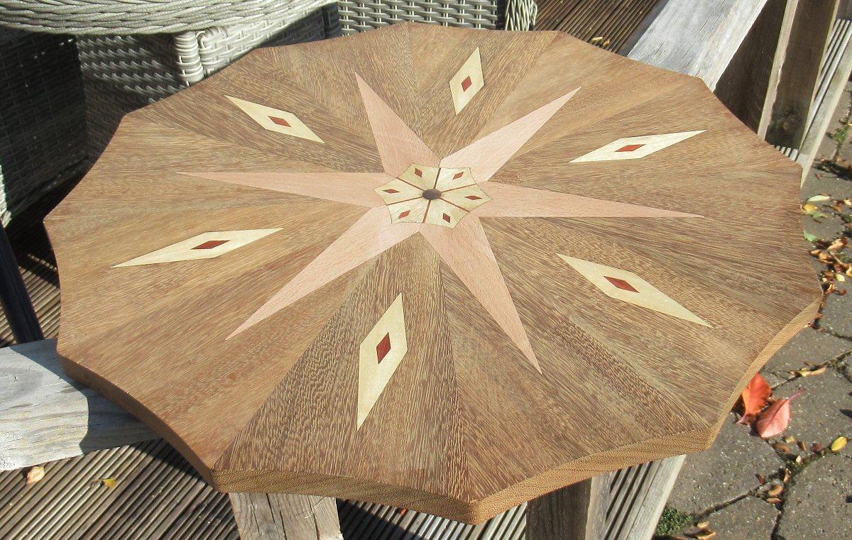

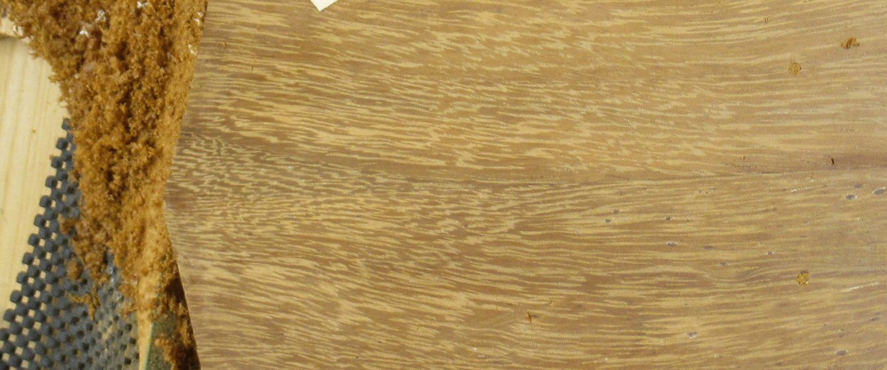

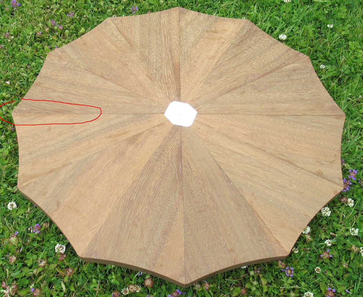

by this are you meaning the grain is not always running directly from the centre ? some of them are a bit offset ?100% not a criticism as it’s brilliant
you have started some correctly as in angle both edges [half triangle cut off to start]
others you have done the full angle for both edges on one edge as in parallel one edge and double the other but as i say comment only meant to clarify why some bits look different to others ---brilliant job![]()

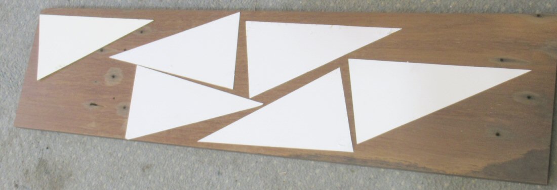

Yes, this was rather annoying and I don't quite know how it will look in the end (disappointingly you spotted it straight away, probably any joiner / craftsman will)

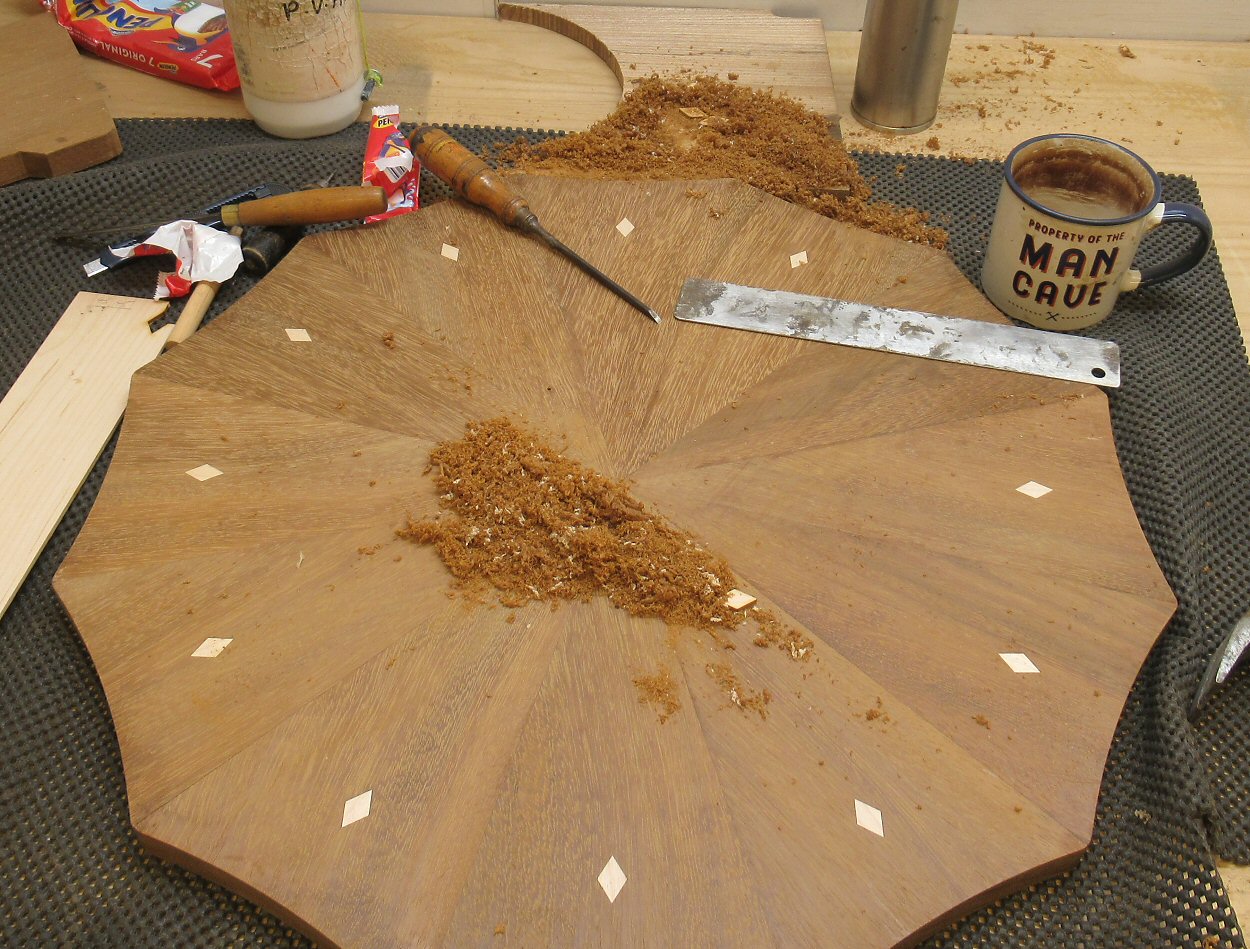

my problem was the wood I was given to use is full of holes so I was having to position the triangles to suit the wood ( i was hoping no one would notice) - I could just manage to get 12 so there was no room for error - have to be so so careful not to make a mistake - just have to do an hour or two at a time with no one around to distract me - the next bit is going to be even more scarey, route out a scalloped edge
this was my layout for planning the triangles
