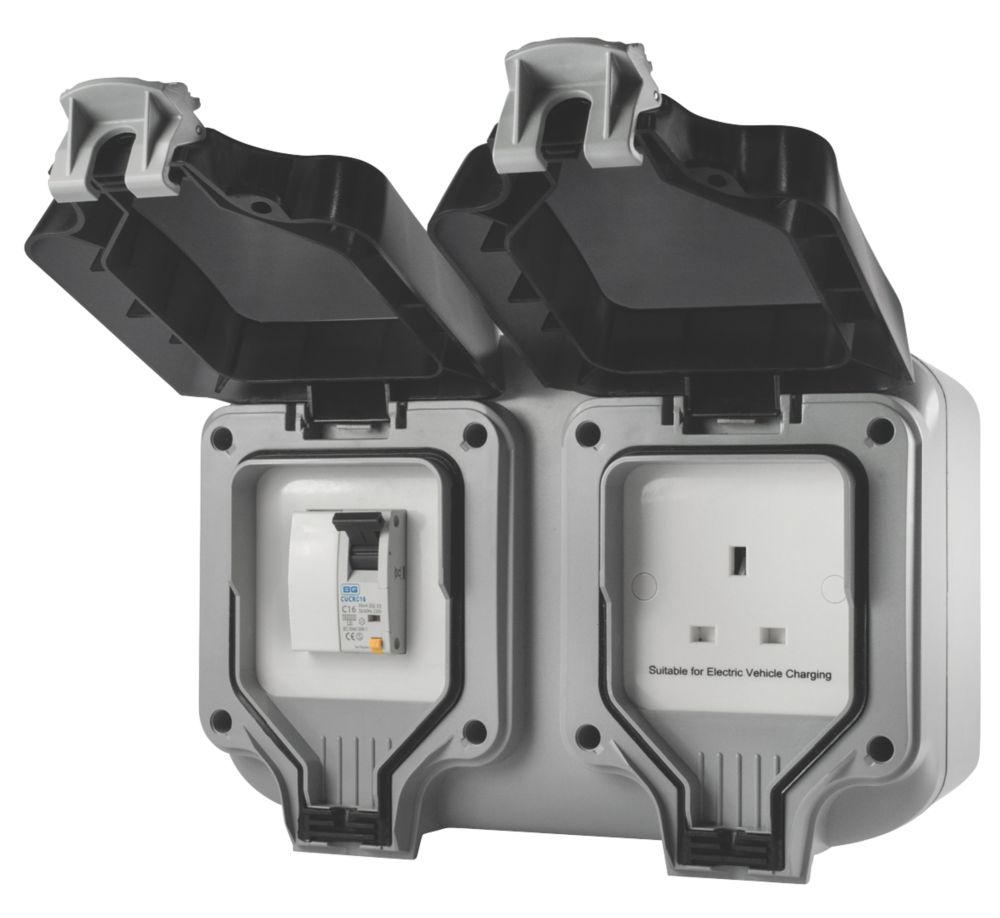

You can get units with socket overload and RCD all combined
ae235
the switch thing on left is called a RCBO, but question one is if the supply already RCD protected? The unit shown it seems is designed to charge EV cars from, although not really a practical solution as instructions say needs a second RCD to supply it, so for car charging a bit useless, but if you don't have a RCD in the consumer unit, that may be an option.

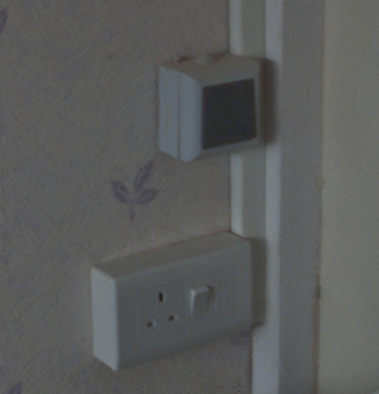

this could have the socket replaced with the LAP grid system so a fuse holder, switch and socket instead of the double socket if already RCD protected. As I did here IMGP7387.jpg for my mother when I wanted a string of sockets from a spur. But single socket

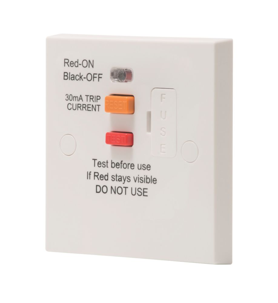

35096_P
is £9.59 and a RCD FCU
ae235
£15.49 and combined unit £49.99 so although more expensive it is a neater job if both RCD and overload protection is required.
